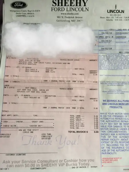

I got my Explorer back this morning with a new hood, paint and Explorer lettering.I droped it off at the dealership Sunday night. They also had to replace the left side seat heater,both front doors weather stripping and they replaced the left side roof rack cover. It was ready yesterday afternoon but I couldn’t pick it up until today. I had approached the dealership prepared with all the info I got from this thread expecting a fight. Thank you everyone for the info I needed but the dealership said ok right away after looking at the hood. They have Explorer hoods in stock and painted it in their own body shop. They also put the label on the underside of the hood without me asking. They only had to order the Explorer letters and needed the car for two days. It looks great they even painted a spot on the fender lip in the engine bay that only had primer on it. Everything was covered under warranty. I am very happy with this dealership and its body shop’s handling of this. Finally a dealership treating a customer like they’re supposed to. Good luck to everyone going though this issue. I hope you have adealership as good as this.
