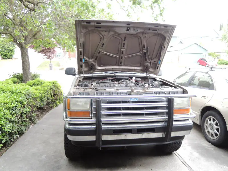

I saved a pic from here, seems like an easy modification.
