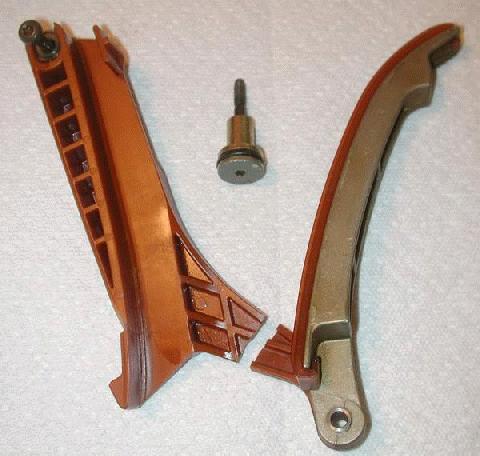

Old thread, but for the SOHC it really just comes down to the plastic timing components. They’re the limiting factor. If you can keep yours intact, the motor will last. The rest is extremely durable.

In my experience of dealing with the Ford 4.0L SOHC engines, around 200K is their typical milage without replacing timing chain components (which in the case of the rear TC set is an engine out job). Many here say that changing the oil often will allow longer engine life, but as the typical damage is broken/worn out plastic timing chain guides and tensions I don't agree with this opinion. The plastic parts wear and/or become brittle with heat cycles and age and then disintegrate. The tensions wear out/become weak at around 75K and should be replaced. I pulled my 2001 Sport Trac's engine out several years ago and rebuilt it with OEM parts. It's a lengthy, difficult process and OEM parts (if available) are expensive and harder to accomplish w/out special tools. Since this major job I have not have any further issues, but I always build oil pressure before cold starting and change my oil at 3,000-4,000-mile intervals using high quality full synthetic engine oil and filters.
Finally, the 5R55E transmissions also seem to have around a 200K life expectancy. Mine bit the dust about 3,000 miles after I rebuilt my engine and added another $3,200 to my costs. Was it worth it? IDK. All I can tell you is that I would not touch another high mileage 4.0L SOHC Ford engine or trans. The one you're considering at 250K is a ticking time bomb. It's not if you will have problems, but when. JMO, but I've owned three 4.0L SOHC Explorers and none of them lived past 200K.
Changing your oil indeed helps the plastic bits because the tensioners are what keep tension on the chains. When the tensioners no longer pump up due to slow oil pressure the chains slap around and this is when the plastic bits take a beating

the 97-98 version of the sohc NEEDS the updated timing components, the cassettes, and main chain tensioner are way different and stronger in the later years.

No matter what oil you have in there, it still takes time for it to make its way to the tensioners…esp on a cold start. That is what I think causes the failures. People don’t change their tensioners, the springs weaken. Combine that with plastic getting old and brittle…
That first 1-2 seconds before oil reaches the tensioners on a cold start…it’s violent in there with the chains slapping around.
I crank my engine until I see oil pressure before letting it fire. I think that helps with cassette longevity way more than ever so slightly less used oil. Mechanical tensioners or a preoiler are even better. I’m going mechanical soon.

can confirm- the original 98 one had 3 leaf backing new oen had 5 or 6 i forget. ill confirm when i can find pictures of the job.
