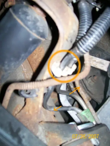

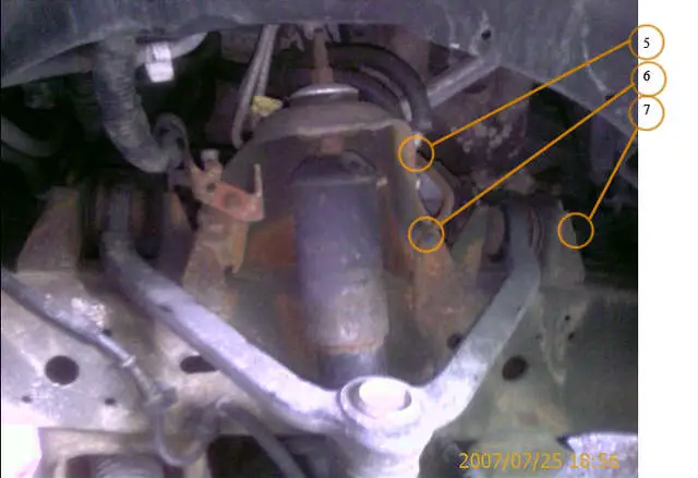

Driver side: (the second camber on the right)
1. (see figure 2 #6) unhook this line. ( will give you more room to push it around in a few steps)
2. (see figure 2 #5 and figure 3 {circled}) Behind here are 2 lines hooked on a white clip, undo atleast the one farthest away from you, if not both. (more room to play when taking out the camber bolt) (WARNING: These are fuel lines, you don't want to break these)
3. (See figure 2 #7) Unbolt this nut. (can't remember the size off the top of my head. 17mm I believe) take off the washer and the camber.
4. (see figure 1 #1) Pull the bolt towards the front end. (just on the other side instead)
5. This is where it gets tricky, remember those two lines I said to unhook? (See figure 3 {the arrows}) You need to snake it between those, they don't move far enough together in any directions for enough room. Even doing that though, it still sucks to take it out. Just try not to break the lines.
6. Now you can wiggle and pull and push it out. It might be hard cause of all the lines, just try to push them to the side (not too far, don't want to break them)
7. Now take your adjustable camber kit and put them in the same way.(bolt head toward the front, nut toward the rear, easier to tighten.) Remember, slide the camber on first, then the washer. (I found if you put the camber and washer where the threads end and the smoothness begins you can put it in no problem, the lines barely get in the way, only did before cause the stock cambers were welded to the bolt heads)
8. Once the bolt is in place put the washer and then the camber and then the nut on.
9. Now you can tighten it and adjust the camber how ever you need to.
Hint
utting the bigger part of the camber toward the engine will bring the top of the tire out, putting the bigger part of the camber away from the engine will bring the top of the tire in.
Figure 2
Figure 3
