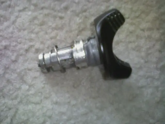

Here's the broken cylinder
I snapped it right off while trying to start it.
