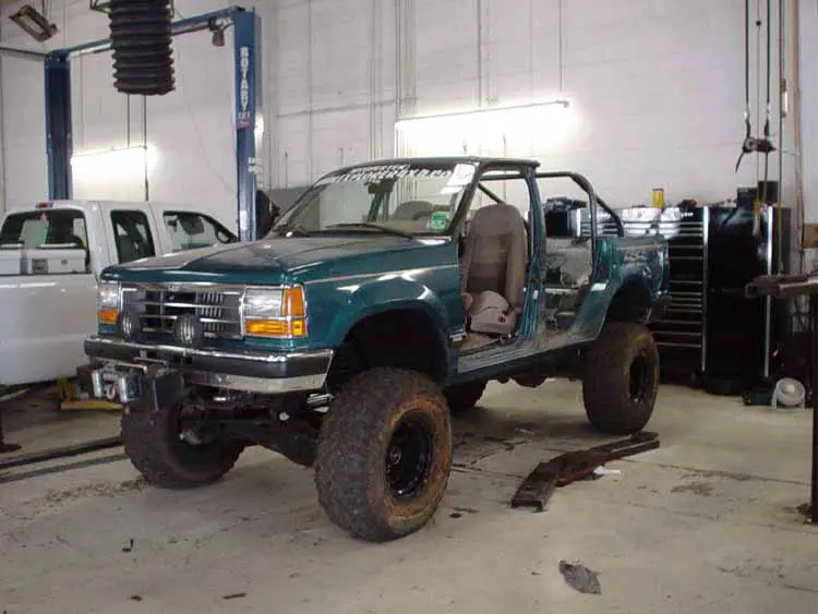

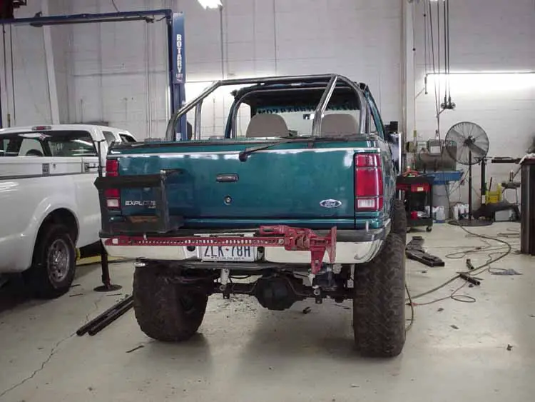

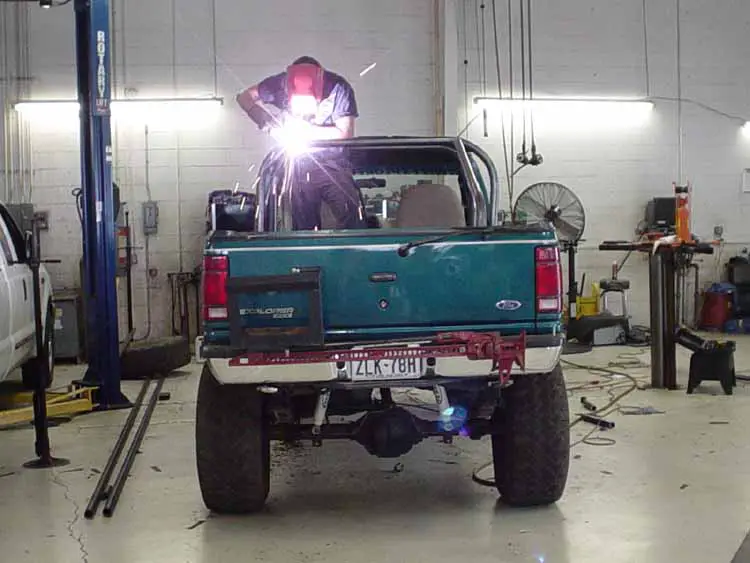

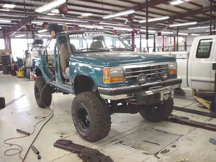

Well today off cometh the roof so I can modify my vehicle. It probably won't look much like an X when I'm done but the front clip will go unchanged!
Parts cut off so far:
I'll have more pics tomorrow!
I offered the roof rack to SVO, but if he doesn't want it, it is up for grabs (free for whoever will come pick it up, you can look at my pics to see how it looks with the tire on, it will hold 35 inch tire and line up with existing roof rack holes.
Ex:
I will not be tying it into the frame.
Reason:

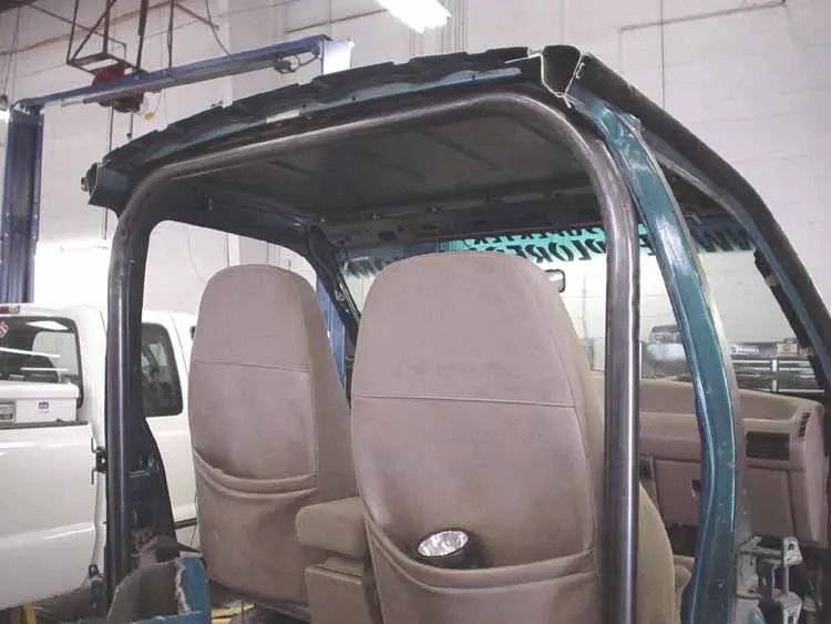

A friend of mine did not recommend it, due to the fact while offroading your fram may tweak a lot, it absorbs all the shock and shifts around, if you tie it into the frame the body may become distorted while the frame is shifting. I'll take his word on it, I am only concerned about the roof caving in on me, that's why I am installing the cage.+
The other thing I could have done was make an external rollcage that did not contact the body, at this point I think its easier to do the internal while attaching it to the body.

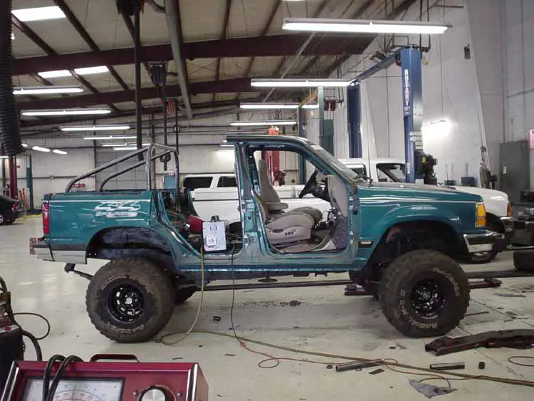

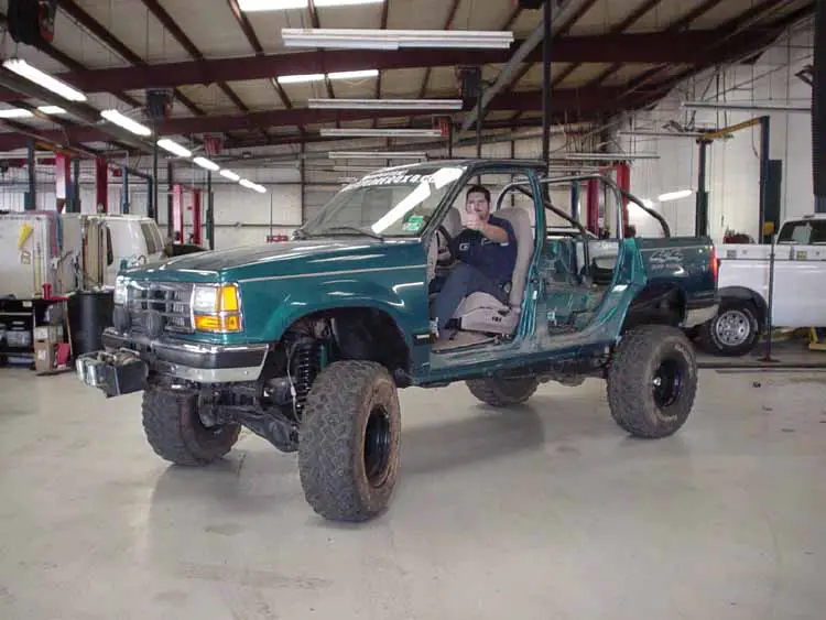

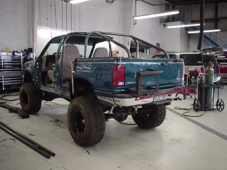

Here's a few shots I got today while up in Dallas picking up some parts from Msuptek after I went to Houston and had breakfast/pick up parts with Johnstone, Demon4x4, and Michael.

dang man you were busting a$$. when i got there he just finished mastering the bending of the pipe. looking good.
Sweet pics SVO, thnx for taking them. LOL! Hope you enjoy the roof rack and LS for you diff. Hopefully I will finish the cage so I can go to Kingsland Slabs, I am pretty sure I will.:D
looks good, mike. loks really good.
did i say looks really good?
Thnx, getting closer for time to rino line! The more people who see it, the more that think I am nuts. I am excited, hopefully I will finish soon.:D
