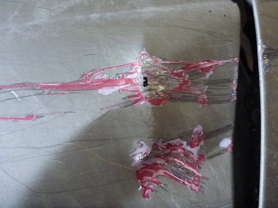

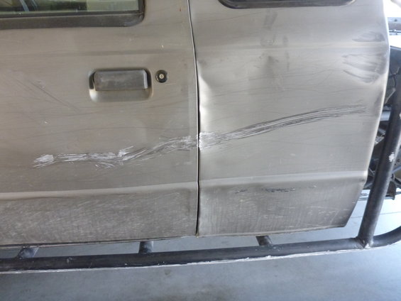

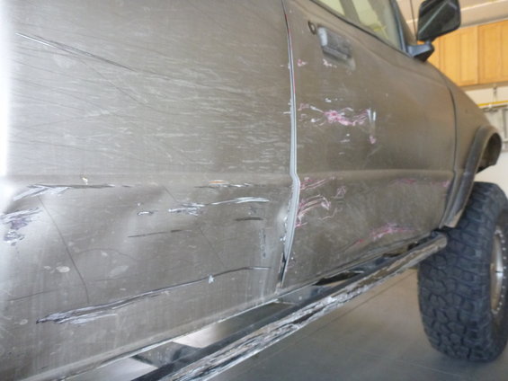

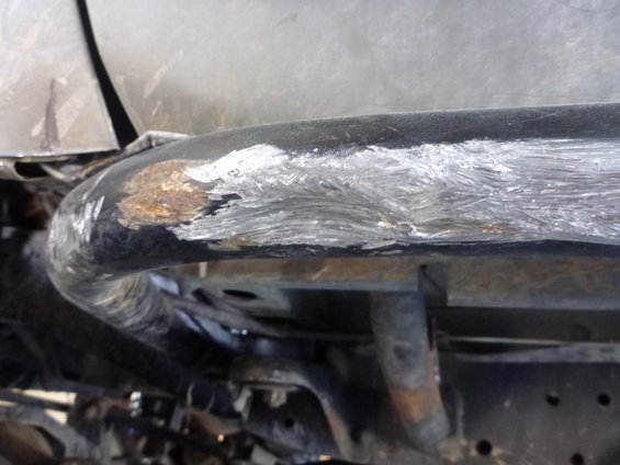

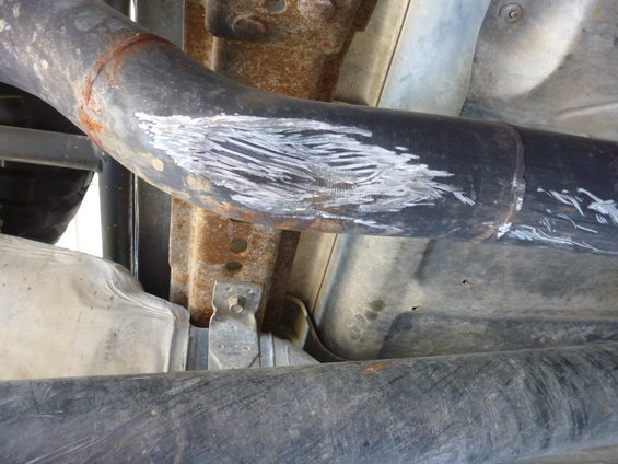

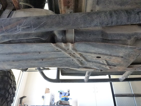

Time for a damage report after my trail run last weekend. Pass. side bumper was pushed up a few inches, dented rock sliders in a couple areas, bent trans. crossmember, bent gas tank and T-case skidplates, dented muffler tube which is above framerails and separated the tube from the muffler (muffler clamp), sheared off a zirk fitting on bottom side of knuckle, doors dented and scraped.

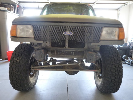

Cut off the front bumper and went over the suspension and steering hardware. I noticed something was knocking like something was loose whenever I would turn.
Thought it was my control arms but it was my drag link and panhard bar so I got those bolts snugged up.
Some pics
For now, just build a new bumper and straighten out the gas tank skidplate since the front edge is now pointing down. Everything else I can live with for now and with summer coming, i'd like to keep the rig together for some runs.

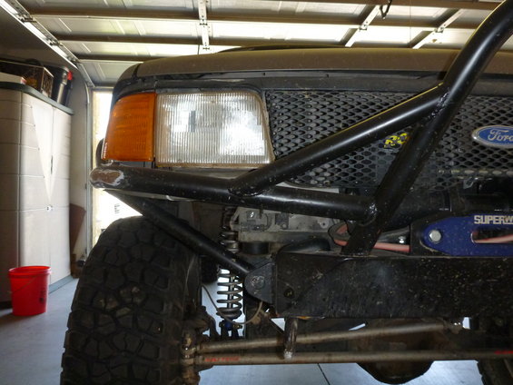

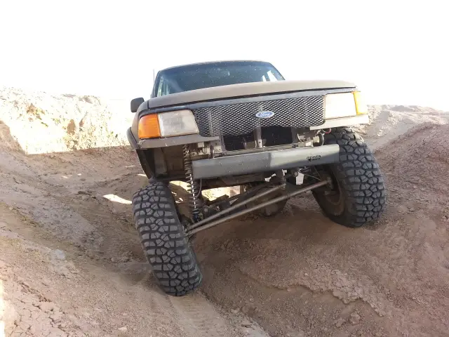

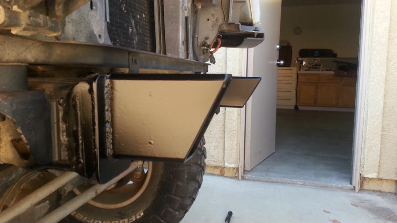

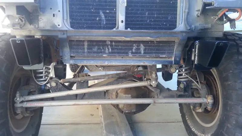

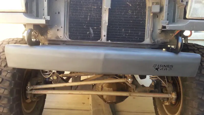

Update-ish...bought a jeep yj winch bumper from Barnes 4X4 sometime back and will add some tubework to it at a later date. Ended up cutting around 3" off the frame horns, all the holes and ripples in the frame made it difficult to drill the holes I needed. Capped off the frame then added some 2x4 box steel to make mounting easier. I can mount the winch but I need to buy some battery cables that will reach to the bed where I want to mount the battery, currently it's in the cab. I'll run it without the winch for now.

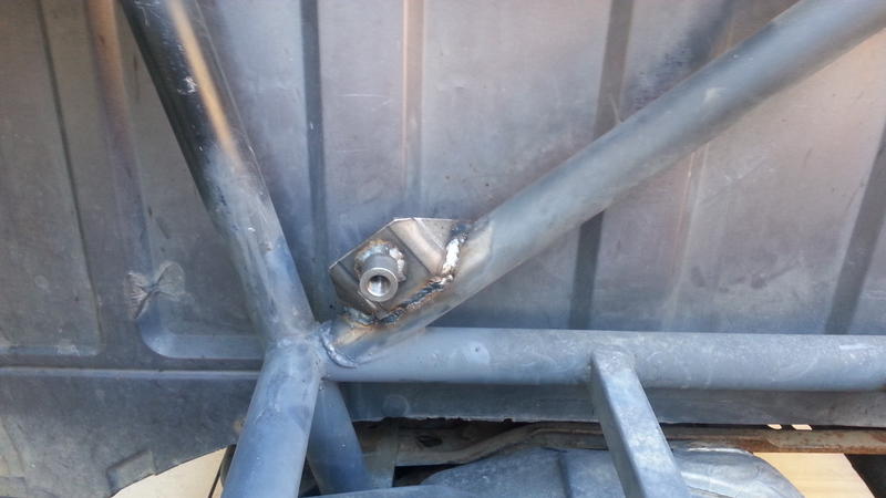

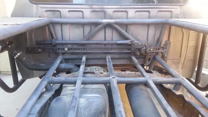

Next I got my hi lift mounted in the bed. This is the first time ever I've had it hard mounted so it's nice to have a permanent home for it. With the spare tire up against it, there's hardly any movement or rattles except for the base.

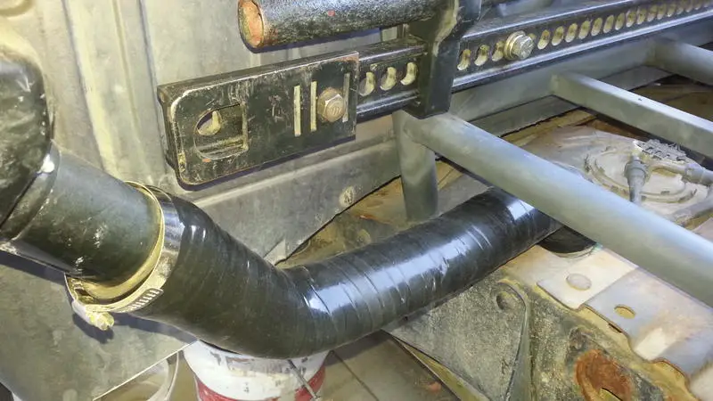

I was at the off road expo and bought some rescue tape, my plan was to wrap the fuel filler hose. The thing is only about a year old and starting to crack already so today I did a full wrap around the entire lenght of the hose. We'll see how it holds up.

Are you going to run thicker tube this time for the bumper? Will you do the same design?
I think I'll stick with the same tubing and live with the fact that it will be a disposable item. That last trip I did was like 5 years of hard wheelin in one day.

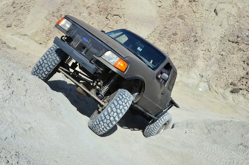

Thanks...I haven't been wheelin since that trip I posted up about but I'm going on the explorer run this weekend. Hopefully there will be some cameras out. Work got busy again so truck mods will be on the backburner for now.

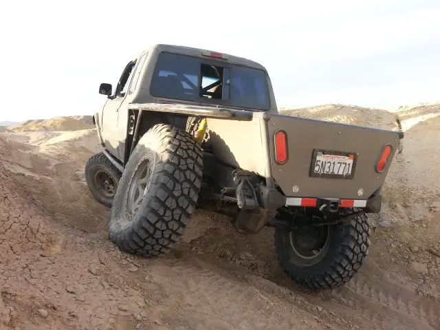

My post Truckhaven report...truck ran and performed great out there, no new damage.
I did have an annoying popping sound from what I thought was coming from the control arm joints. I thought they were worn out and might blow up any second. Looked over the truck yesterday and discovered a loose body mount bolt so I got that tightened up but need to get it off road to see if that cured it.
Other than that it's just general maintenance and a laundry list of small projects that need to be done.
-mag mount CB antenna...old one got crunched in my rollover a few years ago and never got a new one
-wire up winch...want to relocate battery near the hi-lift jack first.
-reinstall stereo system
-finish tubework on bumper
-build a stronger transmission x-member...got dented up on an off roading trip last spring.
-order some new LED rock lights...used to run some $15 WalMart specials but the bulbs just don't last.
Some pics courtesy of the Truckhaven thread

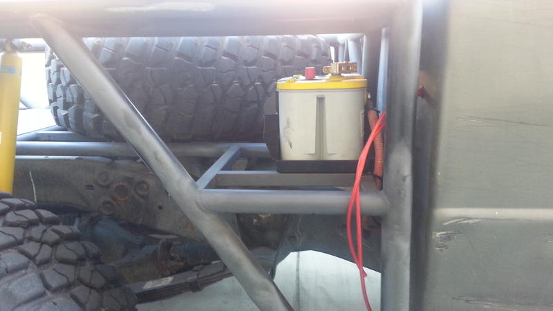

Been getting some work done here and there when I have time. Made a new home for the battery under the pass. Side rear "fender". I'd like to enclose that section the battery is in for storage but that's a project for another time.

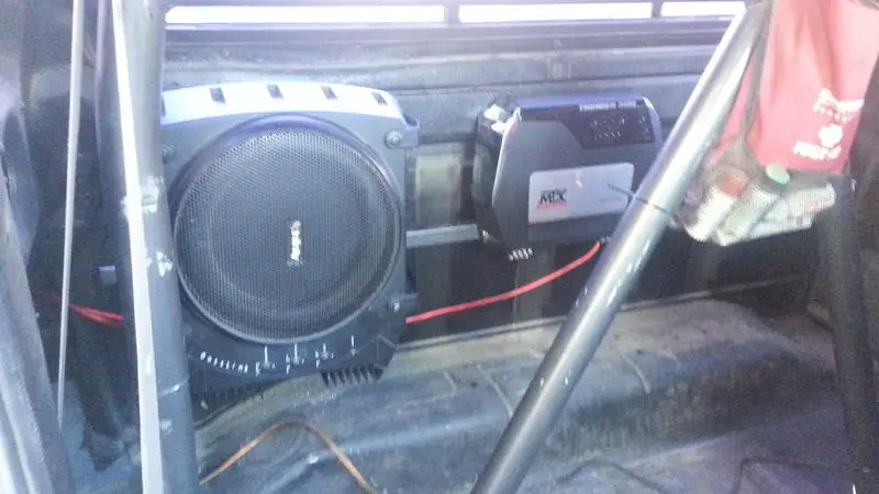

Also reinstalled some much needed tunes, i took everything out when i built the cage. Added some square tubing to the back wall of the cab to make mounting the amp and subwoofer easier.
Next on the list is to get some battery cables to extend the winch leads to where the battery is. Also hope to work on the front bumper this week or weekend.
