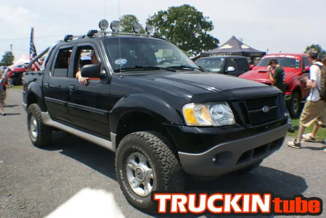

The only differences between the Explorer and ST mirrors are the trim line on the outer edge of the base plate and the wiring pigtails if it has puddle lights. Here's mine from a '99 Explorer, you can see the line that the Explorer mirror has where the ST mirror base is flat and smooth. Not a big deal for me.
Thanks for the pic Jerry. From reading past threads, the fit sounded MUCH worse. How are your body mounts coming along? ;)

The only thing fitment wise was trimming the weatherstripping off a little from the mirror. As you can see in my picture I trimmed about a 1/4" too short but the inside foam gaskets behind the mirror makes up for that.
