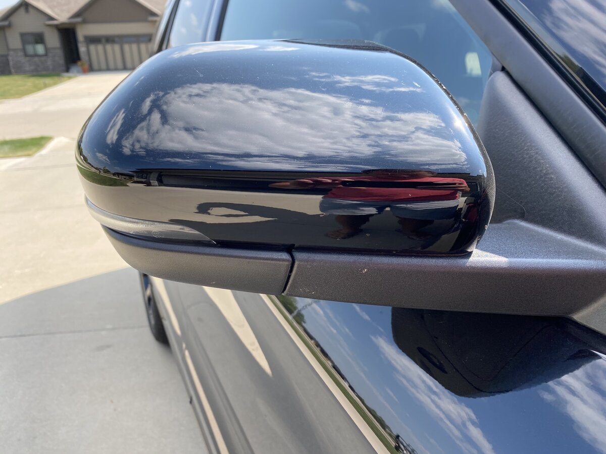

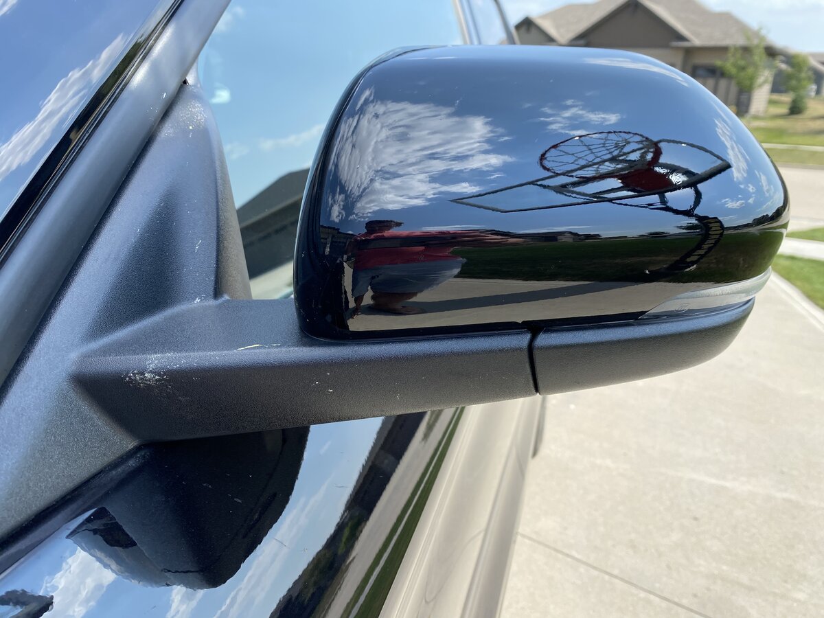

Was yours a loud whistle at highway speeds or the low speed whistle on the passenger side? Mine is the low speed whistle on the passenger side only. The mirror shroud is different between the right and left so someone forgot to rev the design of the RH mirror probably when they discovered an issue.
Would you be willing to take a pic showing the difference you're seeing as different after your issue was resolved? Mine look exactly the same from what I can tell.
View attachment 320543View attachment 320542
If you look at the piece of the assy covering the window, the drivers side has a depressed area and the passenger side is smooth. This effects the airflow and velocity of air between the mirror and the window. This has been suggested to be a possible contributor to the issue.
I see the contour on the drivers side now in my pictures. Thanks for clarifying. Would love to see what the result is on the rev'd/new assembly you get installed. My dealer is waiting on anything (here/Ford) to help them out, so the more info you can get would be super helpful.
