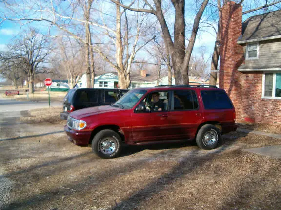

We took her for a 2wd spin and no more rattles. This one runs pretty good. It will hit 55 from one end of the bridge to the other. :D
Now some pics
The rust on the bumper doesn't bother me. It will be changed soon enough.

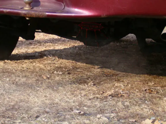

Very good... I'm out to change brake pads, I got 20,400 miles before today, dropping a pad.
Where could you have gotten that diffy cover from:scratch:
