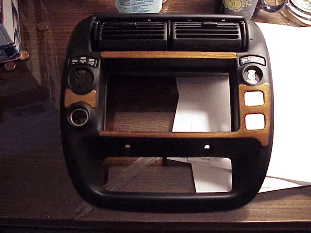

Just got a piece to my new project. My radio bezel has been cracked since I got it, and I've now finally gotten around to bidding on one. I'm planning on painting that, the black inserts in the center console, the black in the over head console, and the bezel around the gauges to match the exterior color.
Any Tips on painting this stuff. From research the rubber coating has to be sanded off. What about removing the labels for the r. wiper and the 4x4 switch? and the vents.
Thanks alot!!
PS- The wood trim is coming off :p :rolleyes:

Looks very nice, what was the proceedure you did to paint it?
i was using a compresser/paint gun..but..i first went at it with pretty rough snad paper(not sure of the grit) to get the rubber coating off of it..(nasty stuff to get off)..then real fine sand paper..then 2 coat's of color sanding inbetween..then 3 coat's of clear..and buff..you can't tell in the pic's but it's all shiny as hell!!

Hey thanks guys! I've always wanted to do this. But never had the $$ at the right time and never wanted to paint my cracked one. What did you do to your wiper and 4x4 labels Ak LTD Xplorer?
i removed all the switches and the back thing that say's wiper and 4x4..they are melted together..so i broke the little tab's then used epxy to put them back on..i did my whole center consol,brazel(?) and the thing around the speedo(working on it)

Well, It looks quite different now. WIth some fingernail polish removed, sanding, paint stripper, and more sanding, its ready for paint!! Gonna go price the paint at a few places tomorrow, then probably move onto the center console.
I did find one important thing, laquer thinner will eat away at the plastic!! Yet it did nothing to that rubber coating :rolleyes:
