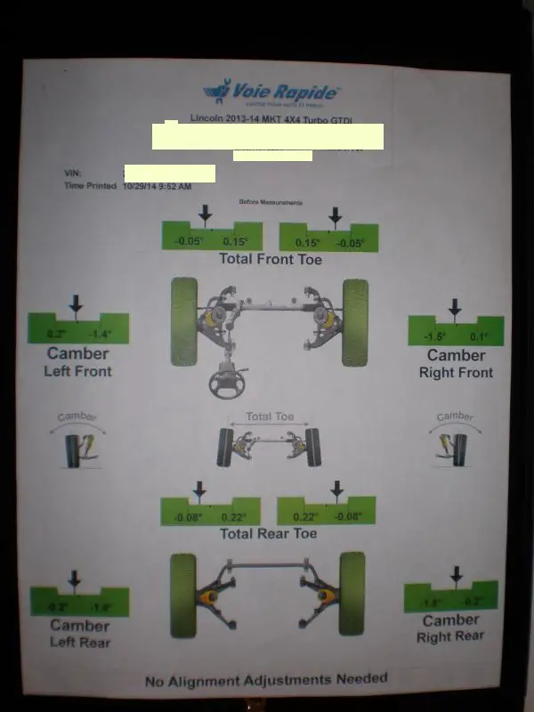

I've had it back to the dealership multiple times where I was first told, "the alignment was within acceptable range". The second time I brought it in I asked for a print out of the alignment measurements.
As you can see the alignment shows as passing, but no measurements. The front tire wear is higher on the right (76%), than the left (87%)
