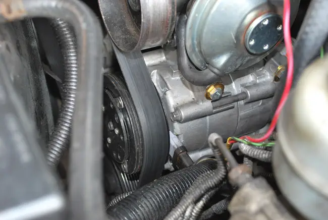

Finally finished the compressor swap. The first time around, I had the lines going to the compressor backwards. So actually I was cooling down nature instead of the interior of the van.
Top of the compressor. I kept the most of the wires from the Explorer so I was able to clip off the Explorer's compressor connector and reuse it for the van.

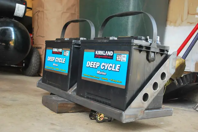

The batteries needed replacing - of which there are three - one under the hood and two on the side (in one front and one behind the rear passenger wheel). The two on the side are a PITA to remove so I replaced the "can"/tray doodad and instead of regular starting batteries (both were group-65s), I went with a pair of deep cycles (group-24). The one under the hood I kept as a regular starting battery.
I dont have pics of the new tray welded to the chassis but here it is before. There are two ratcheting handle thingies welded to the bottom which, with a strap going to the top, secures each battery to the tray.
I havent rewired the whole thing yet cauz I ran out of daylight but maybe on Tuesday or Wednesday I'll have some time to finish it up.

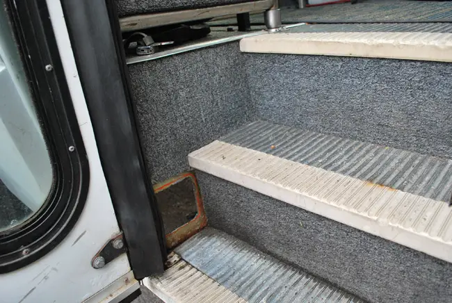

The relay had to go somewhere convenient so it was decided near the stairs will work. Plasma cutter made making a hole quick and cleaned it up with a file afterwards:
Box container thing:
The white thing is a two-piece PVC pipe thing I found at HomeDepot - its being used to keep the wire from rubbing against the sharp metal edge.
Got dark quick but I was able to paint and wire up (2 gauge)
The hole will get a cover at some point but I still need to wire up the driver part for the relay (switch and voltmeter).

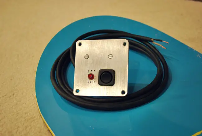

Switch panel made and installed:
Panel in action. The hard click when the switched is turned on and off is the solenoid closing and releasing.

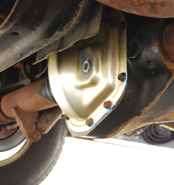

Last December I won this super fly aluminum D60 diff cover from E-bay for $10.60 - anodized (I think) in some gold color. And today was a ripe day to switch from Amsoil to RedLine gear oil (before winter arrives) so the new diff cover went on tsssuu..
An example of how dirty the fuel bowl filter gets after about 7 months:
The first filter I replaced right after I bought the van was about twice as dark.
Cauz I've heard of good (best) things about RedLine - some racers say its the next best thing to a custom oil blend. The Amsoil I put in about a year-ish ago also made a weird noise at like 55 - 60 mph. So I'm going to give this a whirl and see how it does. RedLine's 75w140 is also about $5 per quart cheaper than Mobil1's.
