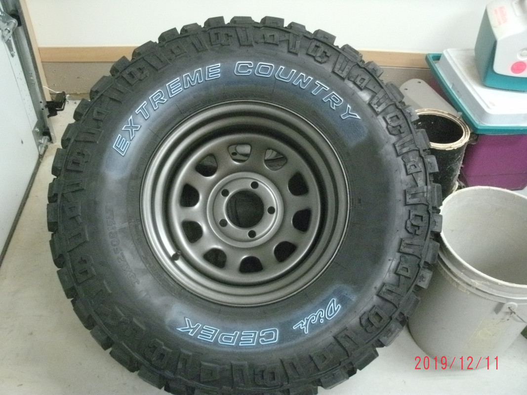

I think that will be the one I get when I go 33's. Those look awesome and look like they will be great in the rocks
I couldn't pass on the buy 3 get one free and free shipping!

Thanks, I grew up around to many Mennonite people who would brush paint everything shiny on their cars black, including hub caps.
I think that's why I don't like black wheels...lol

Tires look great cant wait to see the bumper
Nice color on those steelies

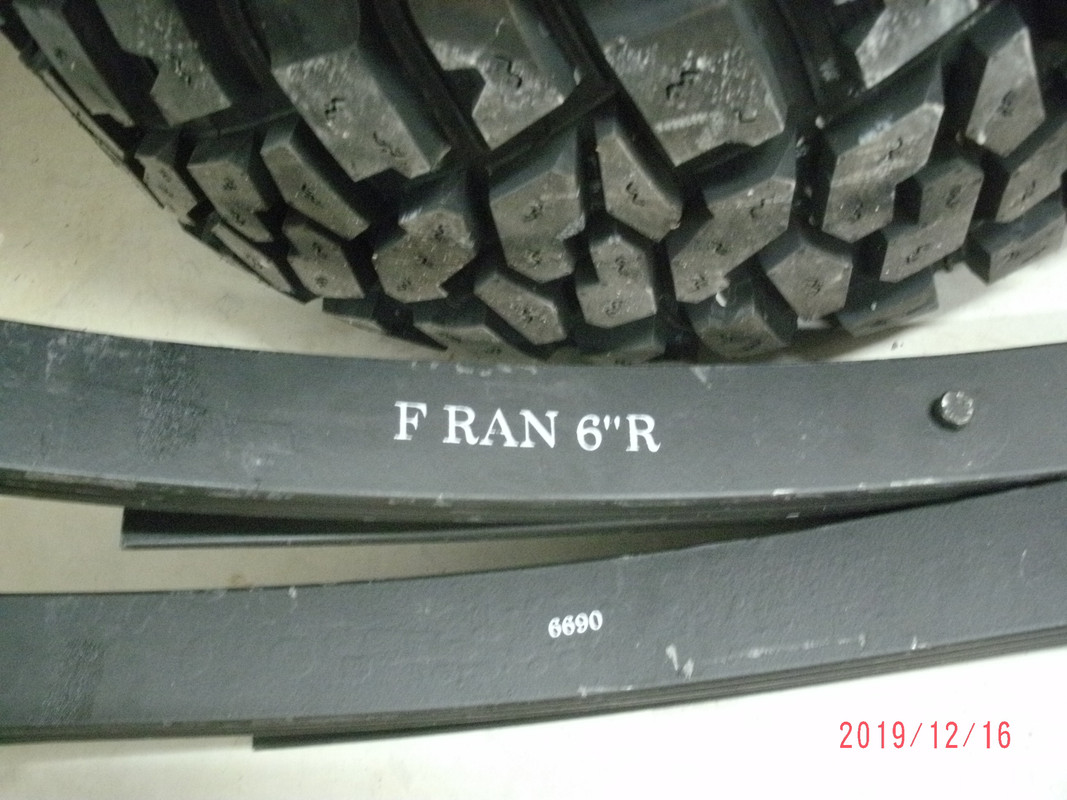

Update....
The new SkyJacker 6'' Ranger springs came in today!

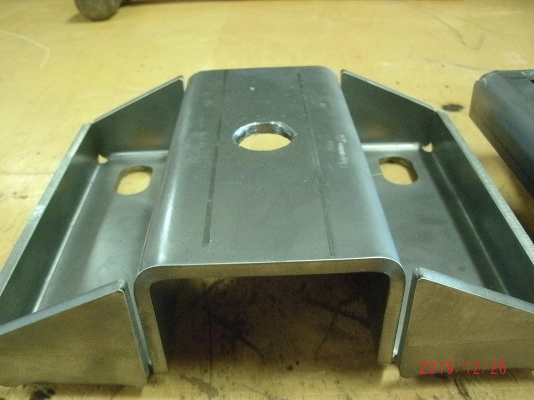

I'm still gathering stuff, like this.
Spring Under U-Bolt Plates
Gunna give those a try and remount my shocks somewhere. I thought about a bolt flip with the nuts on top but I like the simplicity of those plates.

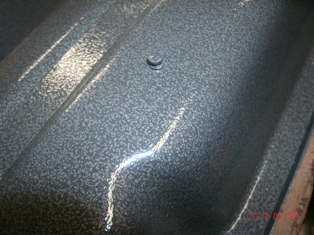

The lift parts will be coated in this hammer tone grey that I did my valve covers in.
I'm not going to powder coat the knuckles, too many places to tape off. They will be blasted and just spray painted black and the new leaves will get a coat of black as well.

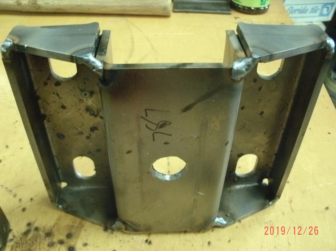

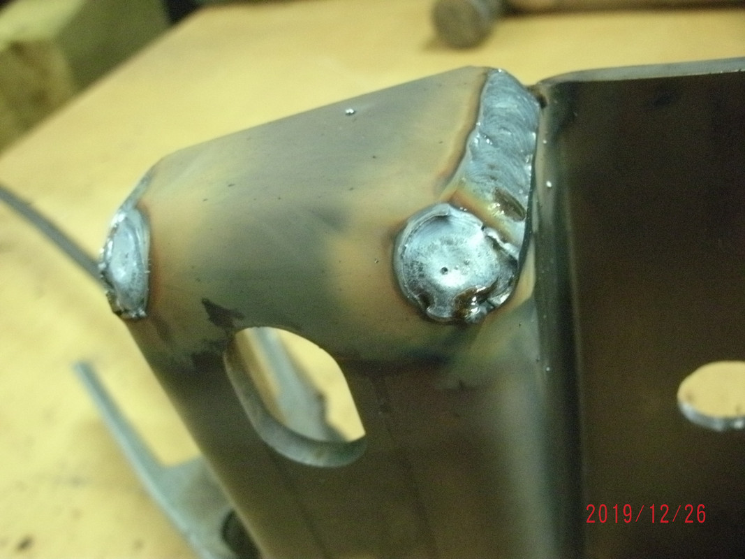

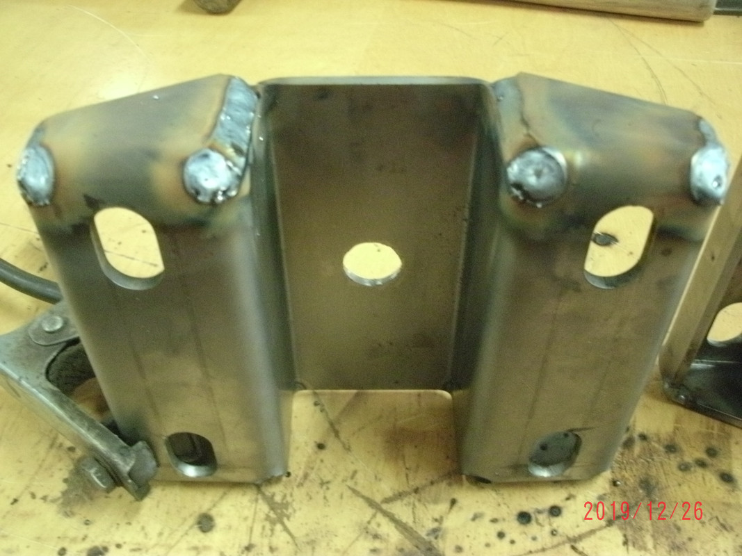

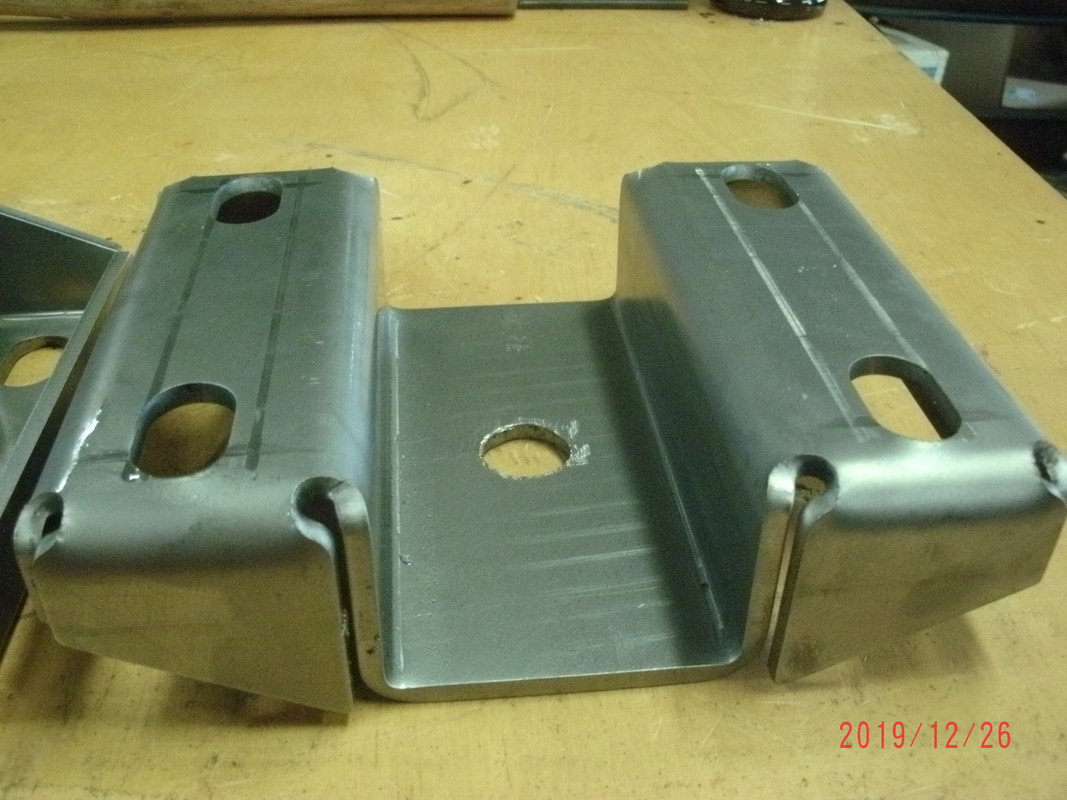

I dug out the MIG today and welded up those Ruff Stuff U Bolt Plates.
How they come.
I tacked the ends of the seems then went full boogie.
These things are pretty nice, they are bent very well and seem heavy enough to do the job. Now I got to find u bolts that are threaded about the whole way up to the bend.

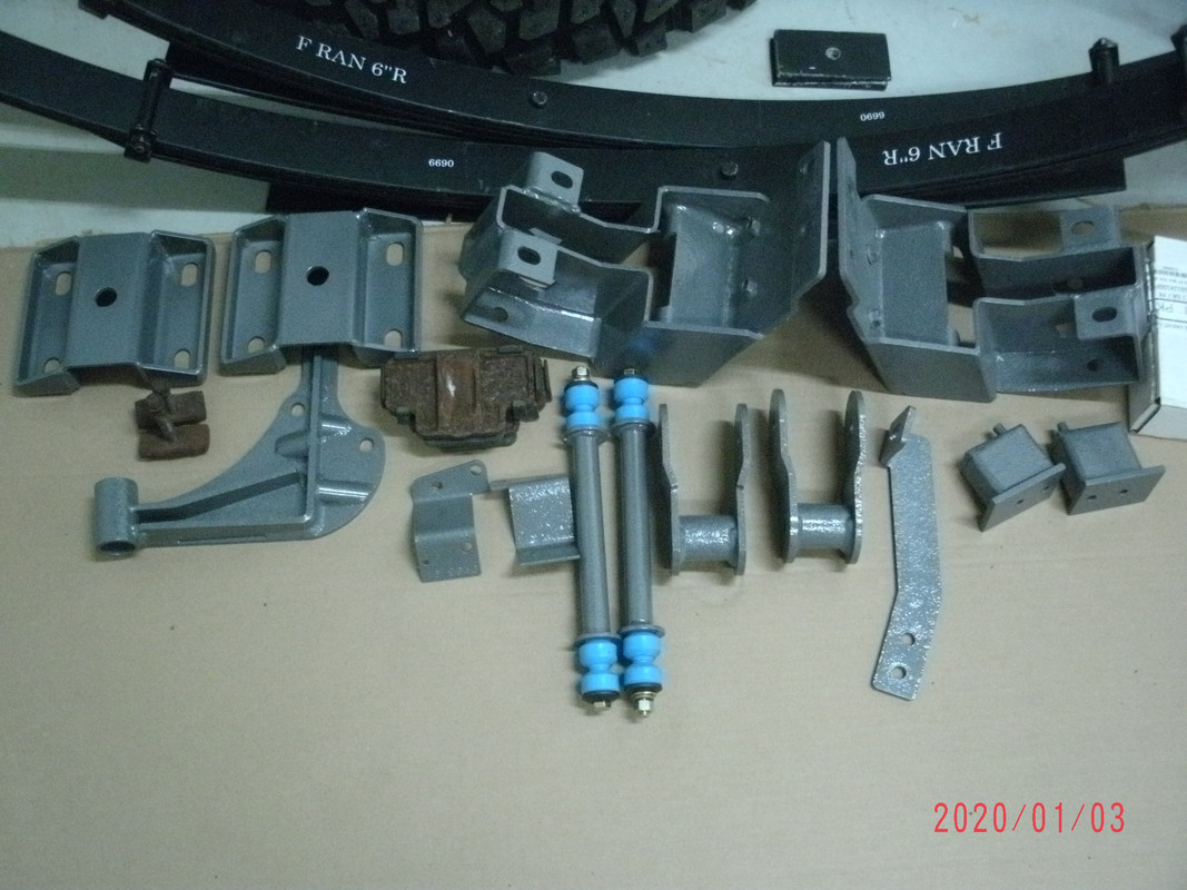

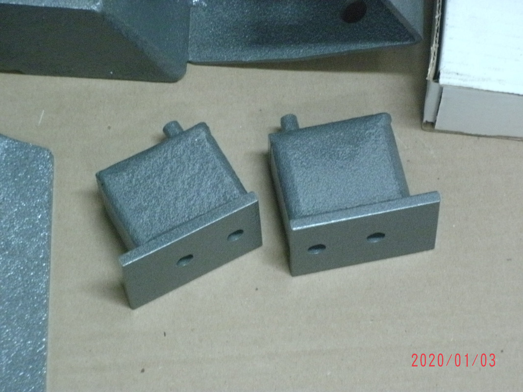

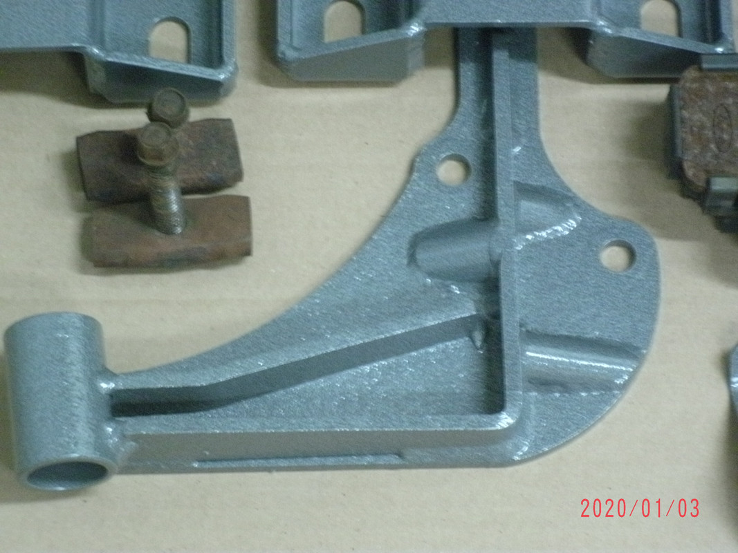

Update.....
Everything I had cleaned up so far got Powder coated today.
This bracket got 3 new gussets added to it after reading a thread about a guy who bent his.
The front bump stop extenders got cut down 1 1/4'' because the aftermarket bump stops I found are that much longer then the factory units. And they have a larger diameter so that's why the bottom plate is wider and longer then it was originally.
I just have the main control arm brackets to clean up yet but I am waiting on my 3/16'' plate to show up to make a skid plate for them before I clean them up.

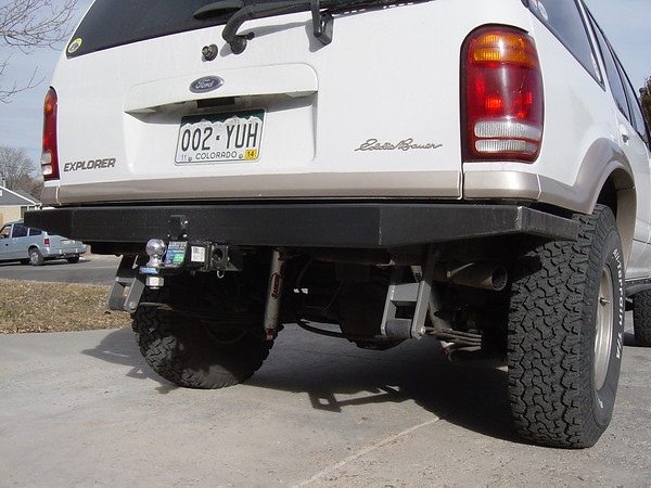

My steel came in for my rear bumper and skid plate.
The plate is just 3/16'' and the 2x4 and 2x2 is only 1/8''. The last thing I want is a heavy bumper that probably wont get used that hard. I just want to make something that don't hang out from the body or hang low.
SWIGIN
February 6, 2015
592
89
PA
79 Bronco , 98 Explorer
I had to steal Starkmans rear bumper pic.
This is what I'm going for, simple and easy.
