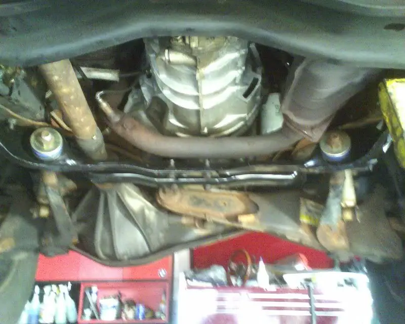

So, when i bought my truck, there was this horrible clunk noise when i hit the brakes, or took off, my friends named it "the death clunk". A look under the truck showed some badly worn radius arm bushings:
I drove it for about a week and figured i better fix it fast. I was hoping I would only need new bushings, but i'd better look before I order parts. I got under the truck and took off the radius arm nuts and rear bushings and bam, both radius arm brackets are FUBAR'd as well:

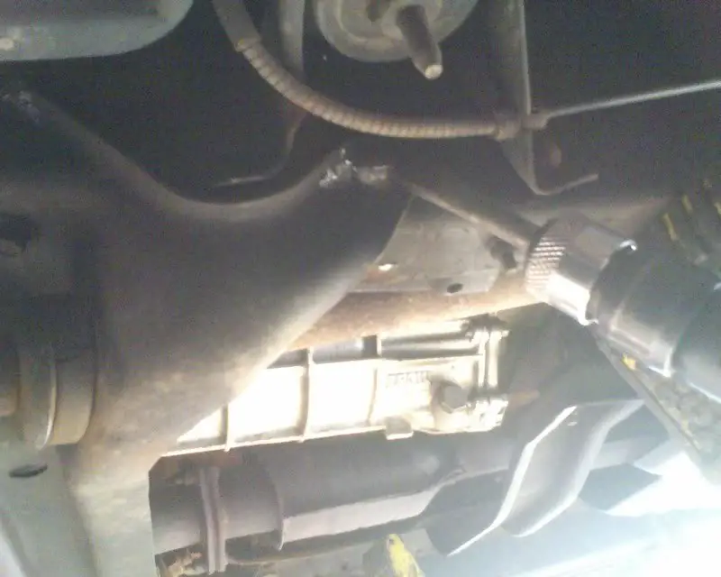

So I ordered up the parts from rockauto.com and got to work. The whole job only took me like 2.5 hours. Of course I had my buddy's shop stuff full or air tools and a lift which made it much easier!First thing I did was use the air chisel and bust off the 2 rivits per side, don't forget to unbolt the fuel filter and get it out of the way first!

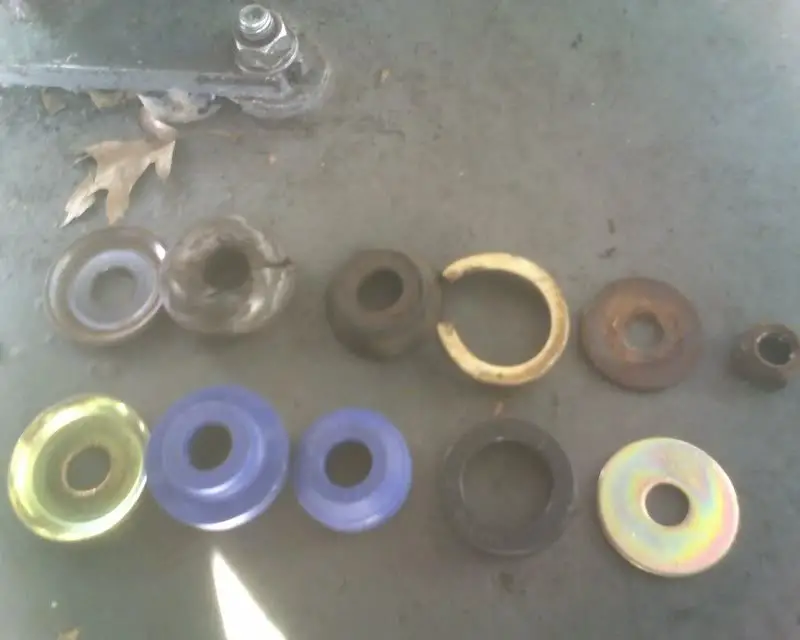

Then I unbolted the the other bolts and the brackets came off pretty easily. Look how bad the old bushings were compared to the new ones!
