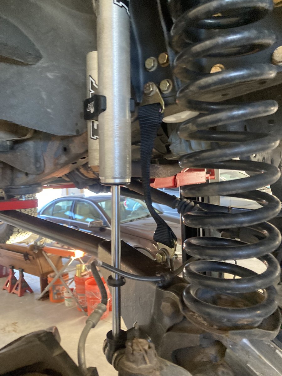

I have been running around with 3 shocks for quite some time now. The rears are probably not doing much either- they seem pretty blown. So I added the correct eyelet to the passenger side shock, loctite'd the heck out of it, and put the bushing in. Next I moved the reservoirs to the rear of the shocks so they would not interfere with the brake lines.

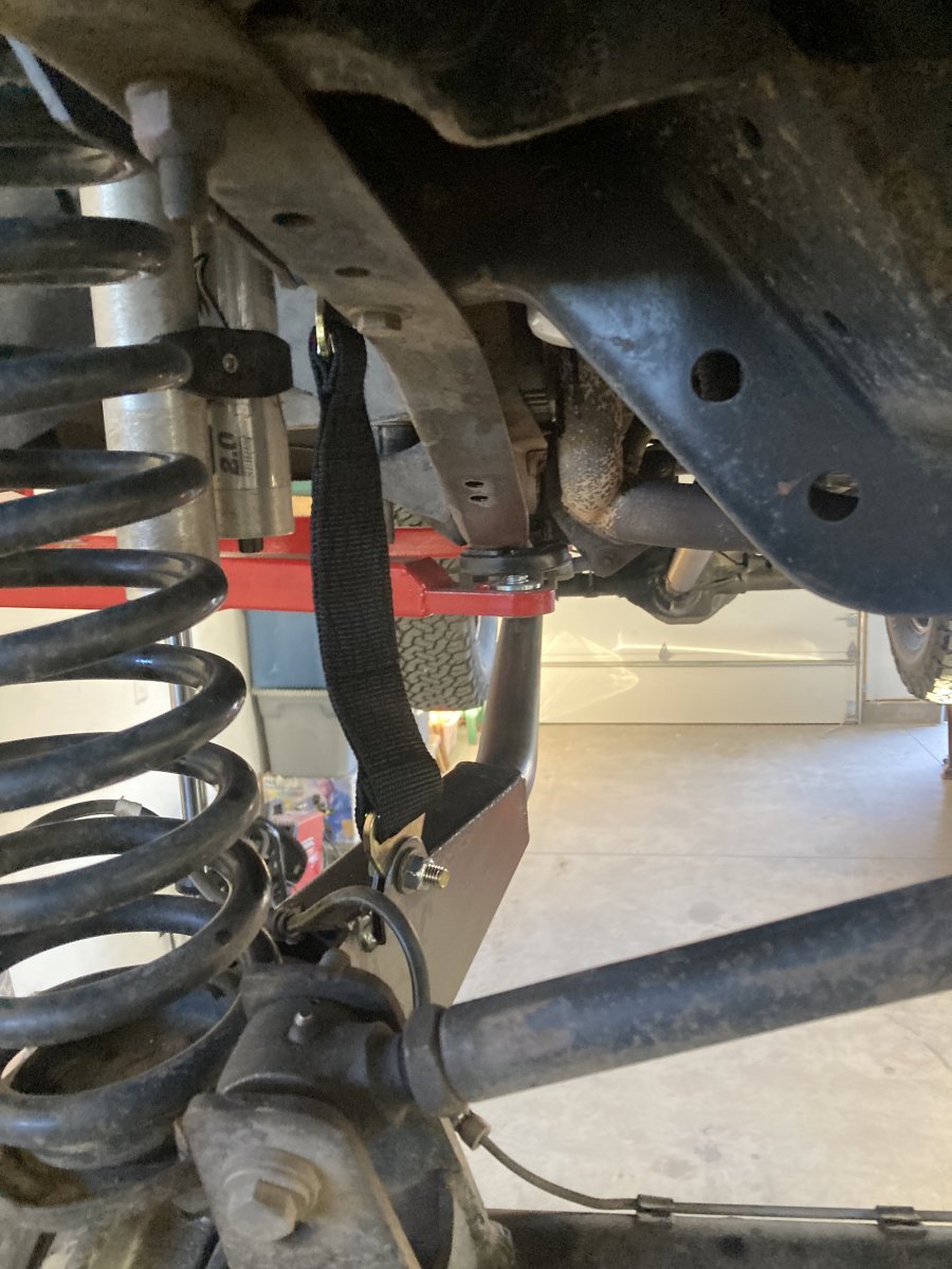

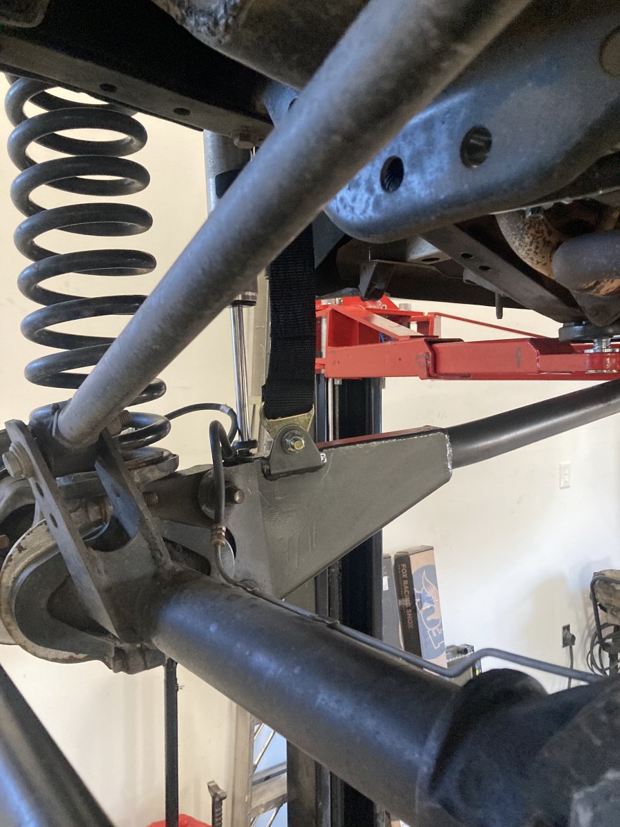

Next, I have had some limit straps sitting on the shelf for a few months now. I wanted to get them installed. I thought I had a plan to mount them behind the shocks, but they were a little longer than I thought would be ideal in that location and the drivers was going to interfere with the pump for the rabs. I ended up putting the top mount on one of the shock mounts and welded the bottom on. I think it will be a great location and length. Left some room behind the shocks if I ever get some hydro bumps.

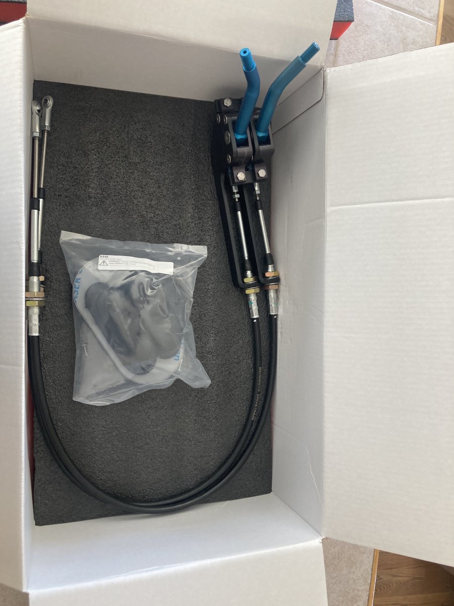

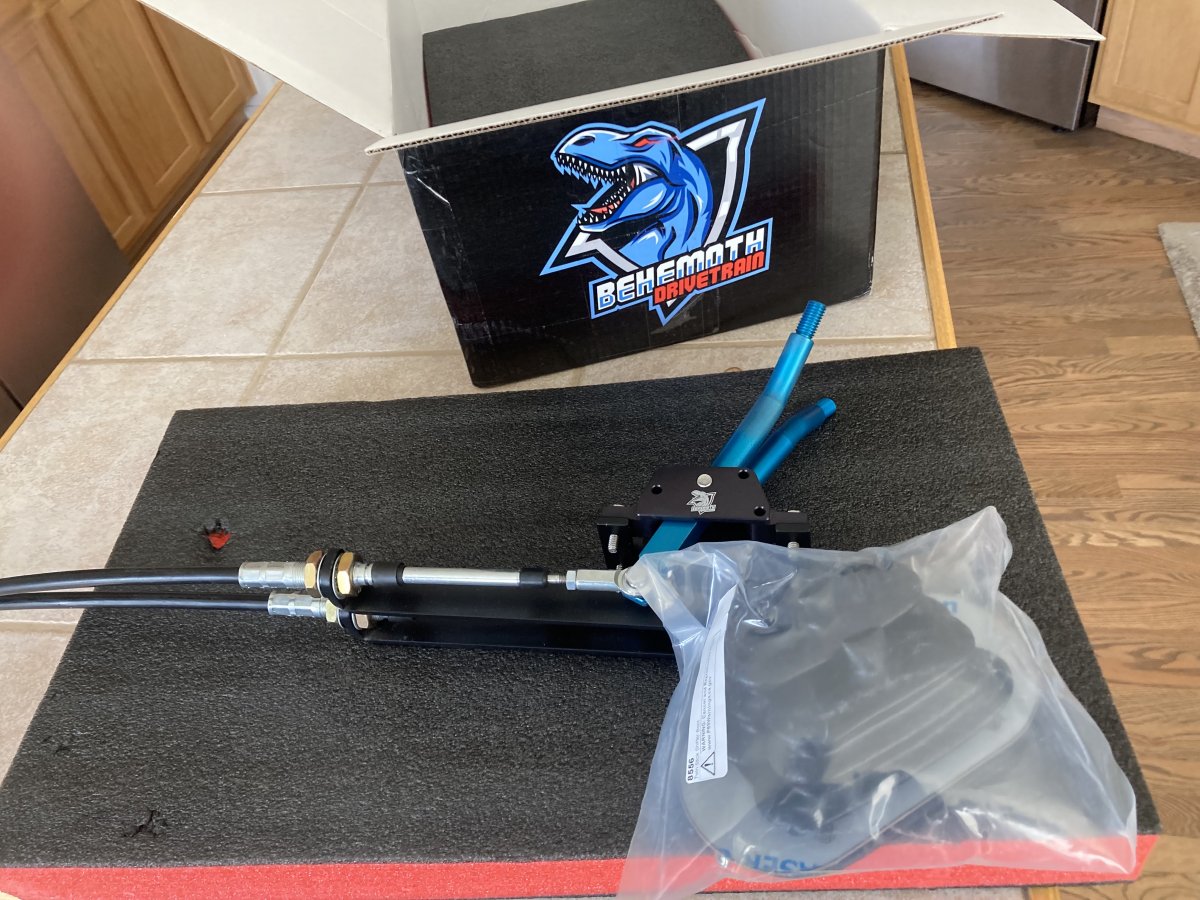

A couple of days ago I came home to a surprise! I got the shifters from behemoth. I didn't think they would come with cables, but they did!

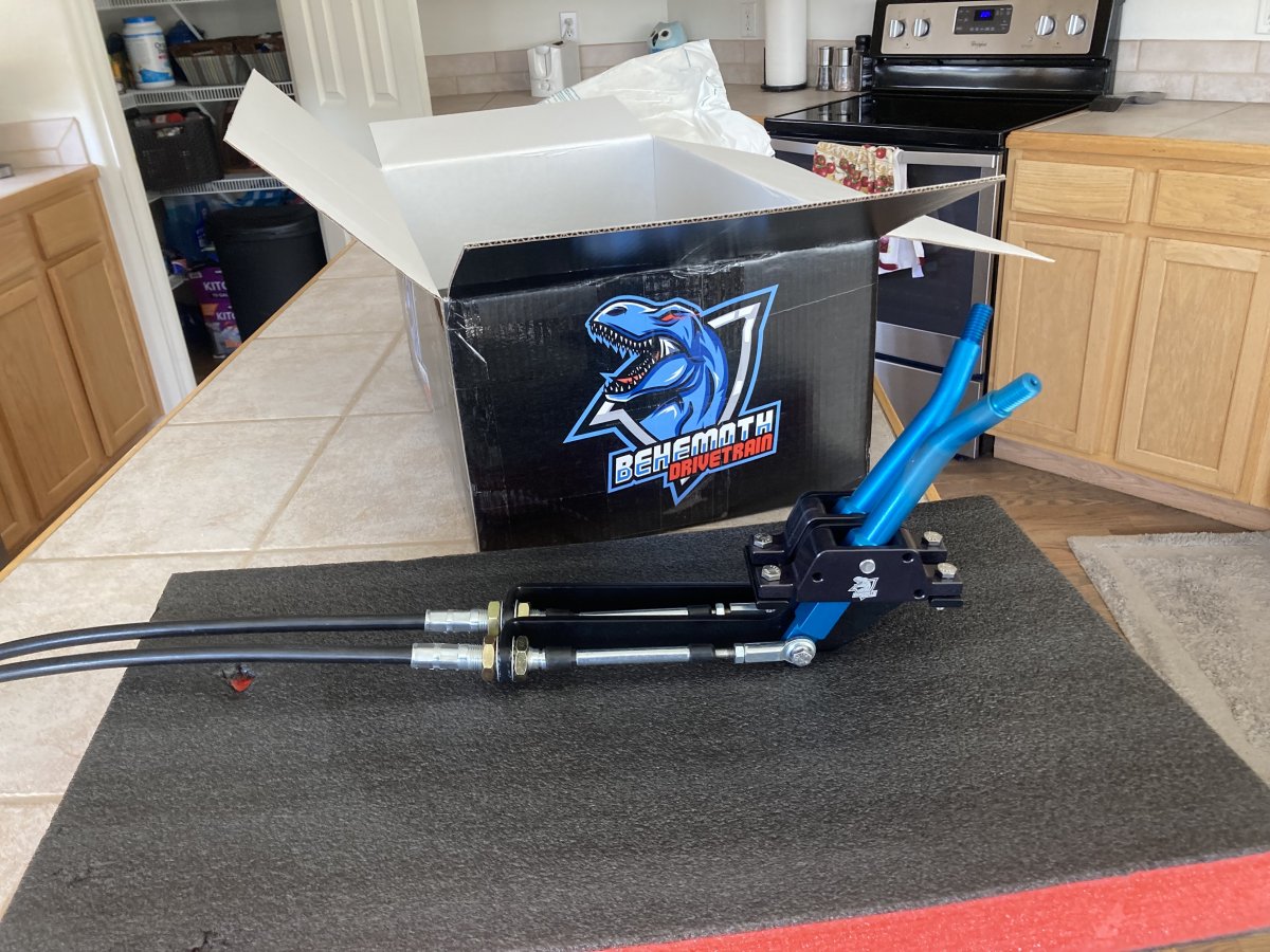

I quickly got it into the kitchen and un boxed them. I am impressed with the quality and size of these things.

You can see how they mount in this picture. I think I am going to make a new plate for my floor out of thicker steel than the current aluminum and have it rhino coated with a hole for these shifters. I need to find a good manual trans boot without the tcase boot attached. That could be a chore.
It came with an independent boot for the twin sticks:
Hopefully that shifter boot is better then the Amazon one a bought that cracked and fell apart after a year or so. I can't remember what brand mine was but it was cheap. I want to see how you like the doubler compared to your old d.d machine setup.
I hope so. Looks a little like the one I ran in my explorer, but different material. I think I got it from Jeffs Bronco graveyard. I ran it in the 1354 manual bezel and tucked it under. It wasn't awful. If this one gernades Ill but another Jeffs.

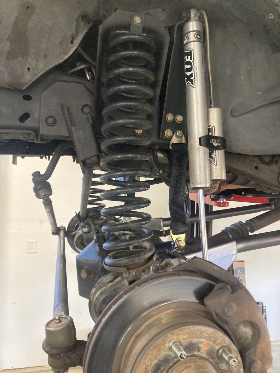

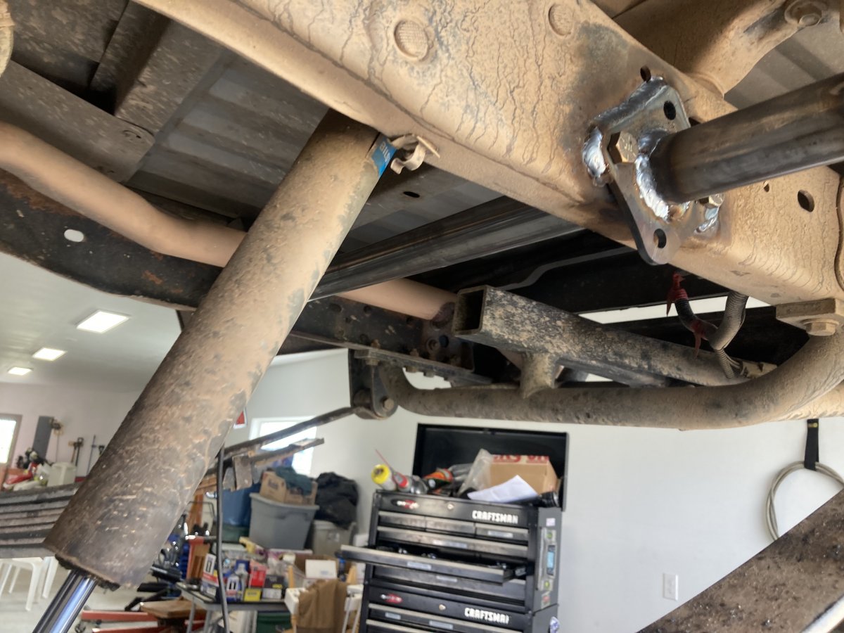

I started a new project here in the last 3 weeks or so. I have been wanting to outboard the rear shocks for a long time. The bilstiens have continued to come apart- likely from over extension. I wanted to put them in the wheel well since I have tons of space with the wide rear axle, and also to help the thing handle better. I have the left over fox 12.1 travel 2.0s that were not long enough for the front.
I wanted to make sure not to cut into the bed- I use it too much- I also wanted to be sure the frame doesn't twist under the load- so I tied the two sides together.

You can see from this photo that the two are tied together. I used a hole saw to drill a 1.75" hole in the frame and the mounts are tied together.
