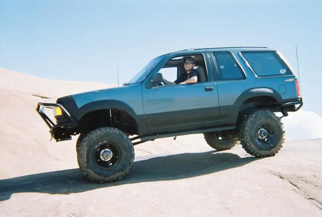

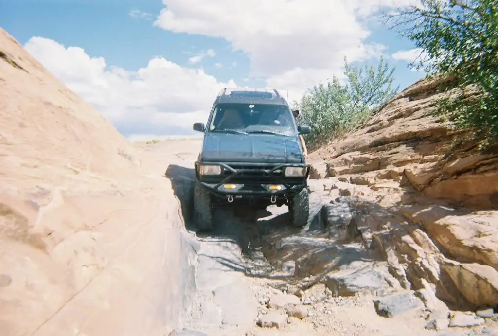

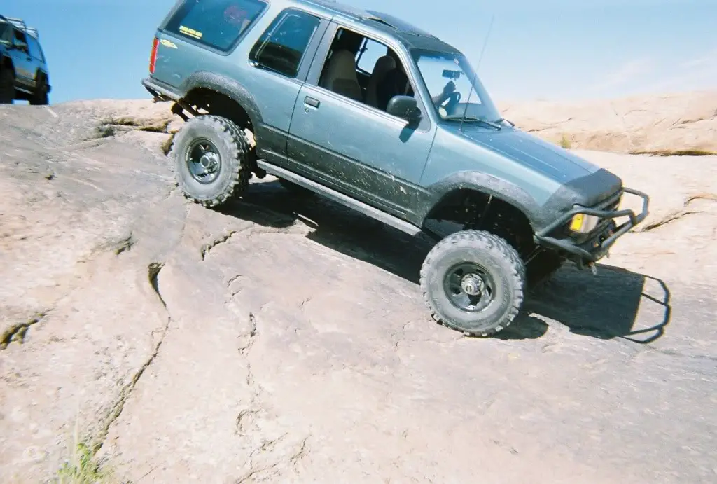

Kirby, great pics man! Looks like your wristed radius arm is really working hard on those trails and freeing up a lot of flex.
