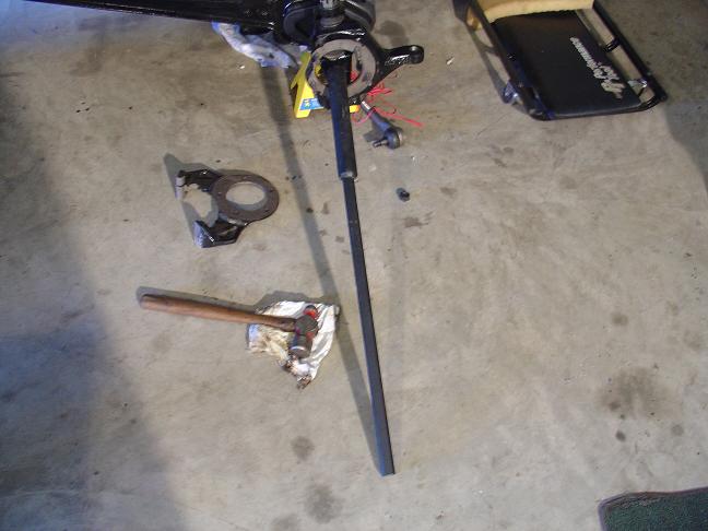

First I have to get the old carrier out of the axle. The D44 axleshafts will slide right out of the housing (after prior dissassembly to allow this), they are not c-clipped like the 8.8 and TTB D35.

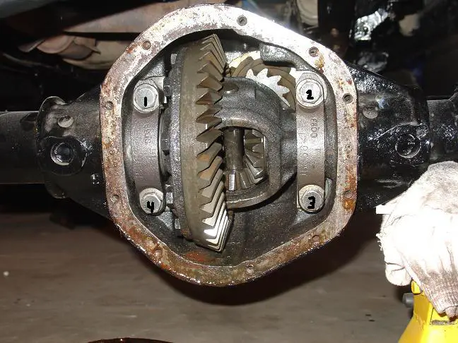

The most important thing here is to mark the main caps for re-assembly. They are removed by undoing the 4 bolts on either side of the carrier. The main caps are machined from the factory as one unit while they are bolted in place, you cannot interchange them, they must go back on in the same orientaion that you took them off.
I used an electric etcher to number the bolts and kept the bolts in the main caps.

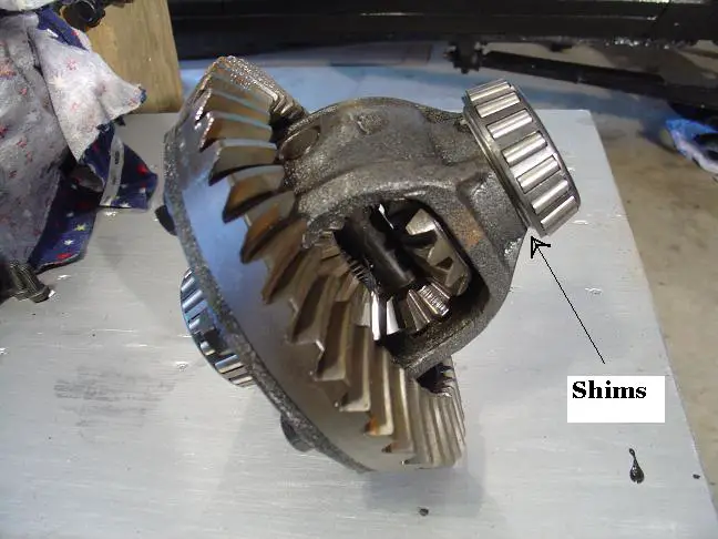

On the D44 axle, the shims are located under the bearings. When you press the bearings off, keep these shims AND remember what side they were on ESPECIALLY if you are re-using your original carrier. With the locker going in I don`t see a likely chance of getting lucky with the shims, but I will use them for my first set-up attempt, as I would if I was keeping my original carrier.

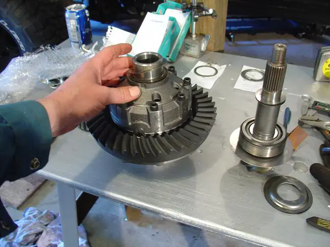

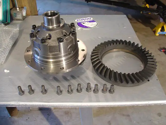

In the meantime I put the ring gear on the locker.
The kit came with new ring gear bolts and blue removable threadlocker.
-I Lined it up and seated it with four bolts, hand wrench tight. I marked the bolts to remember them..

Then I installed the rest with threadlocker to handwrench tight and took the four back out and reinstalled them with threadlocker.

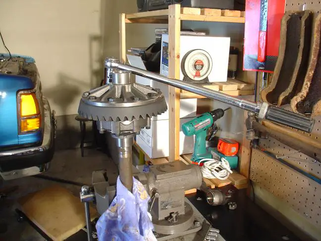

After they were all hand wrench tight, I put one of my shafts in my vice and sat the locker on it.
I then used a torque wrench to torque them all to the ring gear manufacturer`s specifications, which were included with the gearset.
-55 ftlbs
I started slowly, tightening evenly and moving around the ring. eventually I hit 55ftlbs on all of them.

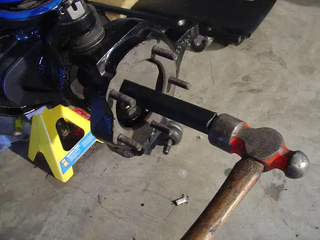

inner oil seal removal
Got lucky with a cheater bar we use at work for load binders.
1 5/8" round tube on the end of 1 inch square tube. Need at least 35 inches long to pound out both seals into the pumpkin. The 1 5/8 tube slides in perfectly, then hit with hammer.

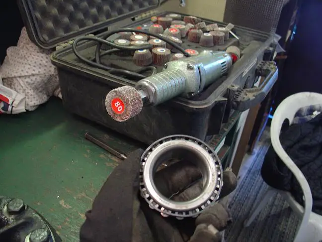

The bearings I converted to set-up bearings by using a die grinder to hone out the inside until they just fit onto the locker carrier.
I did this so that as I set it up I don`t have to press the new bearings on and off as I find the right shim combination.

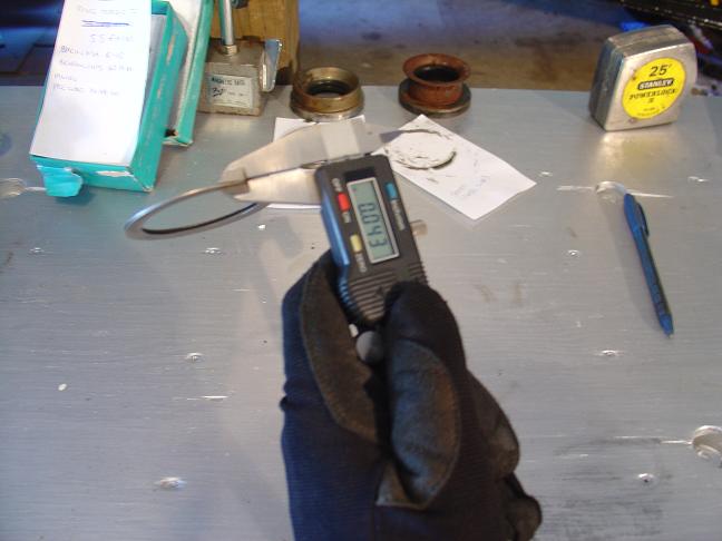

I have a digital caliper to measure my shims as I progress through the setup.
unfortunately the kit doesn`t come with any real thin shims, so to make small changes you have to measure and find the right shims and do the math.

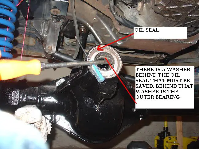

I used a big pipe wrench to hold the yoke while using an impact gun to loosen the nut.

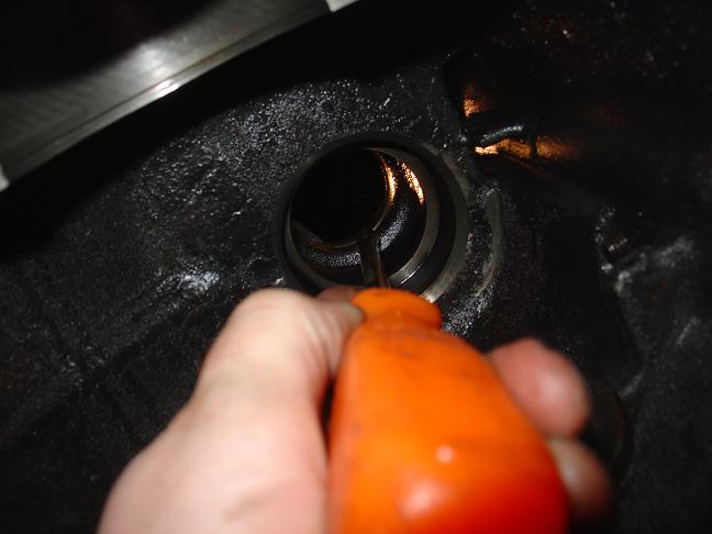

Then the oil seal has to come out, see pic for method. Just hit the screwdriver with a hammer, and she will come out. The install kit has a new seal so no worries about saving it. Save the washer under the oil seal for re-use.

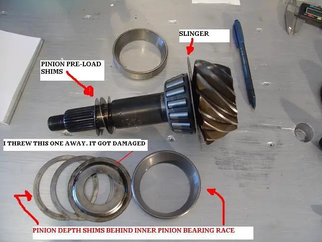

Behind the inner bearing race there was a set of shims, your pinion depth is adjusted with them.

This is the stock pinion gear.
When you take it out you will notice there is a set of shims on the spline side. These adjust your pinion bearing pre-load, which I will adress later.

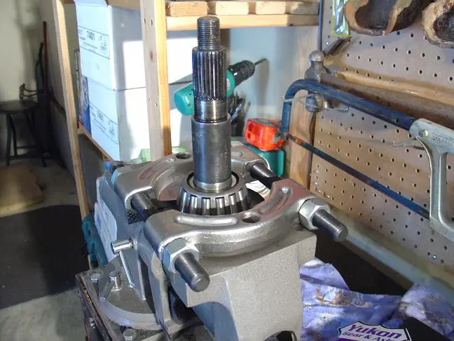

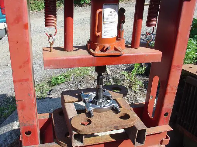

Turned out I needed that slinger, there was one in the kit but it didn`t fit. So I went back to my friend`s press and pressed the bearing off.
Here you can see the tool I`ve been using to press all bearings off..

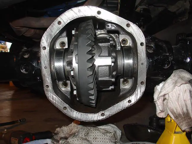

FIRST, I tried to put the carrier in the assembly to see how it fit. Turned out I had to get rid of a small shim from each side to reach my setup goal for the carrier. I only measured to find two identical shims to remove, doesn`t matter what they were, as long as it was even. You will need a rubber mallet to pound it in.
That goal is to get it seated with a certain amount of pre-load, then spin it by hand and let go, if it spins one revolution on it`s own, it is ready for setup.

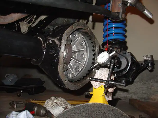

After you are happy with the carrier, pop it back out and install the pinion gear without preload shims or pinion oil seal. Just put the washer back on that was between the yoke and outer bearing, put the yoke and washer on and tighten down the bolt until you get resistance when turning the pinion.
Then install the carrier again and tighten the bearing caps down. I did it to the final torque just to be sure -60ftlbs.
The magnetic base for the dial indicator just didn`t have the strength I wanted, by an amazing stroke of luck I could thread it into one of my bolt holes.
First setup backlash measurement -zero.

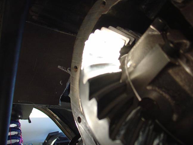

There is gear marking paste with the install kit, you brush it on your ring gear and spin th epinion while holding the carrier tight, it then shows how the contact is.
I tried to get a picture of the gear paste in action but it just doesn`t come through in pics.
This was my first attempt which told me my pinion needed to go deeper..
