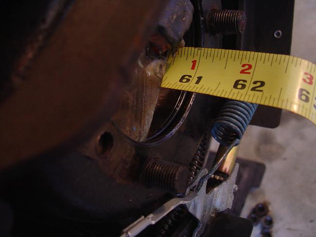

Where did you get the axles again? I don`t suppose you have any other measurements like flange to flange (housing length) or shaft length huh?
Im gonna run out in just a few and measure from flange to flange.
Flange to Flange approx 59 & 1/2"
This is close. I couldn't get the measurement 100% correct but this is really close
Thanks for that, it must be hard to measure when it`s all together.
I can get accurate with mine apart.
60 & 1/2 or 60 & 9/16, can`t decide.
