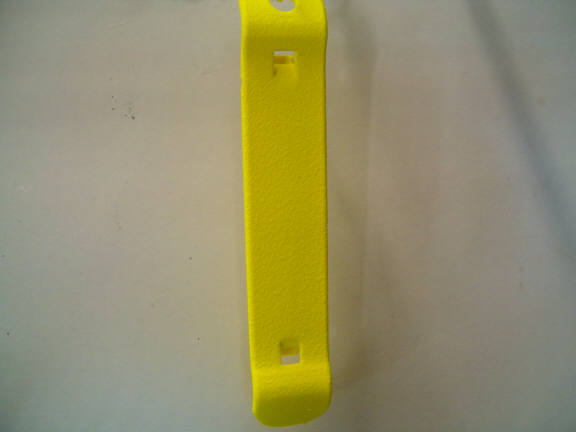

This is an attempt to hit Burns' color.
Neon yellow-first 2 pictures show powder stage-with flash and without
3 and 4 are cured-with and without flash
when it cools i'll get a sunlit picture-it is supposed to have green iridescence in light

It really looks different on the switch plate....Humm
The fourth pic in post 235 looks the closest but is not that close.
Lit by nature only-and cured sample on uncured powder--
this color is weird--
next to something yellow, it looks green.
From across the room it looks greenish-
next to something green, it looks yellow.
To be honest-I think it needs more green mixed in--
