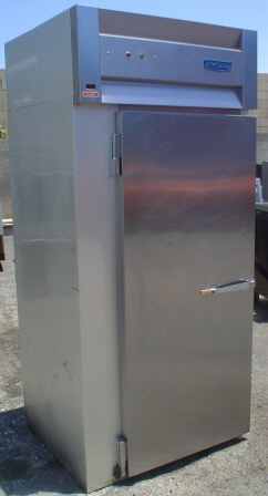

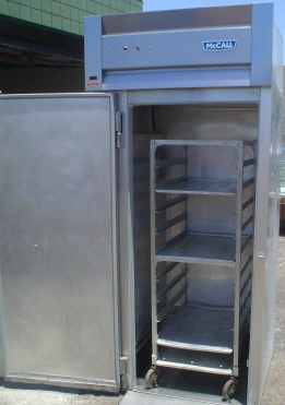

ok, for an oven, I'm looking for something like this to build off of--
it is a roll in proofer--there is a roll in refrigerator in the same guy's ebay store-shipping on it is 356 bux though--:eek:
It looks identical to the proofer from the outside--
shipping on the proofer is 293--I think it would cost quite a bit to build a box like this
At this time I am open to ideas--Maybe someone knows of an alternative?

A restaurant supply might have some used.

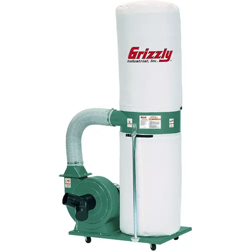

I am building my spray booth. It will be well lit, with white fiberglass walls.
I'll build holes in one wall where I can fit 2 disposable furnace filters-
for air evacuation I have this, which will be ducted to opposite wall

I got as far as pricing the materials--if I could get that proofer oven and rack for 600 shipped to me I'd be way ahead. I could then fix elements and a fan.
the fridge ended at 286 plus the freight, I think I have a shot.

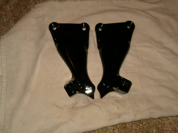

Today I custimized and powdercoated a set of Hyabusa stock rear foot peg brackets.
At the bottom, there used t be a large hoop for the tailpipe mount. He told me to take them off, and do something-
So, I cut an arc in, and ground them down to a point-I then used a sanding drum, then a flap drum to shape and polish them up.
Then a coat of back poly powdercoat, baked for 10 minutes
About 3 hours total time-

Shiny!
