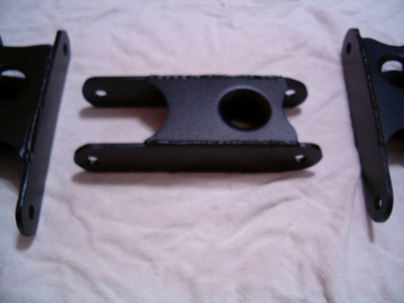

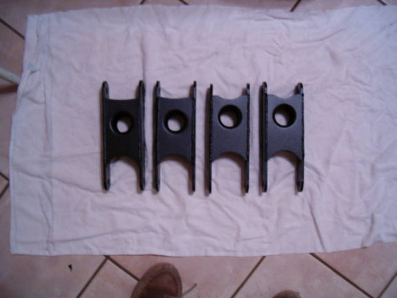

Them's some sexy shackles you have on there sis

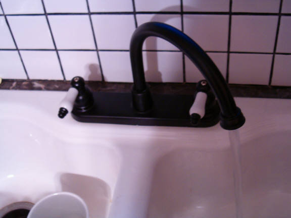

About 8 years ago, I bought a gooseneck faucet at Walmart for 30.00
As you can imagine--it sprung a leak, (months ago) and the finish is toast.
I was going to replace it--but thought --hmmmmm.
2 new o-rings and it looks up to date--:D ( well, after beadblasting and powdercoat)
I also did all of our cabinet knobs-
I blasted, hung, shot and baked 37 parts today--:p:
here is the before and after of faucet--

That faucet does fit in better with the black grout now

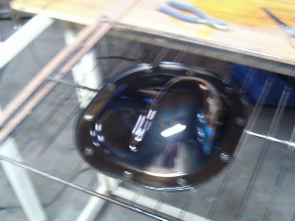

Here is the transparent black, on a used, chrome differential cover--
Sorry for the blur-I'll get new ones and edit
it's good enough to see the color--I'm ready to shoot my valve covers!
edit--grrr-
these were used as I mentioned--it seems I didn't get them cleaned well enough-there are a few freckles:(
It will look good enough under the truck--

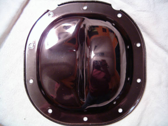

One shot showing the freckles-
another to show the actual finish quality--
I baked it-washed it, washed with windex, then polished it with acetone,
I should have baked it again, and repeated the acetone wipe--
Like I said, it was used, and I believe oil had impregnated into the metal,
