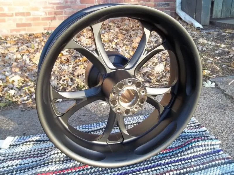

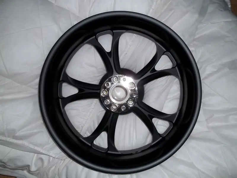

Jon, I have a newer set of polished wheels, they are not holding up well. What is exactly the process u have to go thru to get them from chrome or polished to a color? That wheel is incredible.

Considering that is a motorcycle wheel and will be used rarely, if at all, I just cleaned it very well ( 5 trips through the dishwasher, and 5 polishings, then a final heat bake and polish) and went right over the chrome, ( not ruining the wheel at all) so that if he gets tired of the black, the wheel can be dipped in a solution which will make the powder come off like a rubber glove.
For a daily driven vehicle I would need to media blast and wash them, and if you want a show quality finish some filler might be needed. However, I must say most blemishes will be covered by the powder very well.

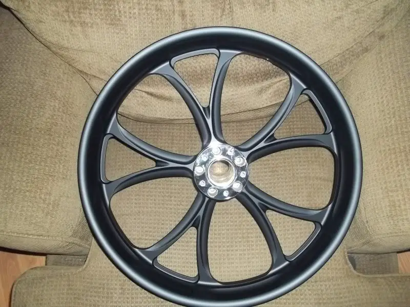

I took a pic of the Matte Black wheel in sunlight and just had to post it. I think the black brings out more detail than the chrome ever could.

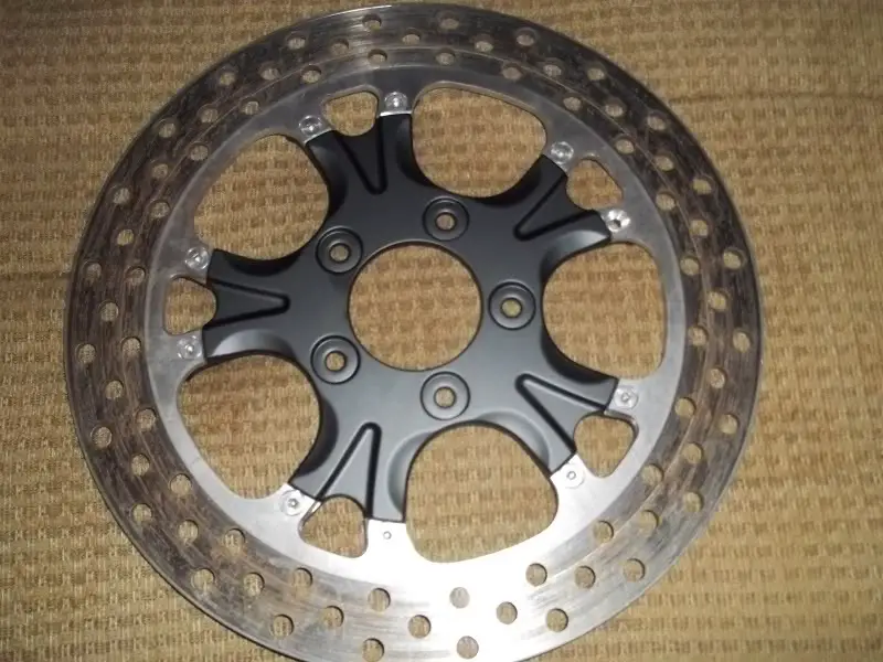

I took this disc brake apart to powdercoat the hub, But I broke one of the bolts going back together.
It for the front sister wheel pictured earlier-man this thing is huge

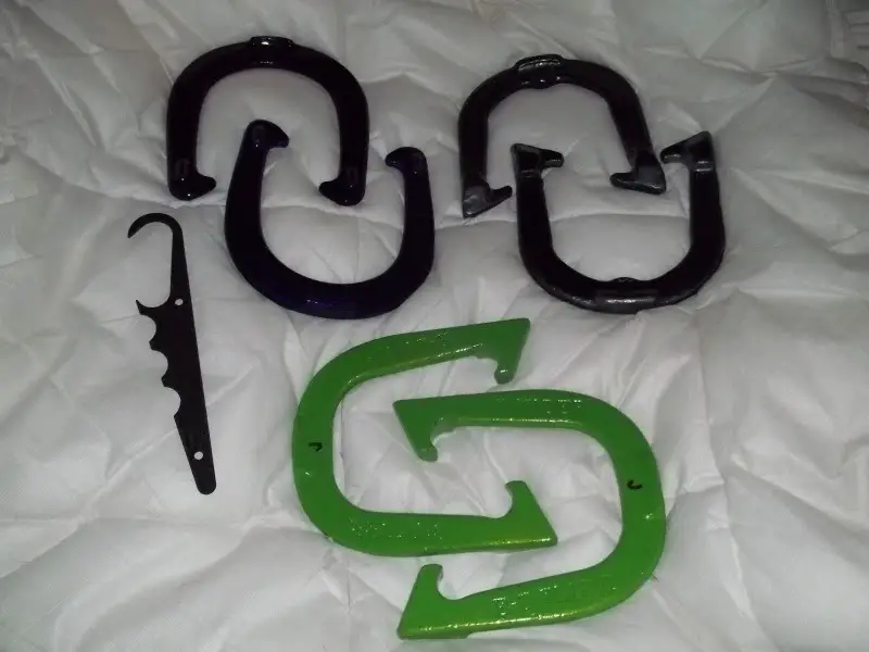

Anywho--here are some vroom vroom looking parts for blueka's pickle wagon
