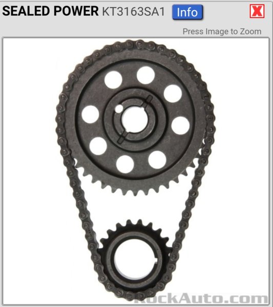

The computer controls the spark timing, but if the computer does not have the exact location of both the crank and camshaft, the spark timing will be way off, even a little bit, say...10 degrees ATD will make it run baaad.

If the timing was off you'd be getting a cam sensor code for sure. My bet is some propane and no fan wash will find t vacuum leak.
I think so, but wouldn't swear to it given that the battery was disconnected while pulling the lower intake for the pushrod swap. It may not have accumulated 25 miles before or after. All that said, it behaves like it's running extremely rich rather than lean. O2's indicate a rich condition, and on a warm restart I have to go to WOT to clear out the cylinders before it will fire.To add it is possible to put the cam gear off a tooth but correctly time the cam sync to the crank when installing it and not have a code. It is kinda obvious to be off a tooth when installing the timing set but stuff happens.
