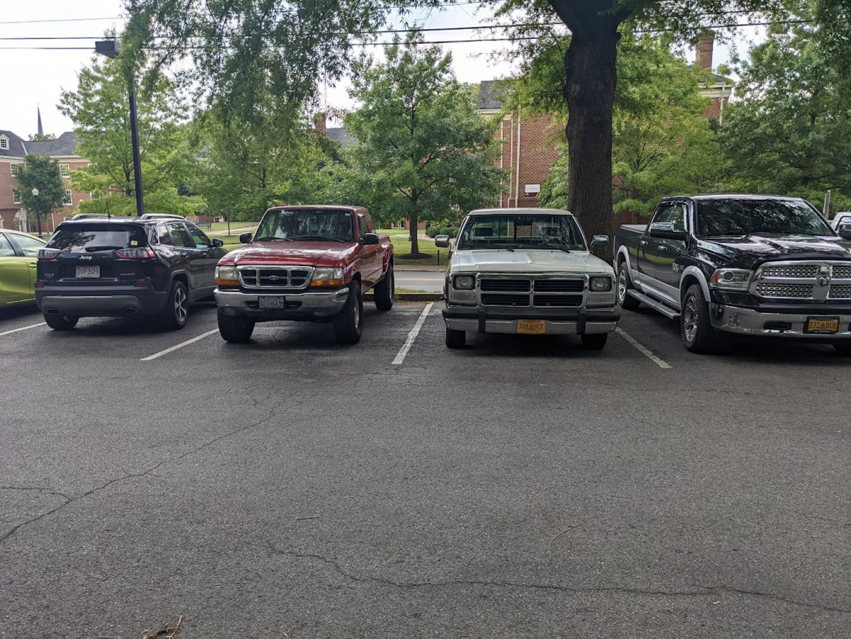

Picked it up from the shop and drove it to work with good power and cold A/C. They're hassling me a bit on the brakes, but that's pretty obviously just the rotors not wanting to bite against the pads because they've developed a bit of surface corrosion over the last few years. This weekend I should have a chance to turn or replace them. Then it gets an Explorer Sport Trac axle swap later with a Torsen for bigger brakes, etc in the rear as the next project.
Thanks for all the guidance. It's exciting to be driving it again and not staring in frustration.
