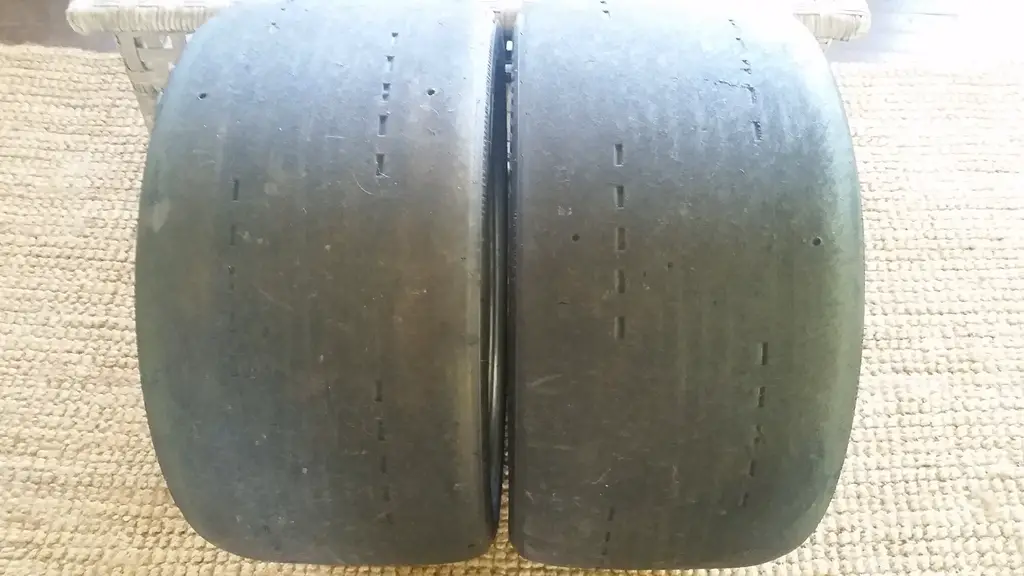

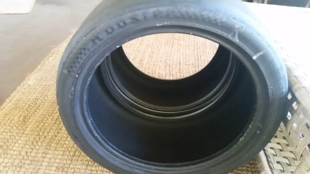

Well things got a little more serious. .picked up a set of Hoosier R7 slicks..paid $40..they are a little small at 295/30/18 but will do for now..lol
Bottom end looks real nice! Hope those tire help get you some needed traction.

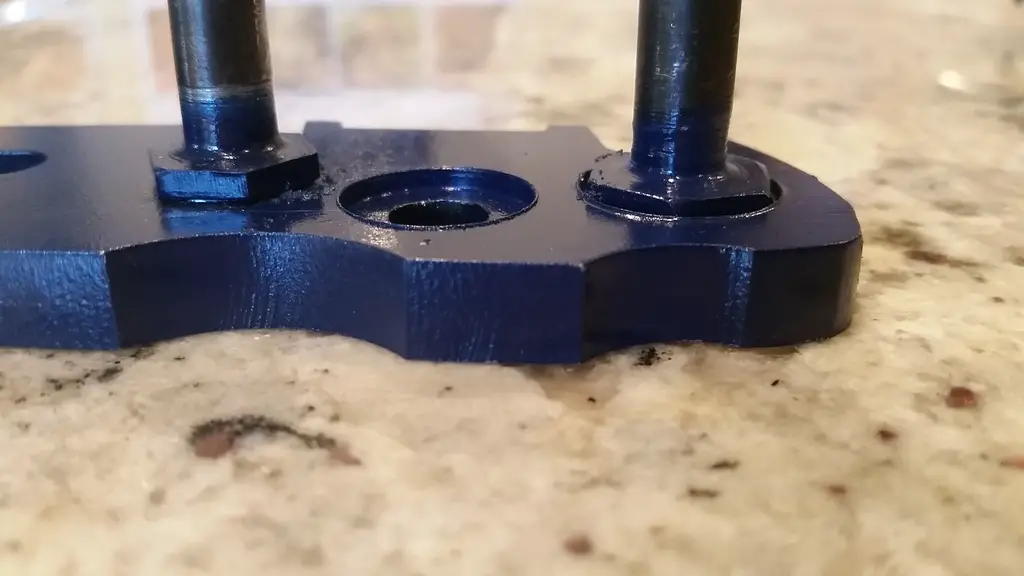

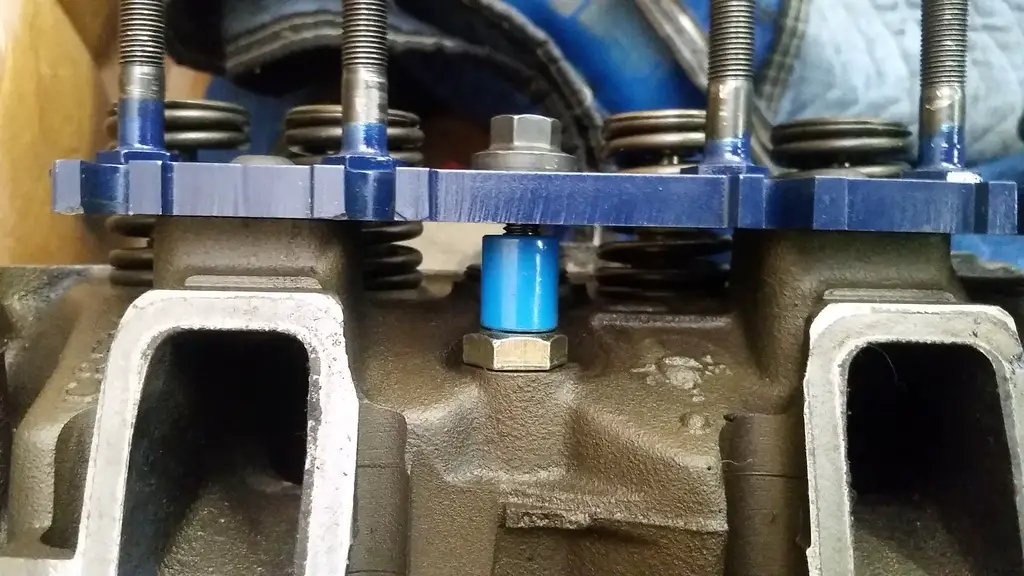

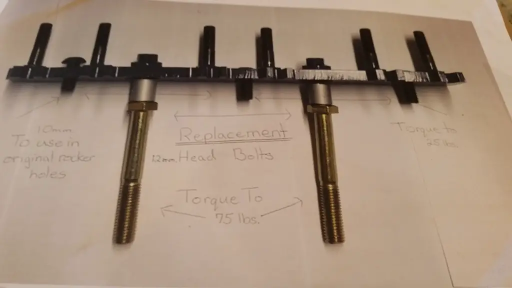

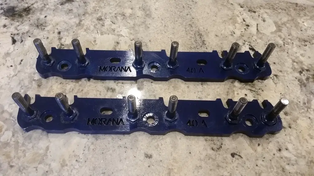

I will say im slightly concerned about his recent changes for added strength. .if you view this picture/diagram you can see he has added two bolts that hold down the cylinder head, to support his rocker mount bar..the 2 bolts are 10.9 metric bolts that have be drilled and tapped through the top of the bolt head..he said he hasnt found a ARP stud yet to use so this was his quick solution. .to me,drilling in the head of the bolt is going to weaken that bolt drastically. .im going to try and find possibly a longer 10.9 bolt to go through his support bar,the spacer and then into the head..i think that would be stronger..going to try ARP but i assume they have nothing as he said he has..
Any input on this??

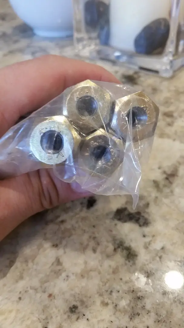

^^^^FYI these are his 10.9 head bolts that dont require replacement. .
Another thing,if you look at this picture you can see he has countersunk the last stud on this plate..dont know why but i think it would make the stud weaker as it has less thread...i emailed him asking for a reason..
Last he said his pushrods were adjustable, the ones i received are not..again i asked why..i will need adjustable ones or to measure which i pointed out before ordering. .
No word on the copper gaskets yet,machine shop still has all my parts waiting
So spoke with him..he said he tried to find a longer bolt but couldn't and swears it will be fine..
Well it would've been but the spacer he sent is too small.also the holes he drilled into the head bolts are not straight! !!haven't called him back about it because i decided to do my own thing..
So i took some measurements and called ARP..they found a bolt in the exact size i needed with a 200,000 psi rating,same as my studs..next i ordered some hardened tube(A513 DOM) with a OD-0.875" x WALL-0.188" x ID- 0.499" to make spacers..it will go through his plate,the spacers and into the head..should be much stronger..
Also received my rollers today
So as some have known I've been talking to Tom..he has told me he has a updated plate and hardware. .to send the old one back and he would replace it..well finally got a hold of him on the phone today and he is using the same thing i was going to..a larger spacer and a arp bolt to go through the plate,then spacer and into the head..so im sending my parts back today..ill update when i receive them..
