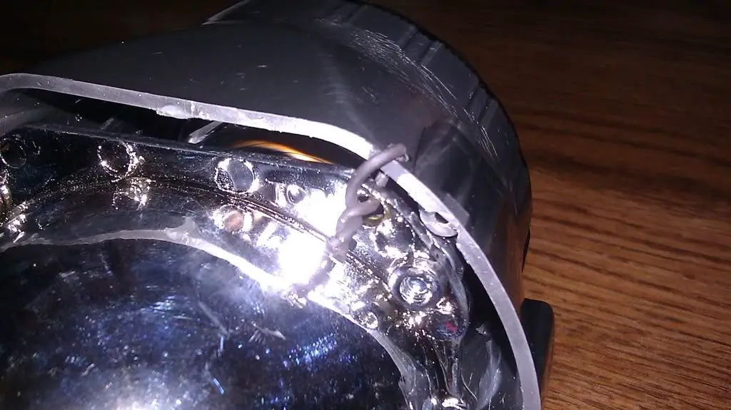

I didn't trust the rings holding them on with just silicone. So I drilled a couple small holes in the shrouds and used some bailing wire just to be sure everything stays together.
Was there a slight gap between the front glass part of the projector and the shroud once you had the should attached to the projector with the bailing wire?
What I ended up doing is silicone the black plastic rings onto the glass side of the projector. When it's dry and the housings are ready, silicone the shrouds to the plastic rings that are now on the projectors. Make sure you push them all the way on. While they are still wet, install them in the headlight with the highbeam solenoid on the bottom. Get your alignment rings in and make sure the cut-offs are level with the bottom of the headlight, and snug the nut down. Wait til it all drys, the you can take it back apart to put the bailing wire on if you want.

Got the first one together, just now read this after we got the shroud zip tied to the projector and it's def a tight fit for the shrouds into the headlight housing.

I did it a little different. The shrouds are clear because they are supposed to "light up" when the lights are on. I am guessing that is why it has such a big gap in the front of it. I removed the three little tabs on the inside of the shroud. They are really weak and come right out with just a few wiggles. This allows the projector to sit farther in, to reduce the gap at the front.
EDIT: I didn't use zip ties as I thought they might get brittle with the heat and break. Then you have broken zip ties bouncing around in your sealed headlight. Also if you have a small paint brush, you can touch up the slide marks from putting the projector in and out. But looking good so far.
