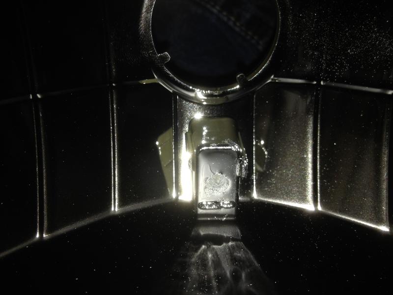

Bout to try how to figure out to get this dremel in the headlight assy hopefully without cutting something I don't want to around the little mounting platform. Bout to start on it right now. Will take pics along the way too. This is my project for today/tonight.
After I cut those pieces out, I covered the cut part with silicone. I didn't want any of the chrome part flaking off and floating around in the headlight later on.
Dremel fit in there just fine and got it cut and silicone on it, bout to cure check. Head to oreillys to get that aluminum engine paint for the shrouds.
