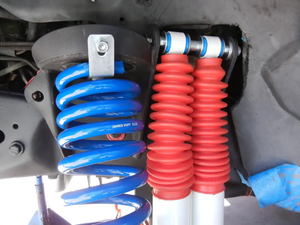

I have been working on and off this past week, due mostly to overtime at the place of business. I think I finally have some progress worth posting! For starters, I got the two beam brackets on and bolted down. I noticed with the James Duff Kit, there is an extra hole that needs to be drilled on the passenger side of the frame, so I have included a picture of that. Not a big deal, just something I didn't expect.

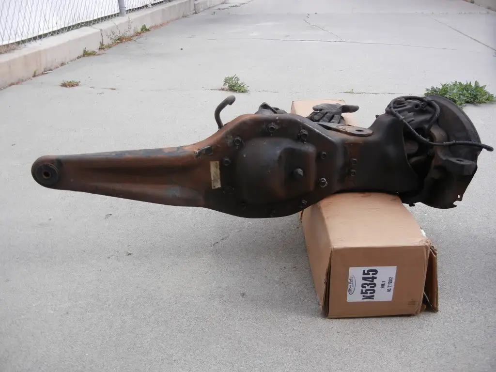

...And the other project has been rust related. I know, you guys probably could have guessed. On the flip side I think it is going to turn out well, although, I'm looking forward to taking the whole thing apart in the future and doing it inside and out :)

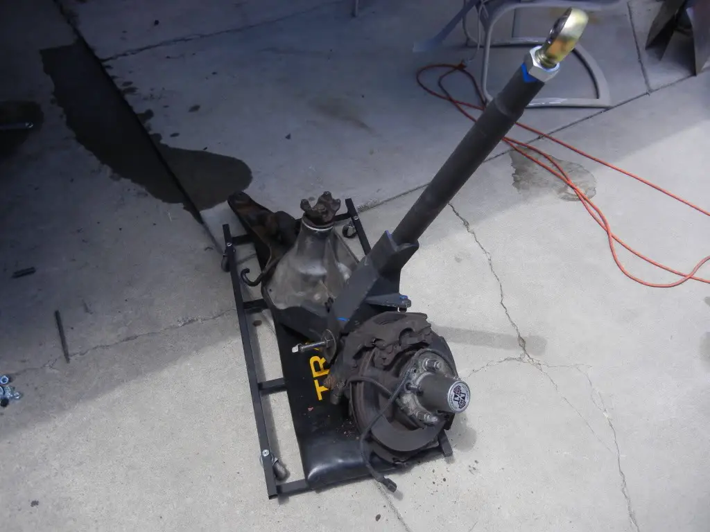

The same went for the other axle half :D
The end is nigh! Probably going to paint some sort of red design on the front diff, any suggestions? Thanks Again!

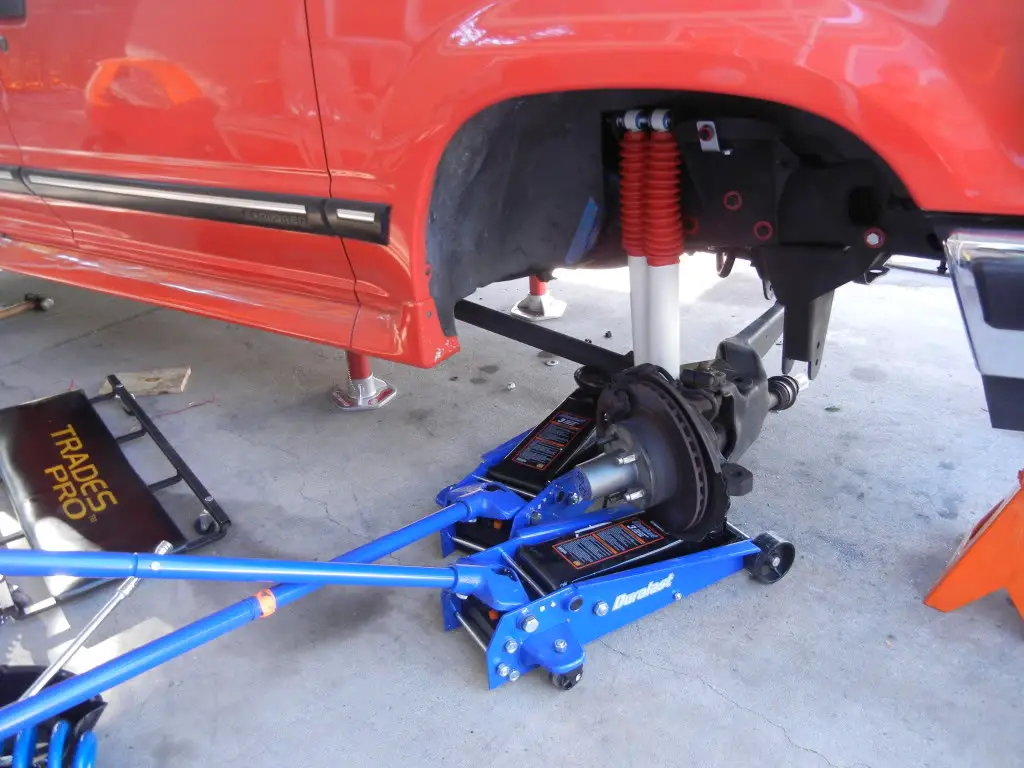

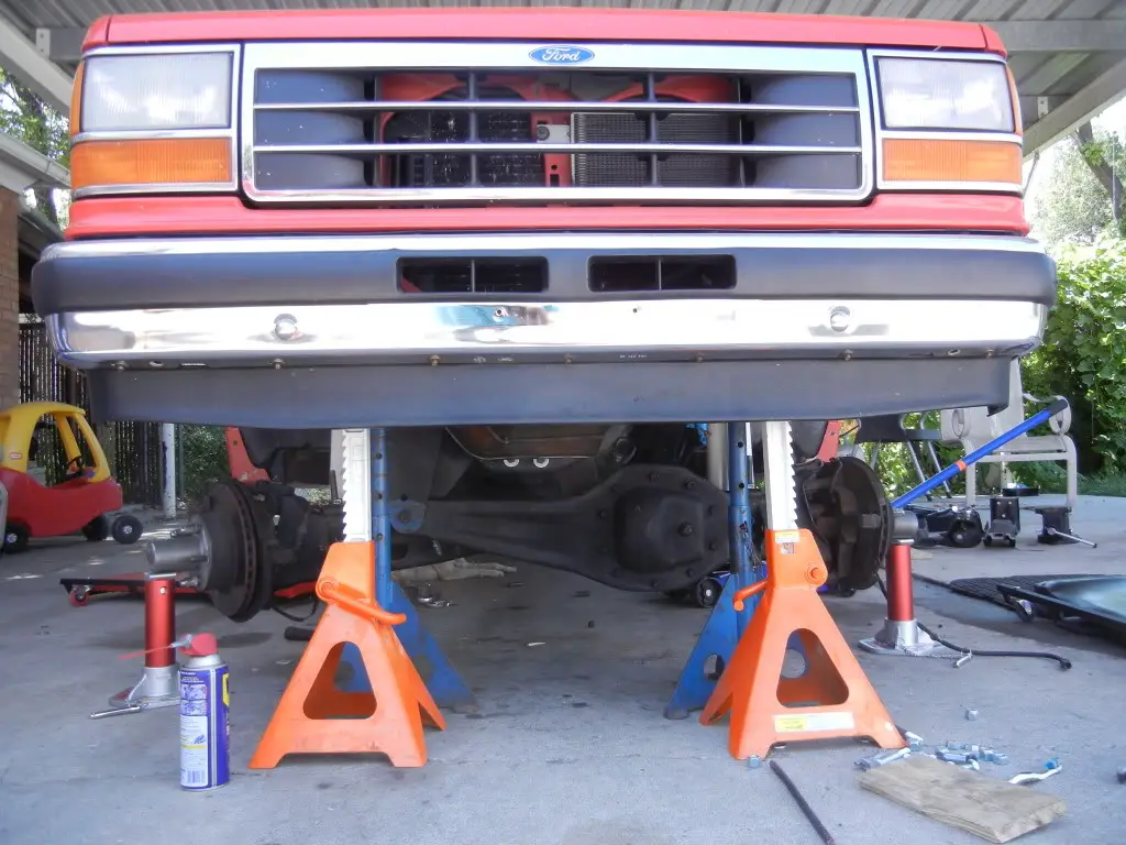

Ok, so I plan on putting the front axle back on today. I just finished torquing down everything and got the upper shock mounts all squared away!
My only question is how far do I thread the coil into the bucket? 90 degrees past the front tab? Any ideas?

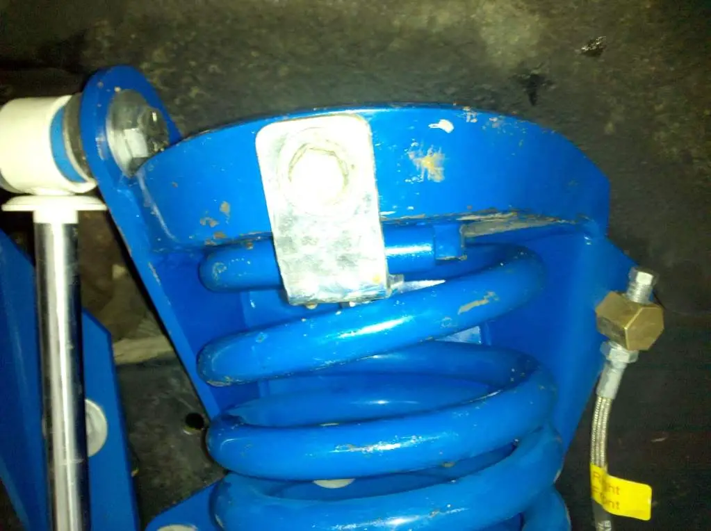

Hey Naasau, I wish I had the style of bucket you have! It seems much more straight forward (in other words) bone head proof! With these I'm really not too sure... It would seem as though it only 'fits' or 'seats' well after passing the retaining tab by an inch or two. I also found this picture while searching the forum of the James Duff Lift as they were developing the lift. (as seen in this link http://www.explorerforum.com/forums/showthread.php?t=265477)
What do you think? I'm leaning towards maybe just driving it a little with the coil seated similar to ThatFabGuy's arrangement and modifying as need be. Weird huh? What are your thoughts?
I looked through Fab Guy's pics again and it looks like you've got it right. I would say rotate the upper spring so that the top coil loop lays flush with that flat inner piece (to see if you can maximize the grip of the retainer clip).

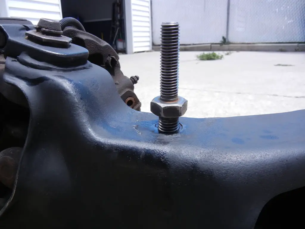

Then I proceeded to pull a royal screwup! Since I had help to torque down the 1" bolts that hold the radius arms to the transmission/frame bracket and had no help today I figured I would put the axle on while everything else was hooked up... BAD IDEA!
I was alone and wanted to rush getting the axle on, again, bad idea. This resulted in the stud hole getting cross threaded @#$!!

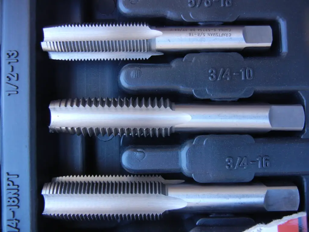

Of course everybody reading is probably thinking, "that sucks". So, this leaves getting a tap or getting a new axle half. Since I just cleaned the crap out of this axle half, and painted it, I figured I would give tapping it a go. Besides, it isn't rocket science, however, who sells a tap that big? Well, after researching and comparing I found out the tap I would need had to be 3/4 diameter WITH 10 threads per inch! For what ever reason this is a less common pitch in threading. Most taps are 16 threads per inch similar to a spark plug tap and only 1/2" at that! Auto Zone, Home Depot, Ace Hardware, and Harbor Freight did not have a tap big enough. A set here or there with 'Jumbo' taps would max out at 1/2" diameter. Finally, Sears! They carry one set that has a 3/4" tap with both 10 and 16 threads per inch. It was on sale but was still $89.99! But when you need it, you need it...
BAM!!! Got it to thread again!
After it threaded the stress just melted off of my shoulders! Now, more so because I had help at this point instead of trying to do it alone, I went ahead and detached the radius arms and mounted them BEFORE attaching the whole assembly to the truck! Definately a much better way to go about it!
