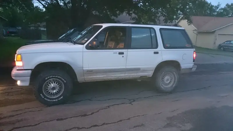

Here it is, has some great mods. I take no credit for any of the mods done on this vehicle. The guys i got it from are basically the Messiahs of Explorers. Im lucky enough to live real close to them and help them out occasionally. Im sure some of you will recognize this truck, and know who im talking about.
Ever since they brought this truck home i had been drooling over it. Not sure why but i immediately fell in love with it.
Anyways tell me what yall think. I have a 2" skyjacker lift ordered, aals came in today actually. Just waiting on the springs.
My plan is to have a few more mods done by May so i can go to Moab.
P.S. I know some of you are going to ask, but the truck has 31s on it and no lift in the pics. Fenders are cut, again i take no credit.

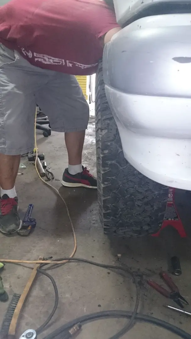

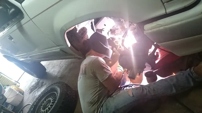

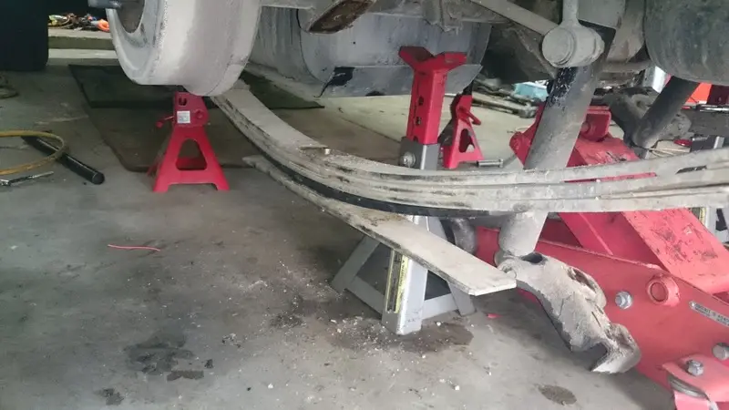

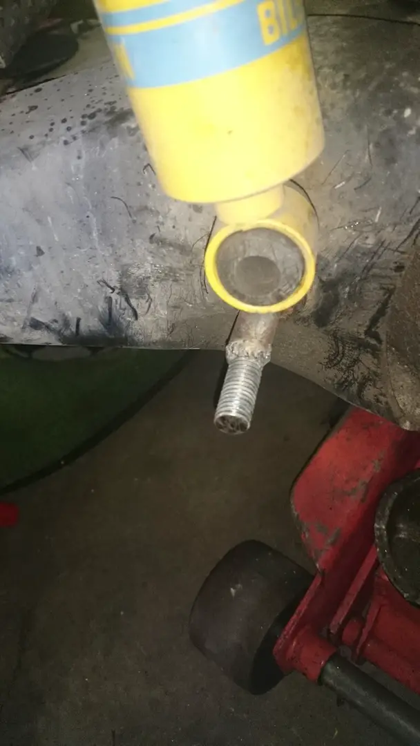

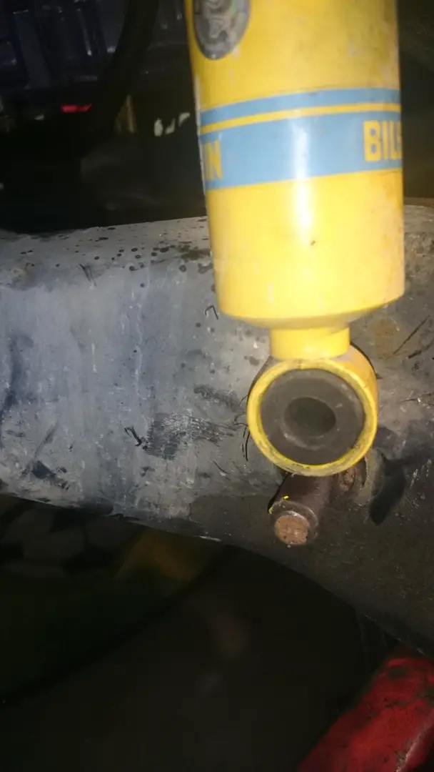

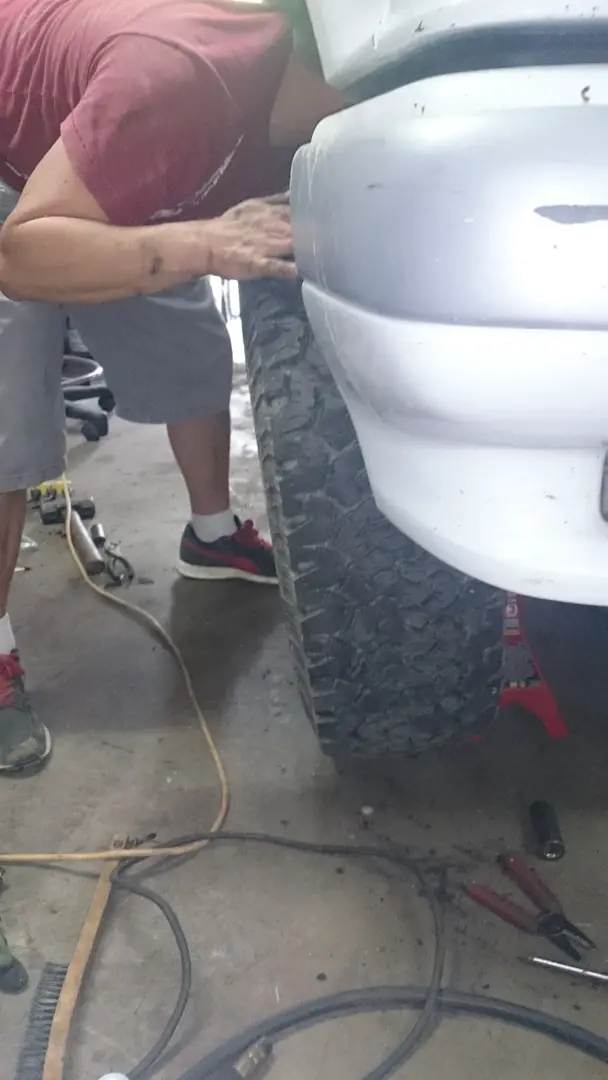

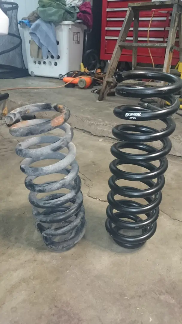

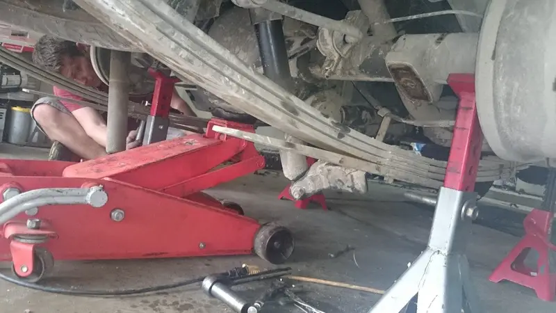

We did some work to it yesterday. Finally got around to installing my 2" lift and 1.5 add a leafs. Im very happy with how it turned out. Eventually ill probably put 32s on but for now im sticking with the 31s. Everything went smooth nothing was seized up thank god. I did have to repair a broken shock mount but that was easy. We also installed new tie rod ends. The alignment was so bad that we had to do a eyeball alignment so i could get it home. Tomorrow im taking it to the ford house to get it properly aligned. Next is probably a set of wheels, lil more aggressive stance i want. I think then ill purchase the new dog legs to get rid of the rust spot. Tell me what ya think.

That looks great. I will be getting a Lift like what you got for mine also. After doing yours does it look like 32's will fit underneath pretty good?
Ya i think 32s would fit easily, but keep in mind my front fenders are cut back a bit.

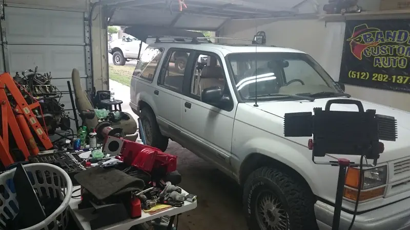

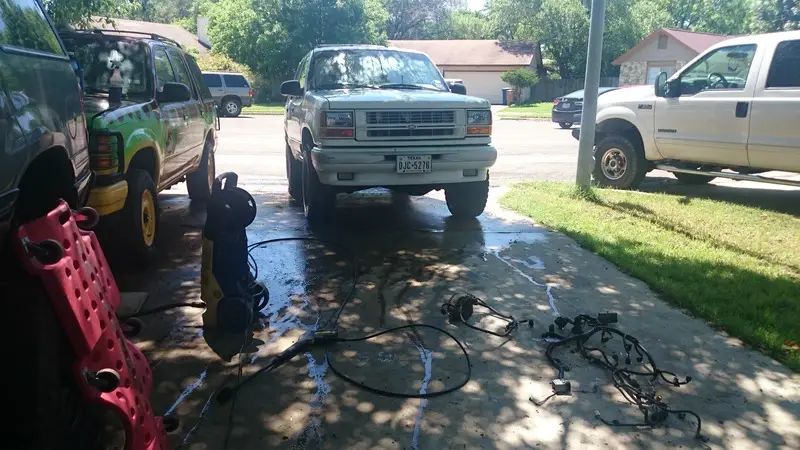

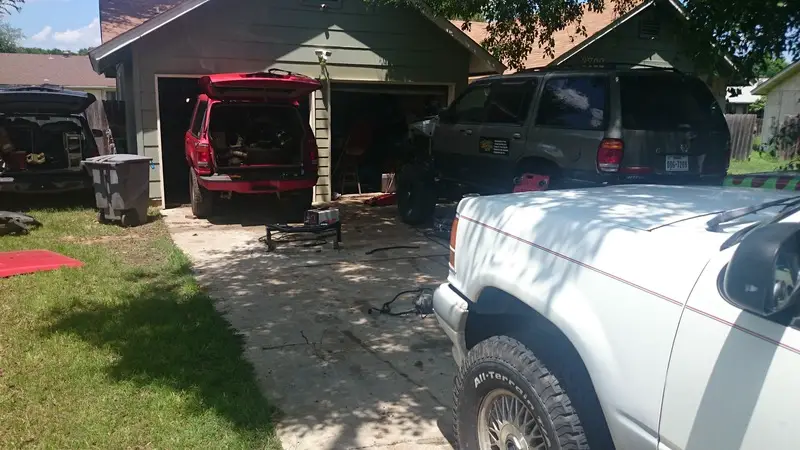

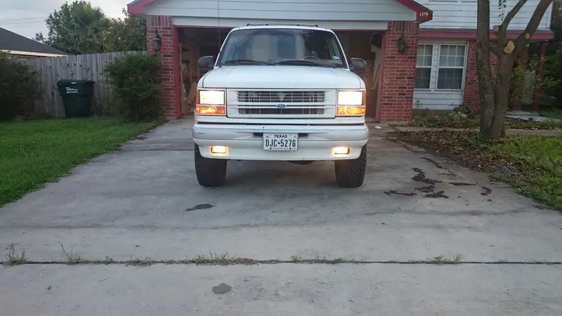

Didnt do to much to mine today. Helped with a 5.0 swap, i did however power wash all the mud off mine. Im going to order some steel wheels soon, what is a good backspace to get for a little more aggressive stance?? Also i plan on pulling off the fog lights and trying to clean up the lens a bit, kinda foggy now......
I got caught in a storm last night still didnt get the mud all off.

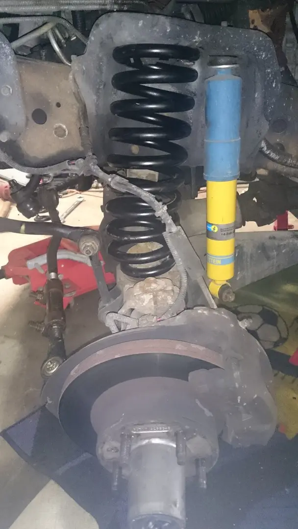

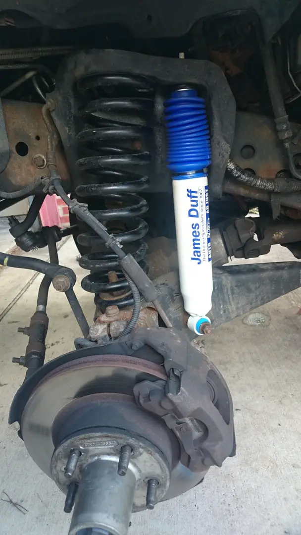

Well, i ordered some James Duff shocks today. Cant wait to get them on. I have bilsteins on the front now and stocks in the rear. Both are to short for the 2" lift. Rides kinda funny.

Well got the Duff shocks in! I did get some what frustrated with the way Duffs sends out his shocks. You need to pull the bushing out and fight the mount to get thru the bushing. Then reinstall the bushing. Luckily i have some experience in this as ive redid countless suspension bearings on motorcycles. Still a bear tho!!!
The front shocks were good just to short, the rears were originals from 93, one barely compressed, the other just felt like a spring.
I took it for a quick ride around the neighborhood. Big difference! Overall im happy with the shocks, even with the small issue.

Well i now know why you didnt replace the rear shocks LOL they are a pain! I think next is new dog legs and a set of wheels.
