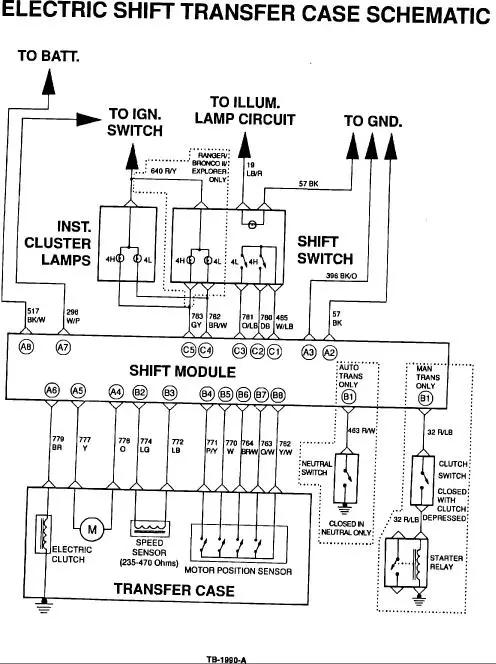

I ended up permanently grounding the red/white wire until I can get my own diagram and analyze how I want to handle it. No offense, but not knowing exactly which wires do what and getting conflicting answers I figured I'd go the safe route. It now has 4LO.

One is reverse lights and one is neutral safety switch.
