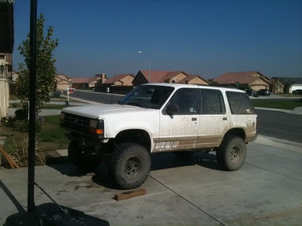

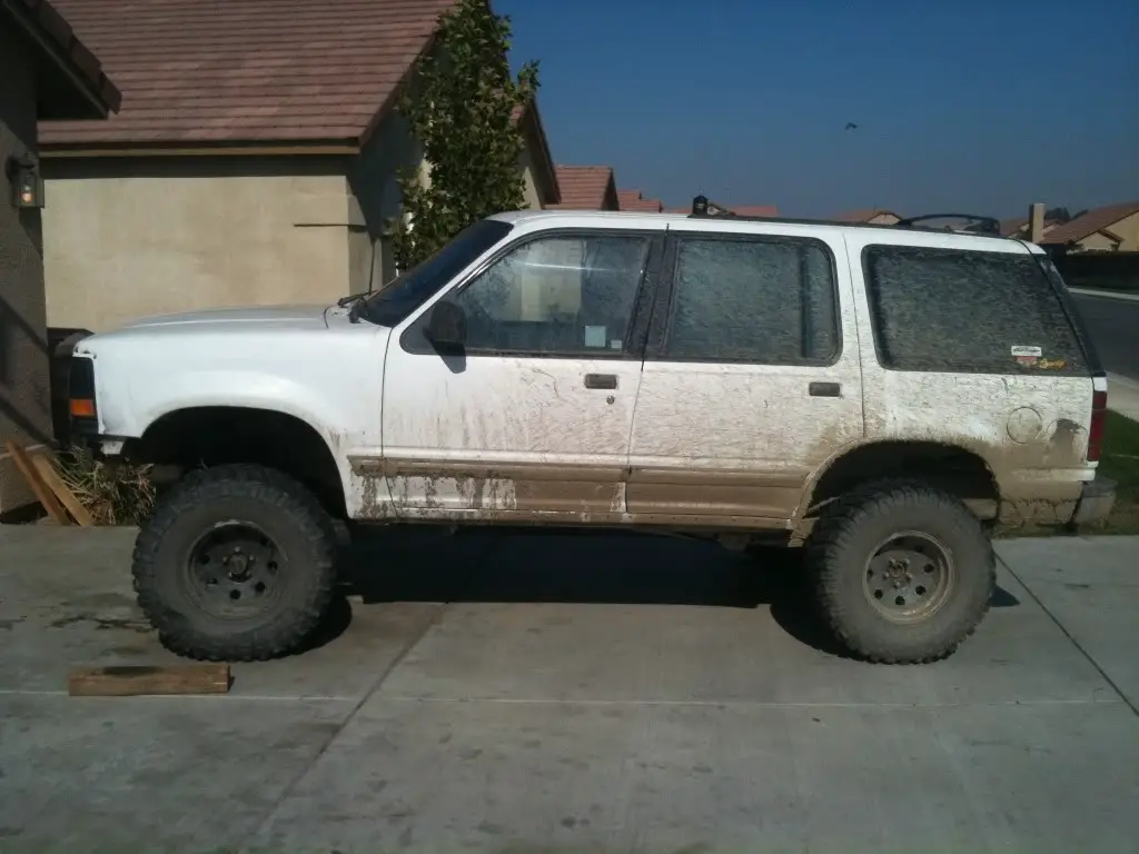

Just droppin' a quick note to say I'm not dead and neither is the Ex! I have been SWAMPED with baby stuff, which is a good thing in my opinion! I did have a chance to take it out today and get her a little dirty! I will post up some pics tomorrow if I get a chance! Also installed a push button start with kill switch. I will post some pics of it as well. Cheers friends! :salute:
Just a couple of pics of the mud... Kinda weak. Right after I blasted a couple of mud holes, I hit a huge pit of what I thought was mud, but turned out to be a monster water hole. It blasted a tidal wave of water over the Ex and hydro-locked the engine and washed off a bunch of the mud. That's why the front looks so clean! After a few (about 150) cranks, she started up again and I drove her out. I will get a couple of pics of the push button start on here soon as well.
