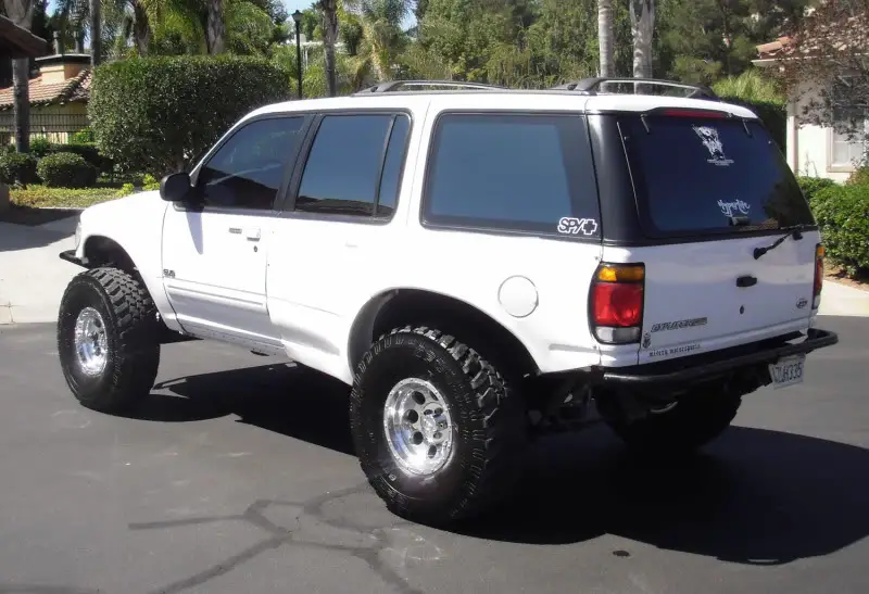

Hey guys. Ive been a member for a while but dont visit all that often usualy. I have a 1997 Explorer 2wd with the 5 liter. It has just past 100K on it milage wise and I am very happy with it.
It has a few thousand off road miles as well. I am more of a desert rat so my mods are slightly different than the trail rides I mostly see on here.
I have 3" extended control arms with dual shocks and an air bump off the UCA. I have Custom leaf springs in the rear with 12x2.5 sway-a-ways. I run 35x12.5 BFG Baja TA's and front and rear fiberglass by Fiberwerx. I also cut the factory wheel wells out and fitted a set of 38" Compettition Eng wheel tub set to allow the 35s to stuff all the way under the rear at full bump. I have modified an 01 F-150 8.8 to fit in the rear of the explorer and have a Wilwood disc brake kit as well stuffed with 4.56 gears and a Ford LSD

thats a sweet rig!
any engine mods?
did you did the suspension custom, or buy it somewhere?
i love the prerunner trucks, they look great, and that suspension style is really fun to drive with.
anyway, that explorer looks good, i like what youve done with it
That's one funky Ex you have there. Like you said, a "little different" than most. I say a lot different.
Ehhh.. You should get rid of that thing.
And sell it to me. Completely badass! :cool: :thumbsup:
Thanks guys. I really enjoy it. I have had a few "prerunner" Rangers and the last one I rolled and bought this to play with . It has been my DD up until recently.
As for engine mods I have FMS GT-40x Heads with roller rockers, and Torquemonster headers sitting in my closet waiting to redo the top end. In the truck now we built a custom exhaust all out of 3in and a custom y-pipe with a dynomax race muffler as a resongnater and a Spintech muffler. I have A KKM intake and a hypertech programmer. Eventually Ill drop a 347 stroker in it.

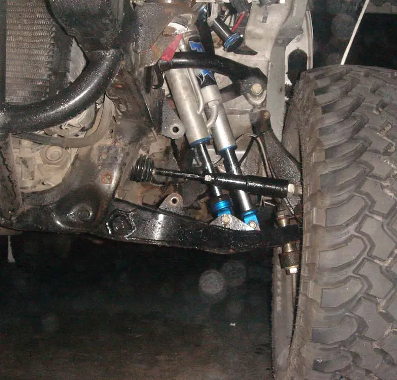

Could you post a couple of pics of the front suspension mods?
I would like to see how your UCA & LCA look with those extra shocks.

Oh and I have a couple pictures that are a little older of the front end
heres a side view of the front end. Dont mind the red strap, my battery mount broke and that was to get home, haha
Hers from the front, shows the modified LCA. The tabs are for the limit straps which are not installed in the pic.
And heres the wheel tubs I got in there to ensure no rubbing from the tires. They are raise a few inches to allow for more compression travel.
Looks great, I know all about how these things like to buck at higher speeds. Since I added my 3.0 bypasses I've been good to go in that department. I really like the wheelwell tubs. That's one of those "Shoulda woulda coulda" from my build.
