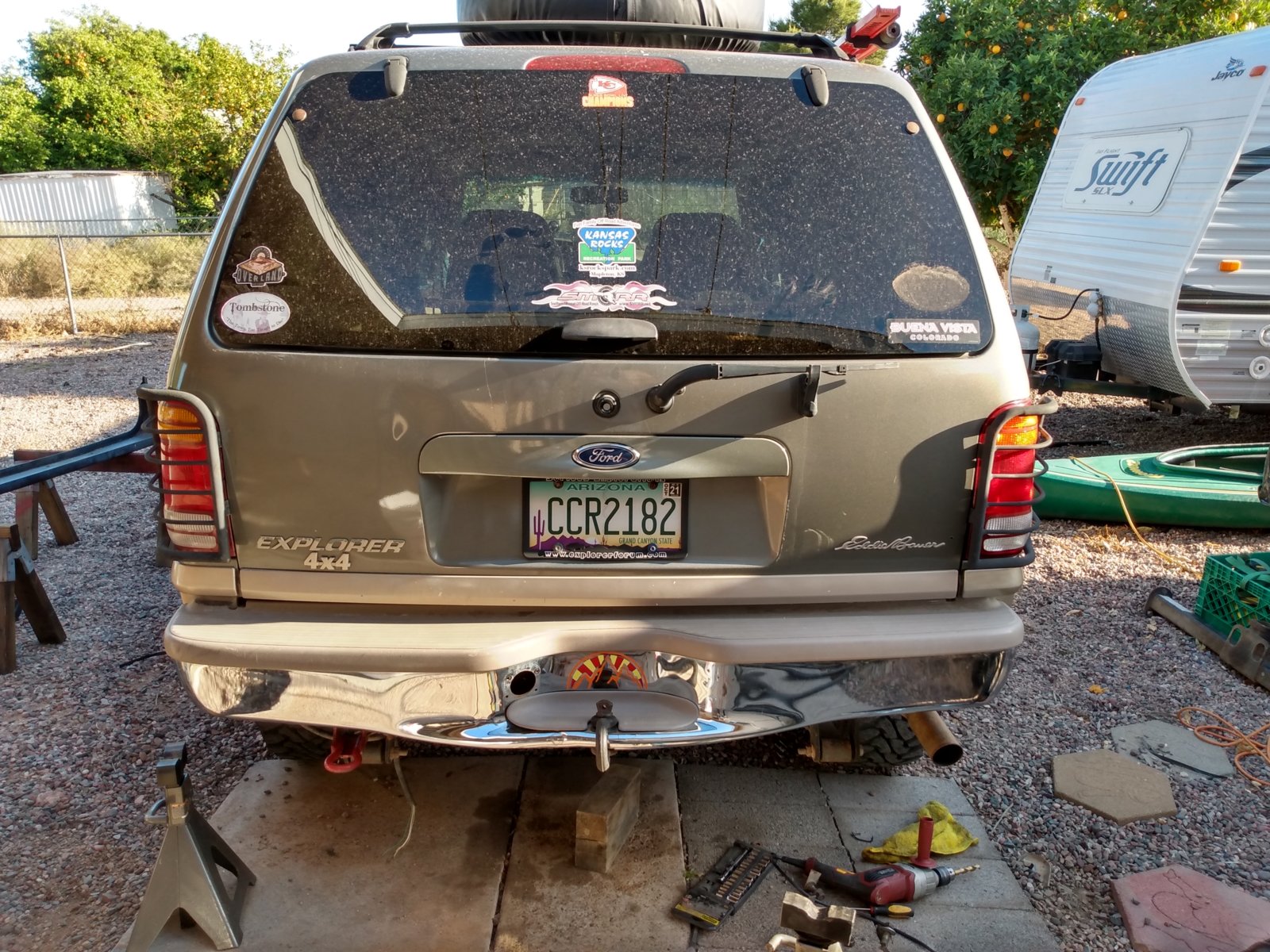

Tomorrow's project...
Mount F-150 front tow hooks to the rear of my Explorer. Always bugged that Ford made a tow hooks for the left side of the explorer but not the right. Found these at a pick a part and discovered they'll bolt right to the frame once the body lift is done. The pick you see is just a test fit using a hole already in the frame. Sadly there is only one hole, and where there should be another hole is a big rivet. So I need to move the hook 1" (app) toward the rear and drill 2 holes on each side. After the past week that'll be a cake walk!

That factory bolt hole is for the hitch.
Placing the hook to that location might bend the frame when pulled on.
Using a hitch as a tow point, is a safer option. Now that you have the body lift, you can modify a hitch bar, to fit snugly up right under the bumper.
I did that on the 94. Cut the tube off the side mounts, flipped the tube, and welded the side mounts back on.
The hitches are made to drop 3" to clear the bumper. Doing the flip, raises the tube by 6". Now it is attached to both frame rails, and is safer to pull on.
