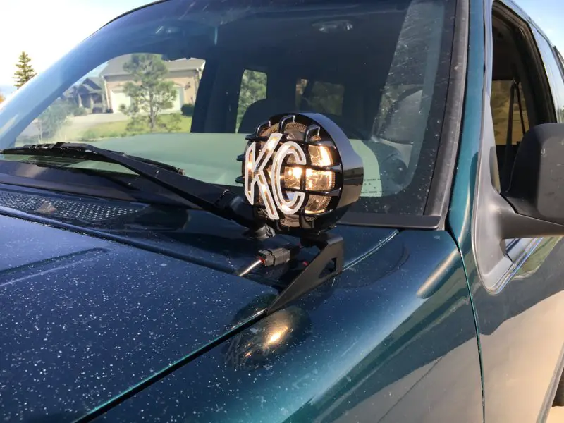

New light mounts arrived. Can't wait to mount them. Suggestions for lights. These go on the fenders near the firewall.
Went with some 140 watt LED lights from Amazon, can't remember the brand right now. They are very light and thin. Haven't wired them yet, ran out of daylight. Not sure I really like them yet, we'll see. Don't know why the side angles shots came out so dark, took all pics within a minute.
