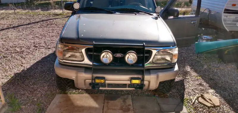

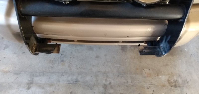

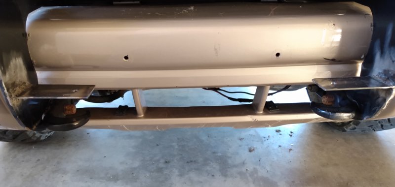

Well, since I already had the tabs cut and drilled I went ahead and used them. Needed the welding practice anyway. Here they are, unpainted, ugly welds (please ignore those) and all. Now just have to paint the tabs,and mount the lights.
Painted with lights installed

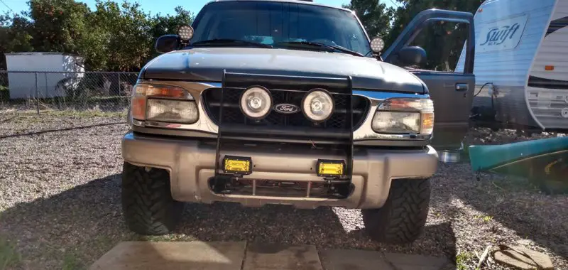

Got the fogs wired up (they were easy, just plugged them into the factory fog wiring). Now gotta do the fender mounted lights.

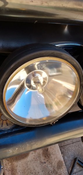

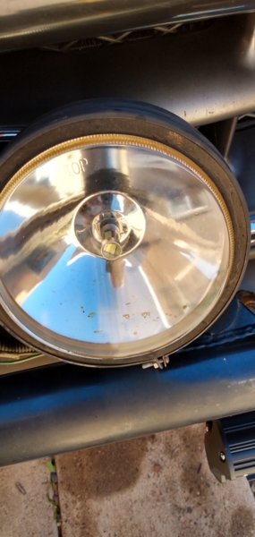

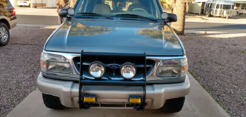

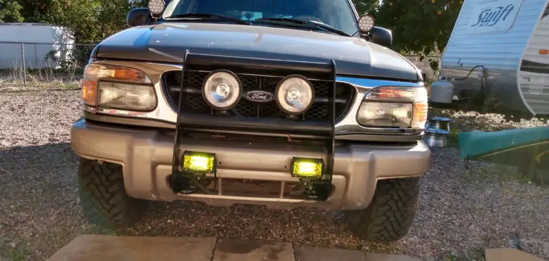

Got LED bulbs mounted in my KC HiLite (type) cans. However I also painted the grill guard and the cans. So until I can remount everything I can't test them at night to see how bright they are. Til then...
New lights...

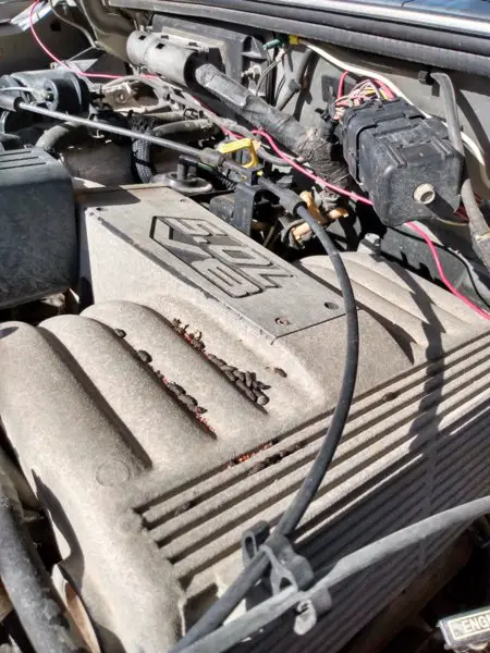

Well, because I have the Expedition the Explorer sits a lot. So when I opened the hood today to check fluids etc. I find... Droppings. 👅 Any suggestions about how to rid and protect from rodents?
You need to drive it often enough to keep animals from climbing on it. It takes many days for the normal smells etc, to dissipate enough that rodents etc, will be interested in it. Just normal driving keeps almost everything off a vehicle. But how often is a tougher question. I'd guess one good warm up engine cycle and a few miles drive, every 1-2 weeks.
If you can't drive it, then you're stuck with things like moth balls etc, which quit working in a couple of months, and have a limited effective range. I say drive it a short drive once a week.
I suppose that is the best thing to do. Maybe alternate the expedition and Explorer every week. It's just a pain to get the Explorer out of the back yard. Open the gate, drive through, stop, shut the gate, drive off.... LoL yea... My laziness is showing..
That and a solar charge led under hood light. Rodents won't nest where it's light . I keep the car's hoods open in the garage with an led shop light hanging .
Hmmm... I like the light idea... 🤔
leave your hood open
Rodents wont go under there if its open to the outside
Well, rodent problem solved, I just placed a section of 4x4 under the hood so it doesn't close completely. It lets in just enough light.
