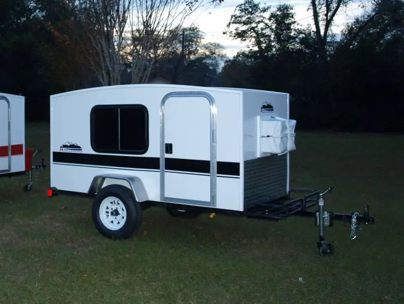

While in Florida, I came across a company that manufactures VERY small campers. As I looked at them two thoughts crossed my mind. With a little extra ground clearance (I.E. swapping the axle so its under the springs instead of over them, and larger tires) these would make pretty nice trail campers. The other thought was how easy it would be to make one on my own. :)
The name of the company is "Runaway Campers". They are currently retooling to make the campers slightly larger (6x8 on the inside I believe) to make room for a larger mattress or two smaller ones. they do have a website.
www.runawaycampers.com
I don't have anything to do with the company and I'm posting this just to let anyone out there who is looking for a small camper of another option.

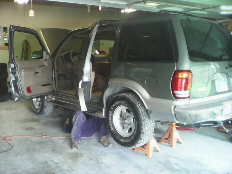

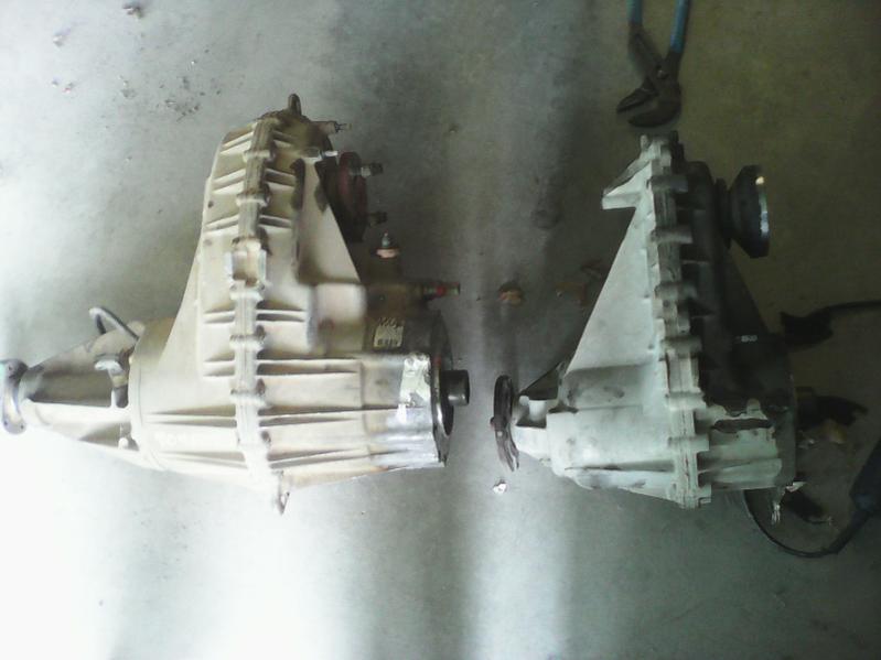

Well my explorer now has a 4x4 transfer case. Good news! Many thanks to turdle for supplying the brains and know how and to my friend and co-worker Josh for taking time to provide the muscle needed.
Now the bad news. We got everything installed only to discover that the rear driveshaft did not come with a flange to attach to the differential. I'm going to have to wait till Monday to get that remedied.

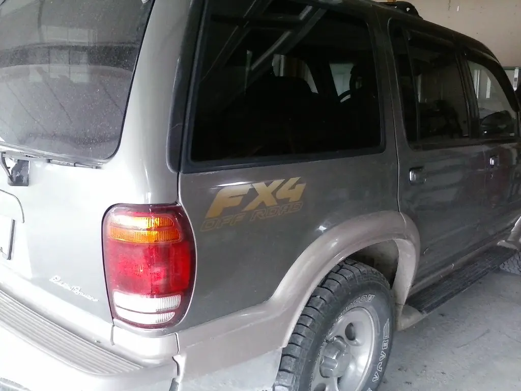

put "FX4" decals on the quarter panels, just cause I wanted to. :)
New plug, new decals....
