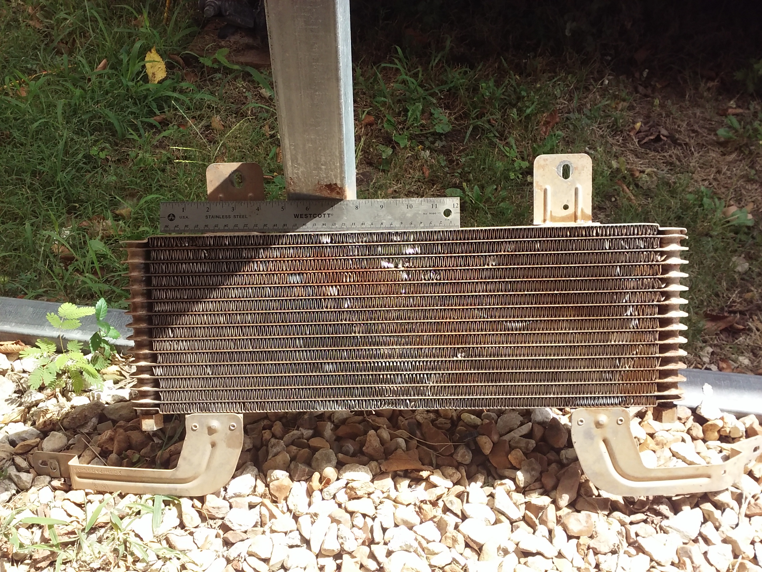

Due to the added strain of towing the camper (Not to mention my upcoming move to AZ) I decided on a larger Trans cooler. Found one (actually a couple) from an F-350 V-10 that looks like it'll work.

Instead of the ScanGauge, get an UltraGauge with the transmission temp option programmed. You can display up to 8 gauges on the UG. You can probably get the UG up and running for less than the cost of a single dial gauge and A-pillar mount.
Or get a steering console gauge for an F-150.
I have the SG and steering console gauge in my Explorer (UG is in my Expedition). The console gauge is set up to read the output of the transmission cooler and the SG is programmed to display where ever the OBDII reads it (pan? Torque converter?).
And in my opinion on the cooler, go bigger. You honestly can't have a big enough cooler. The transmission itself has a thermostat on it and won't send any fluid out until it needs to. I've been 4wheeling (slow moving) and the cooler output was about 200 degrees- the same temp as the transmission. A bigger cooler is on my list.
Thanks for the info and advice. The project is kinda on the back burner, maybe a winter project as fall is fast approaching and i won't be doing any towing or wheeling in the winter months, hence no extra cooling required till spring.

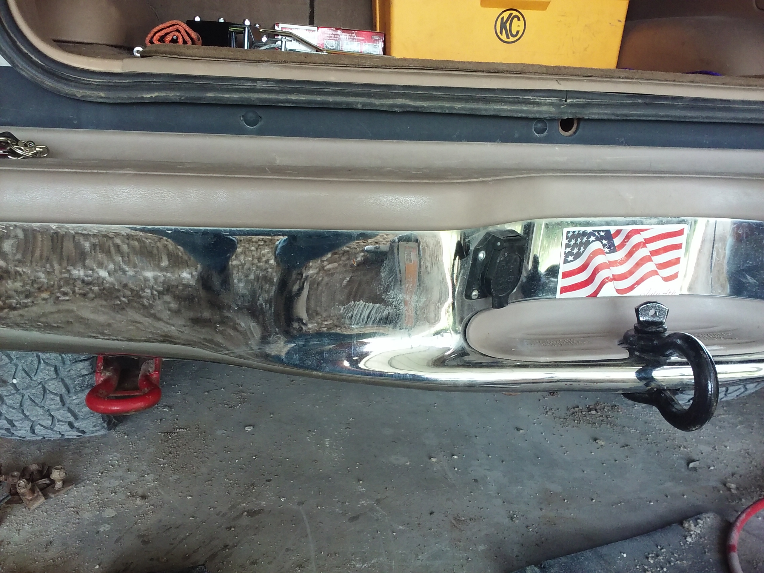

Getting ready for ksrocks this Sunday. Removed the low hanging receiver hitch, installed a factory recovery hook and put a heavy recovery hook in the bumper hitch location just for fun. When it's been cleaned the spare will go in the back cargo area.

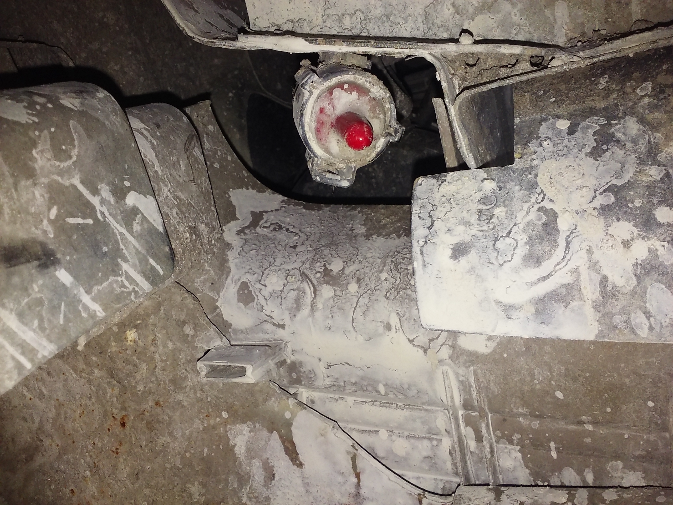

Anybody know What this is? Just noticed it while under the truck.

LoL thank you for the answer. But I believe they just installed what they needed when they installed my brake controller.
I wondered how that was utilized. For all I know they may have used it when they installed the 7-blade connector. I don't think I've checked it since then. But everything works, so I'm good! :)
Unless onen of those connectors is a backup light I can connect to and use to power some aux lights when backing to hook the camper up at night...
