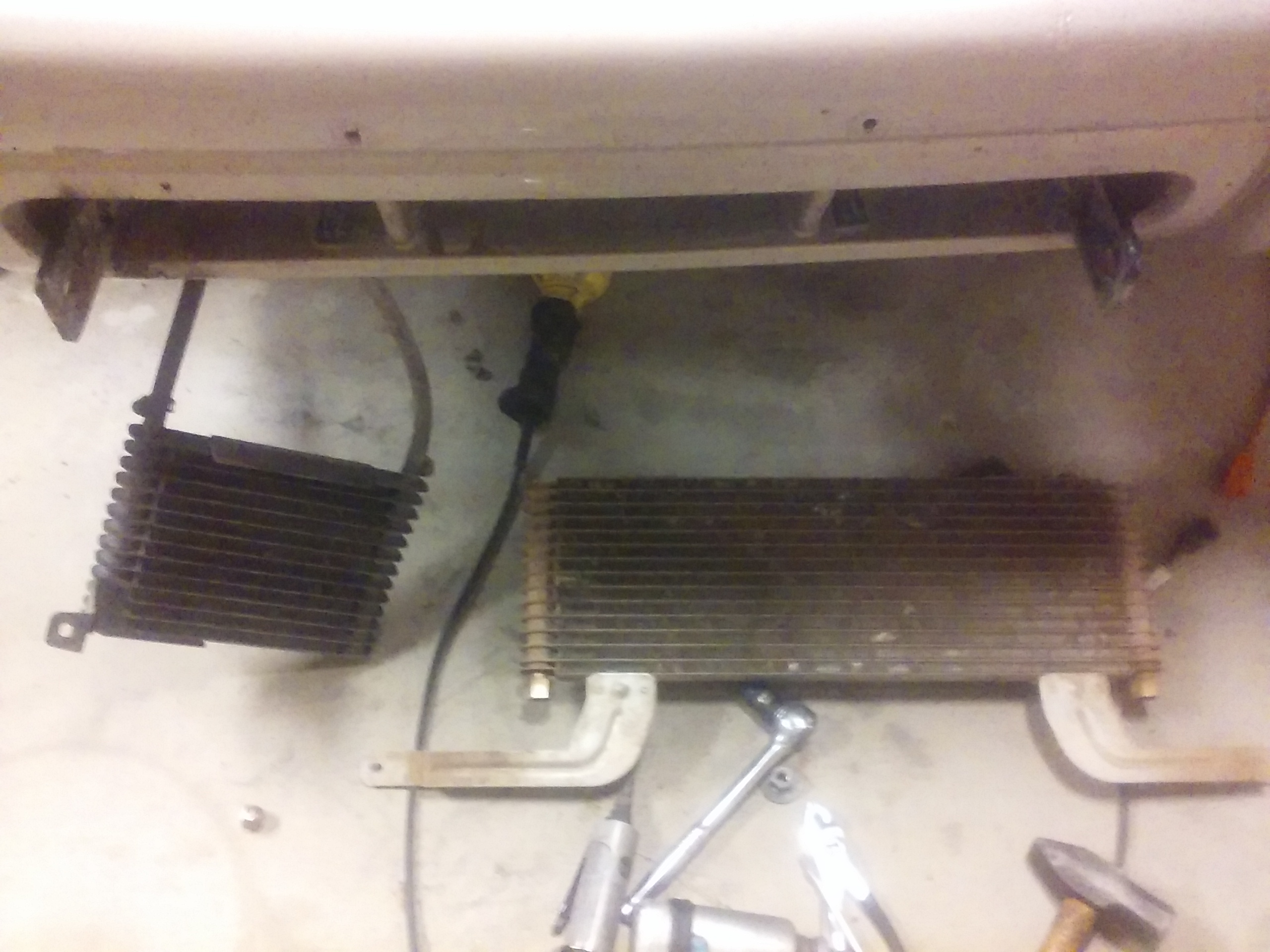

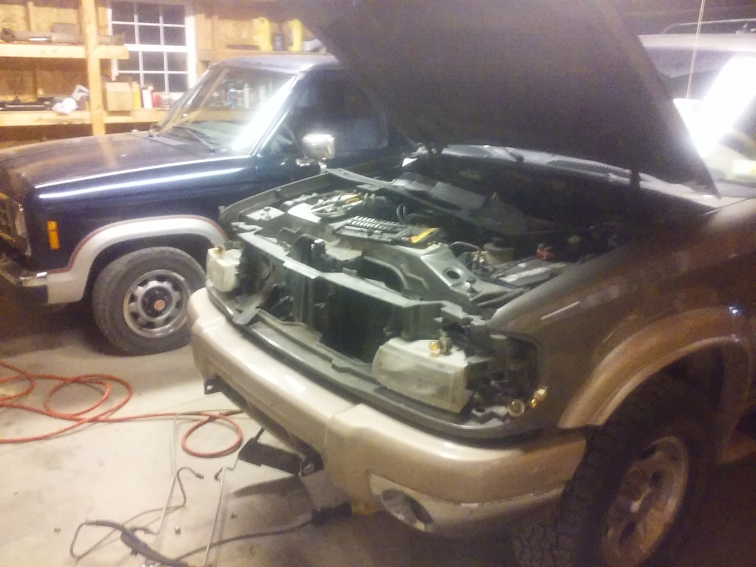

Started installation of bigger Transmission cooler tonight. Had to remove the grill guard and the grill which wasn't as big a PIA as I thought it would be. The transmission cooler was salvaged from a V10 F350. I'm sure it will get the job done. It fit beautifully right behind the bumper, hanging low enough to catch air from the vents in the bumper but not so low as to catch on anything. The cooler is installed, just not plumbed yet. I'm working on installation of the external filter now. I need to pick up some more supplies before I can continue so its a good time to break. Besides, its 1:00 am!
Poor Explorer all torn up...

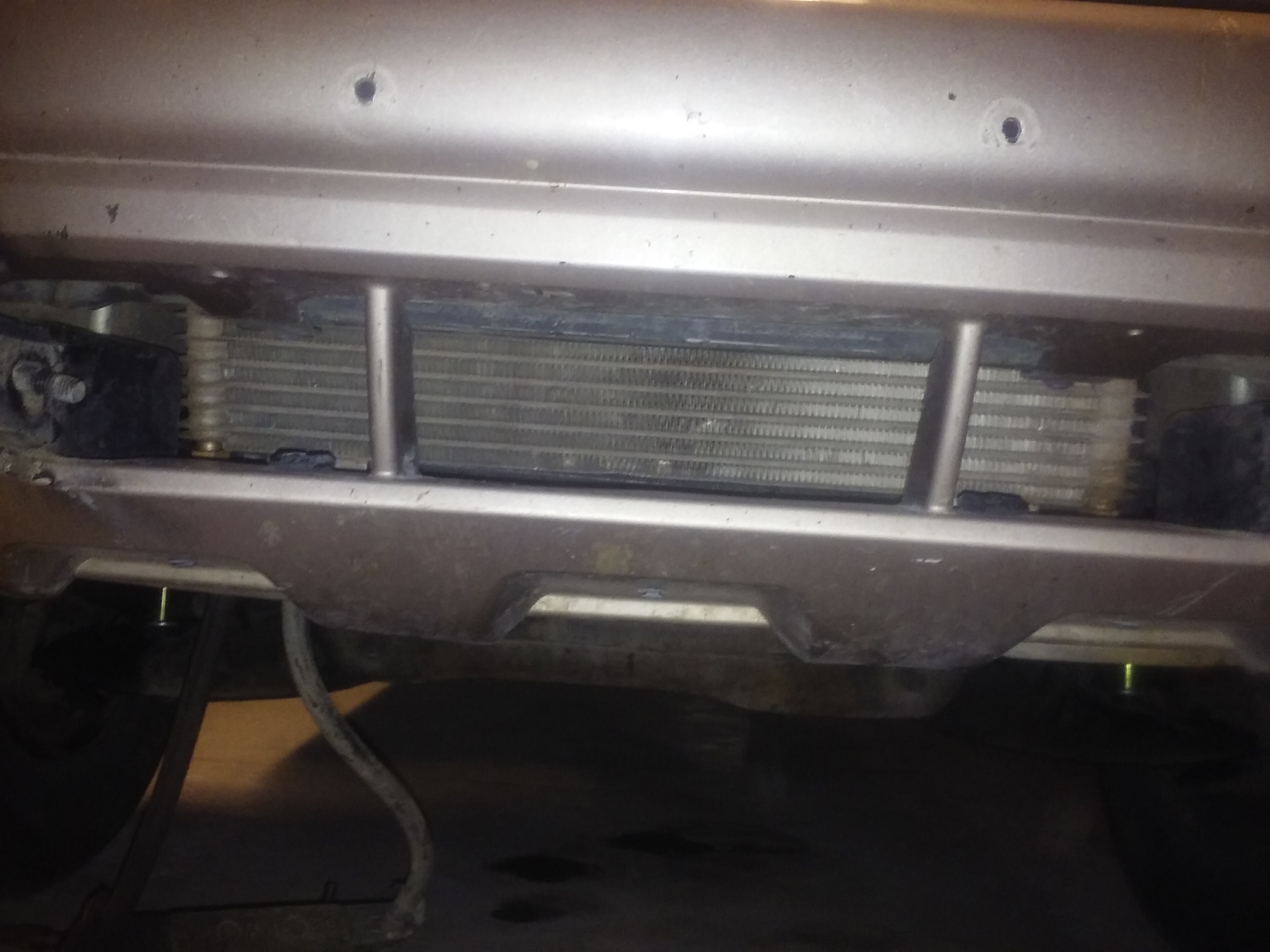

Size comparison, Old cooler on the left, new cooler on the right. I removed the "wings" used for mounting the cooler in the F350.
There are tabs on the top that when bent back work very well for mounting in the Explorer.
The cooler as seen behind the bumper

Ok, got the job done. Big transmission cooler, external transmission filter, all buttoned up.

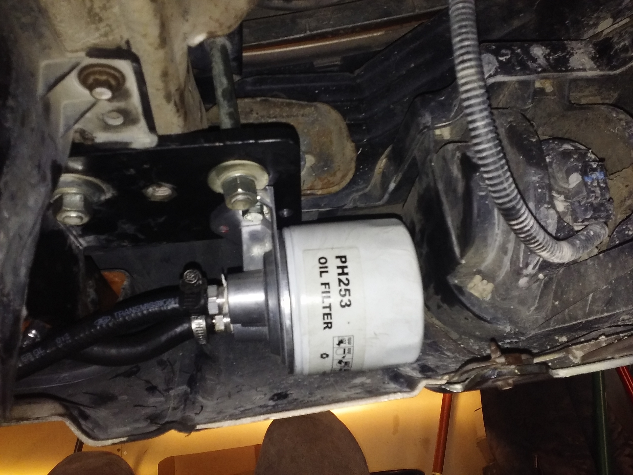

I got lucky and found a great place to put the filter by bolting it to the bracket that holds my grill guard. Its right behind (actually IN) the bumper cover, next to the fog light housing.
I have it plumbed so that the fluid goes from the transmission to the radiator, to the auxiliary cooler, to the filter then back to the transmission. I did this for two reasons, the radiator before the cooler because thats the way the factory did it. The filter between the cooler and the transmission because its a used cooler from an F-350 V10. Although I flushed it thoroughly I feel better having the filter right after it just in case there is anything left in there. Once I got all the new parts put on and plumbed I crawled under the truck and dropped the transmission pan, installed a new internal filter, and of course 5 quarts of fresh fluid. One of the hardest parts of dropping the pan and replacing the factory filter (to me) is knowing just how much fluid to replace. With oil its easy, most all of the old oil is in the pan so you put however much oil the car calls for. So I carefully collected as much of the fluid I drained (both from the lines and factory cooler up front and the pan underneath) and measured it so I I'd know how much to put into the transmission. I collected 5 quarts, so I put 5 quarts in. I am going to keep a sharp eye on it however as I did of course spill quite a bit on the floor.
Overall, I'm happy with it. I'll see what kind of transmission temps I get out in AZ. There is lots of room around the cooler so if I need to I can put a couple small fans on the cooler.
