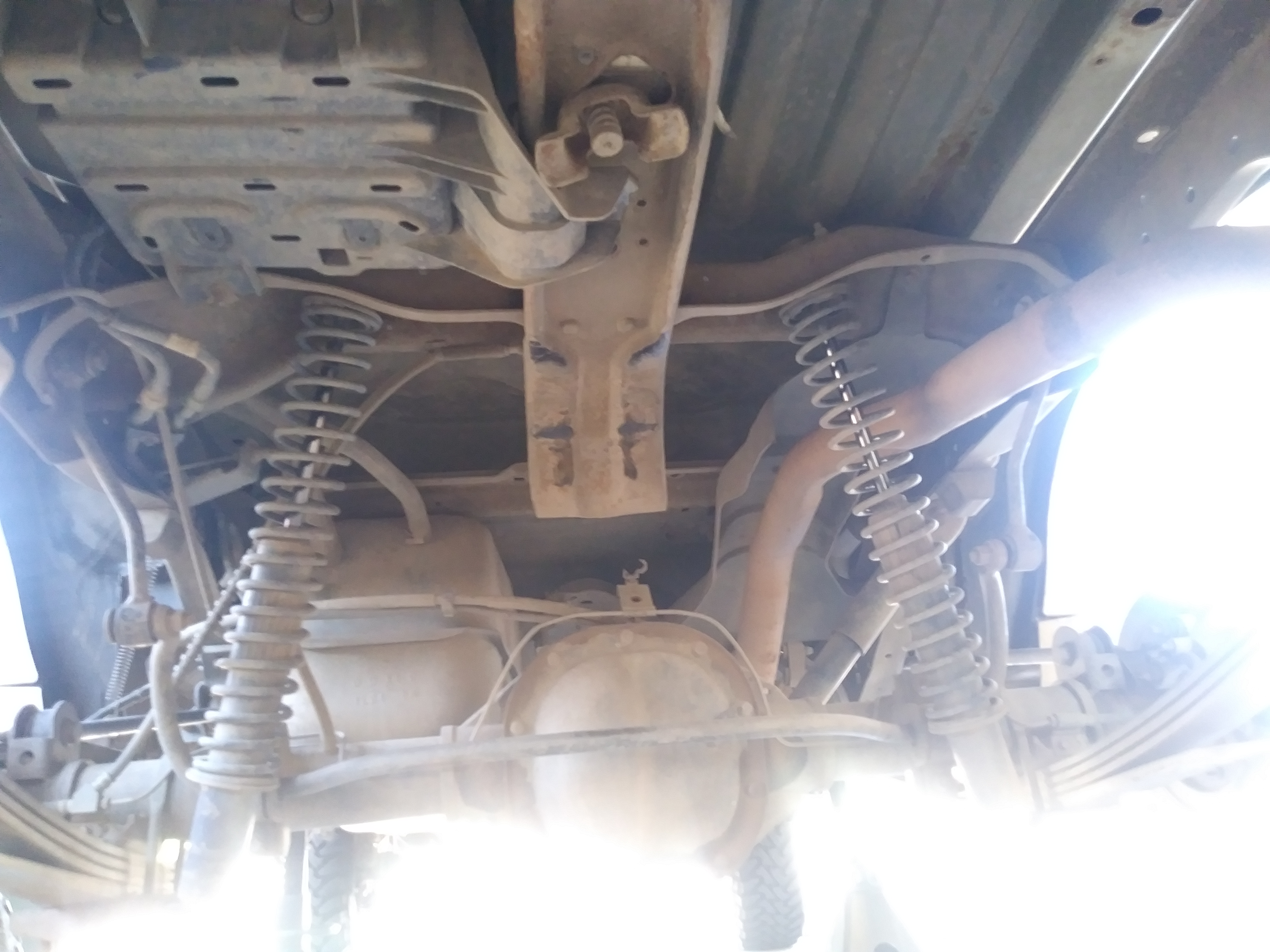

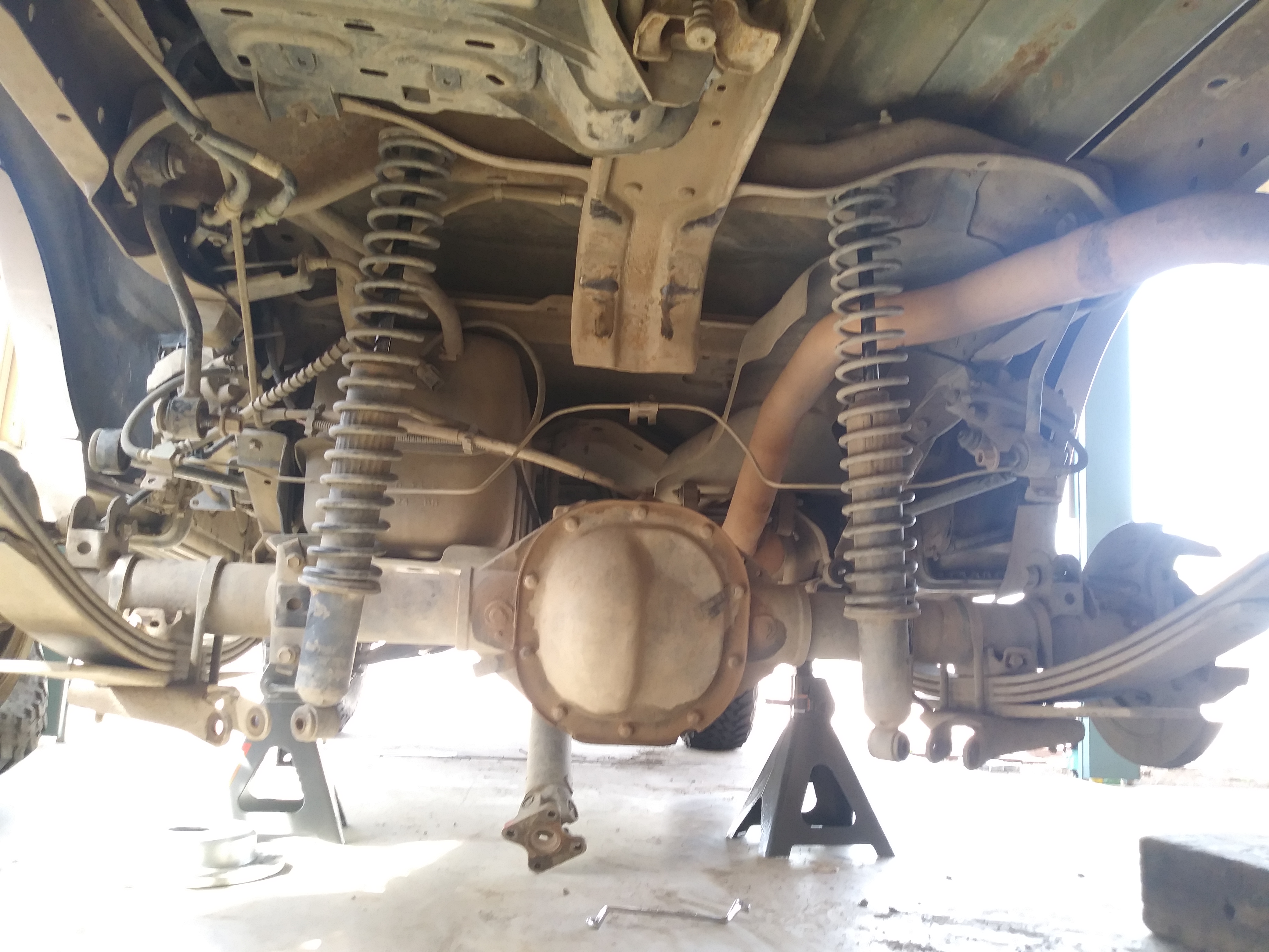

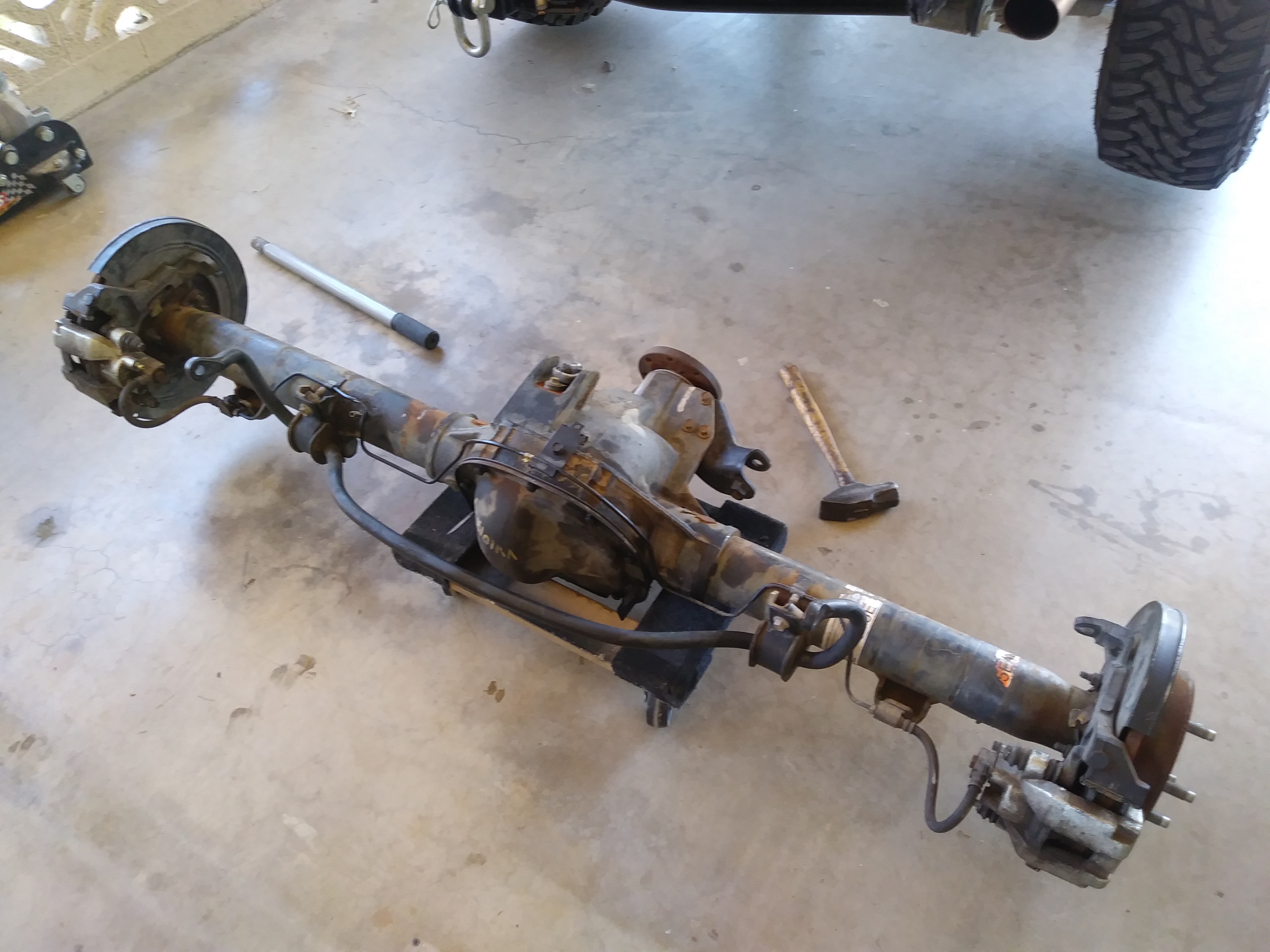

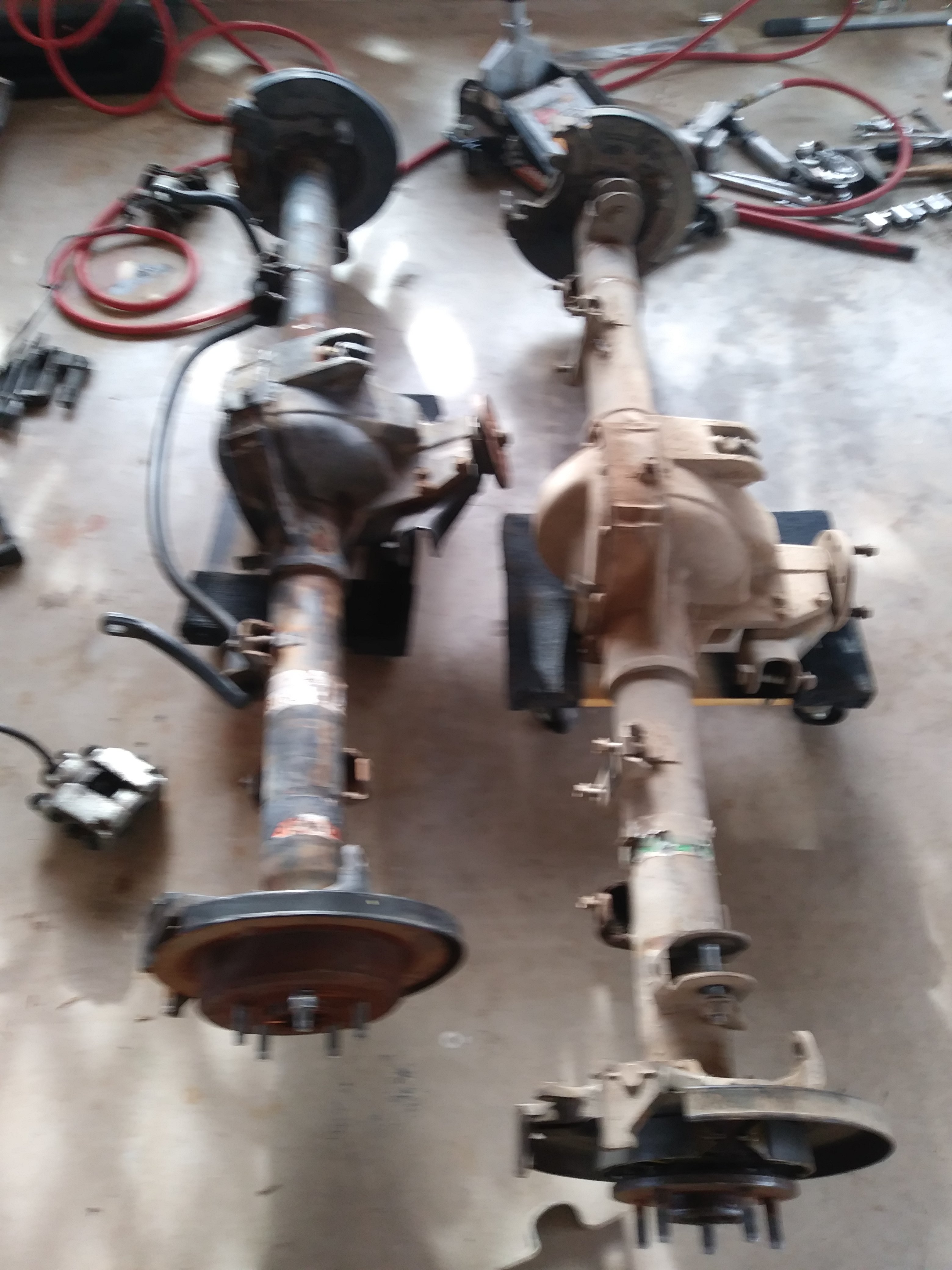

Ok, worked into the evening but got the axle swapped. Took a few pics, I might even do a write up. we'll see. Just glad to have the job done. Yes, it can be done with just one person but it sucks. Heavy lifting, climbing under the truck only to have to get out from under it for tools. Just someone to hand me tools would have saved me hours. At any rate, I can't wait to test drive it tomorrow.
A few pics.

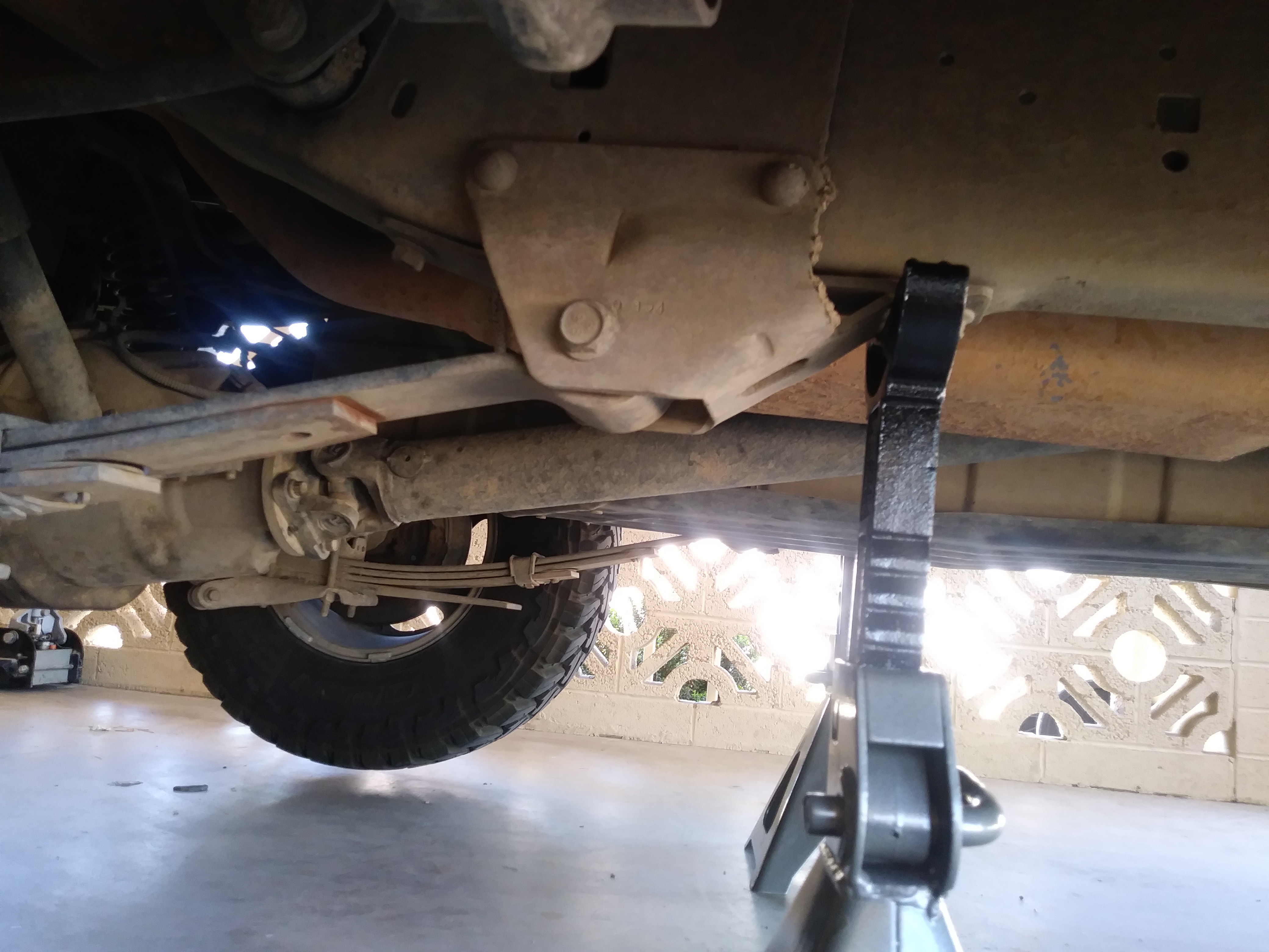

Had to buy new Jack Stands at Harbor Freight. Mine just weren't tall enough!
New Axle, ready to go in. Well almost, I need to pull the brakes off of this axle so I can continue using the new pads, and rotors I just put in. fortunately this axle has fully functioning, not worn out, freely moving Parking brakes.
Lifted, ready to begin work. Removing the spare creates all kinds of space to work under there!
Brakes are removed and hung out of the way, shocks are loosened from the axle.
Old axle on the right, new one on the left.
the installation of the new one went much better than I anticipated. I just rolled it under on a Furniture dolly (they work GREAT! the pumpkin fits in the opening in the center of the dolly and the axle won't tip, sway, or get out of control). I then used two floor jacks to raise the springs up to meet the axle, lined them up, and bolted them in place. Once the springs were reattached to the shackles, it was just a matter of reconnecting everything.
Well done, great, big job.
It sounds like not many bolts were corroded tight etc. I have one shock on my Mercury I couldn't get off, the bottom bolt/nut is seized hard.
Awesome work there. Need to get things started to collect for my build. :-) I will be looking for Axles w/ 4.10's to get under mine and getting a 4406. :-) Like watching your build though.
There were some seized bolts... Particularly the shock bolts and the U-bolt nuts. Lucky for me I have my grandfathers 1" drive ratchet. LoL its longer than my 1/2" breaker bar! That and my impact took care of any difficult jobs. But have plenty of PB blaster on hand and if possible presoak.

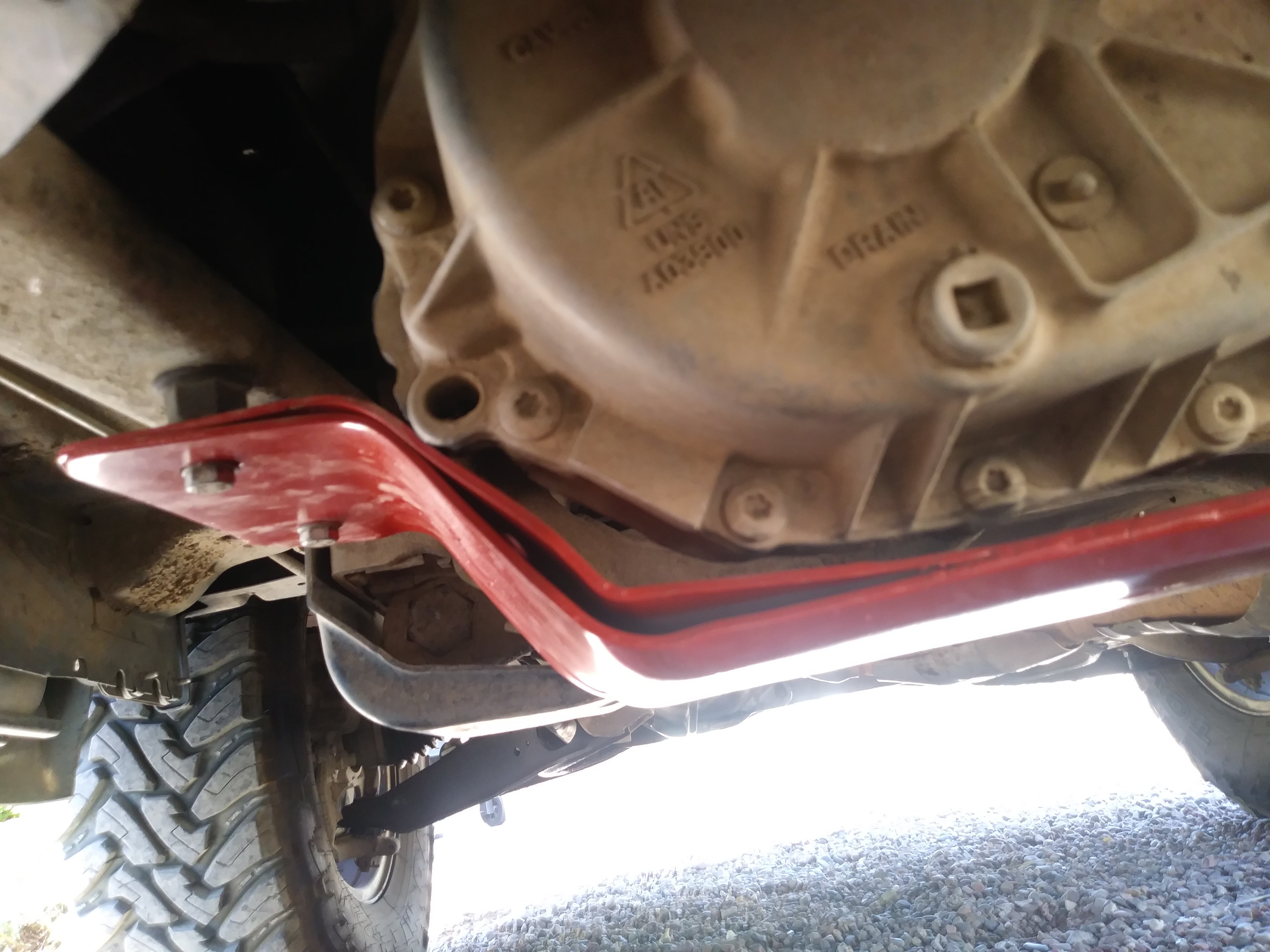

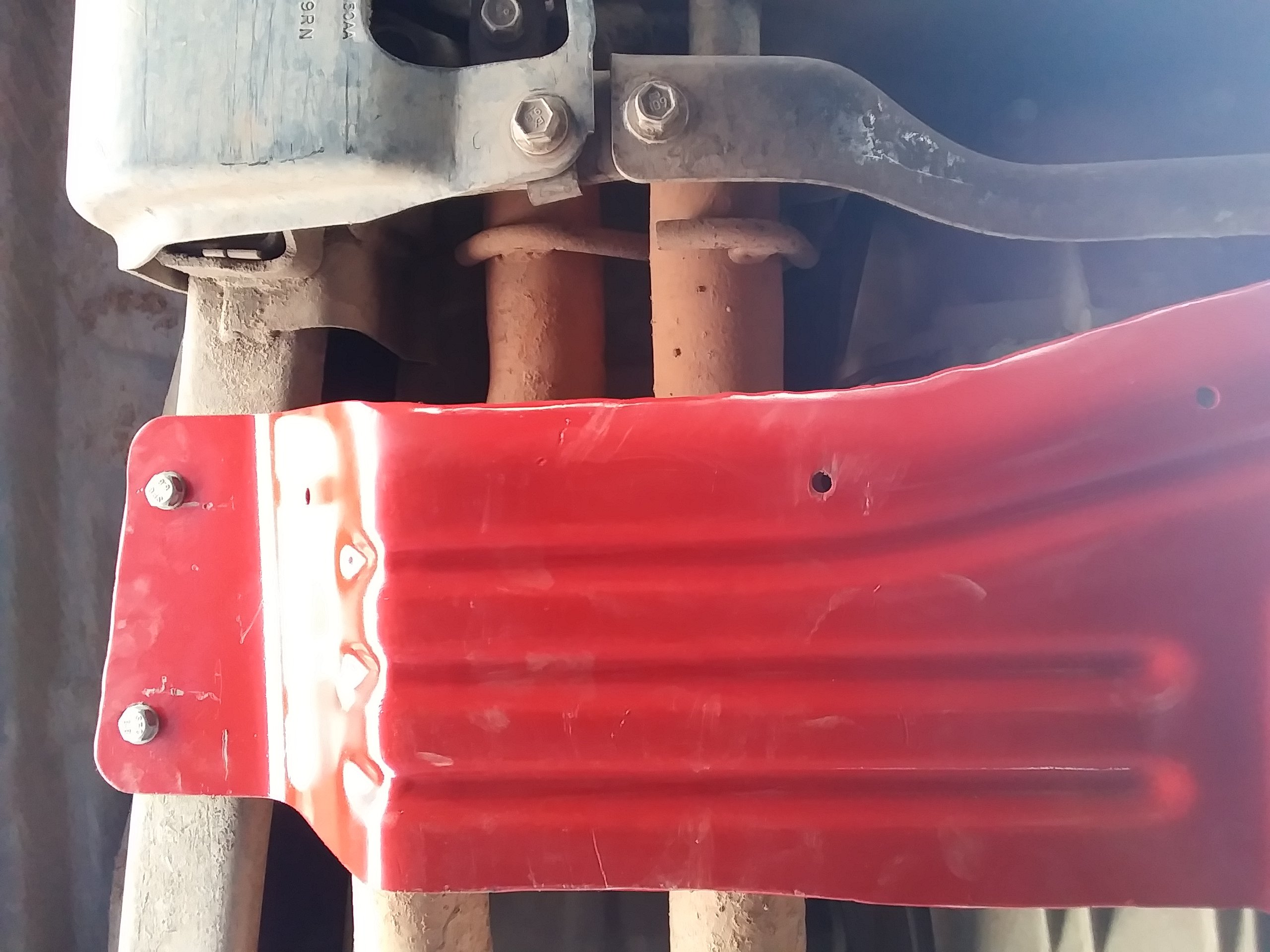

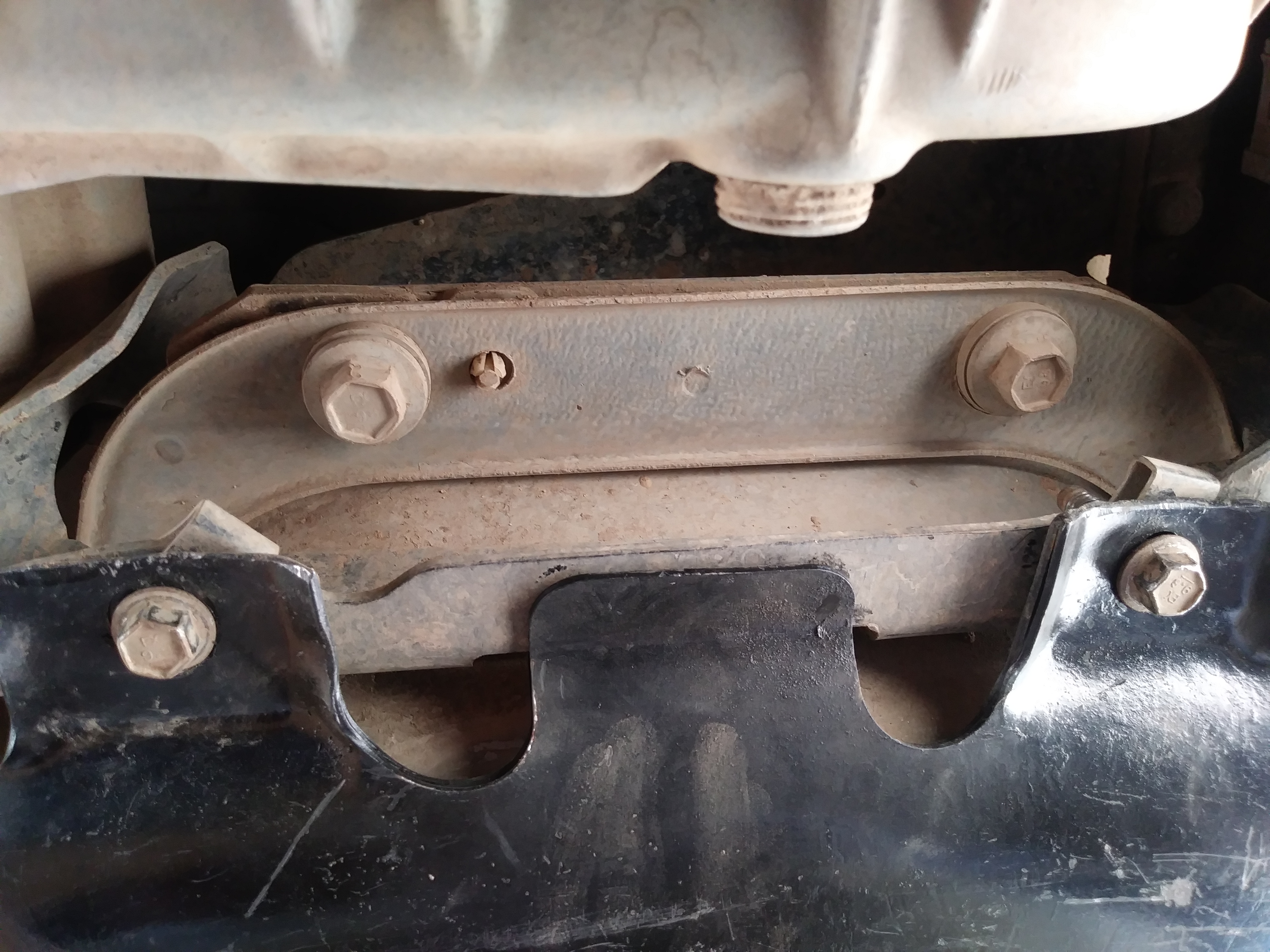

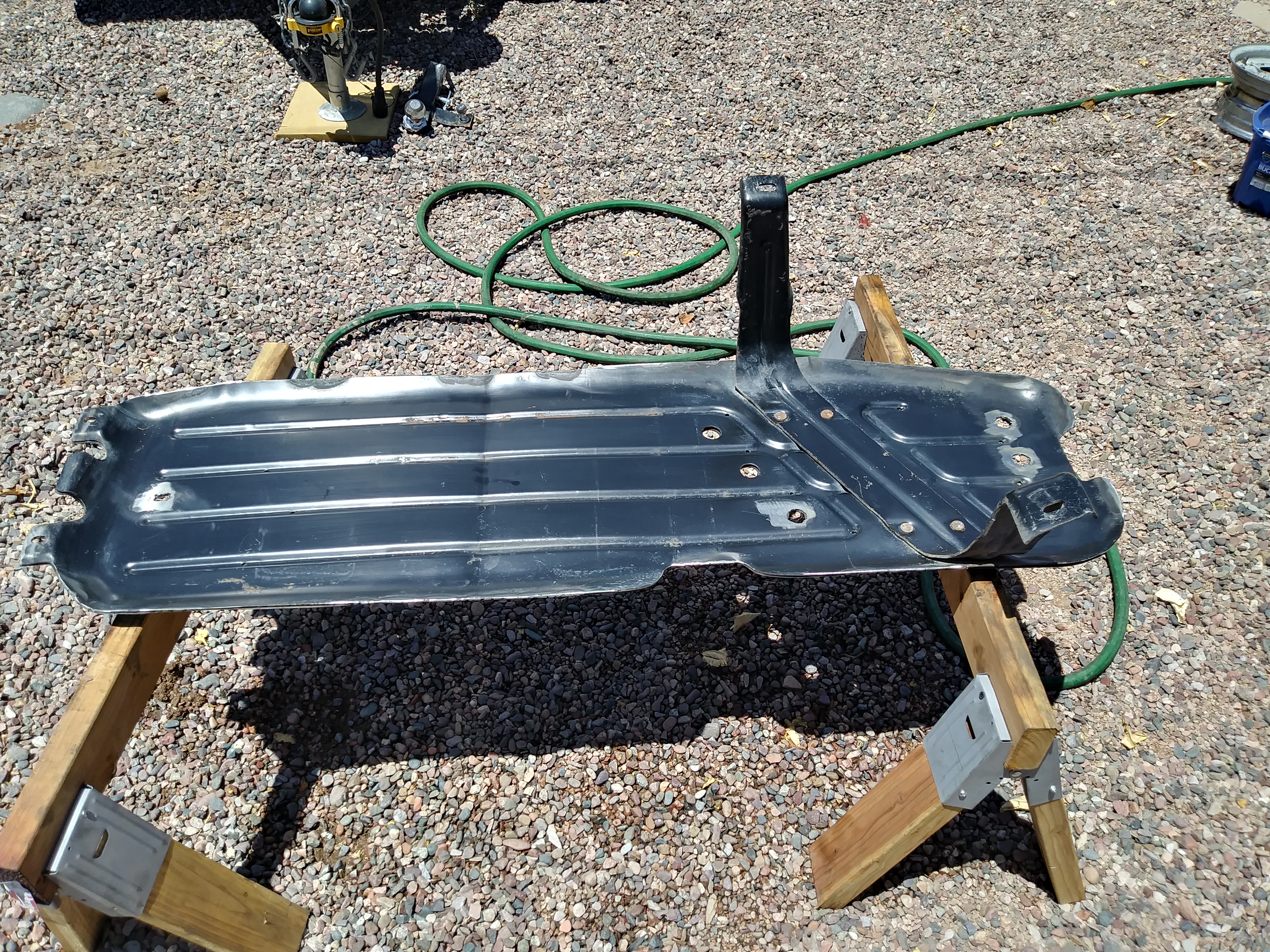

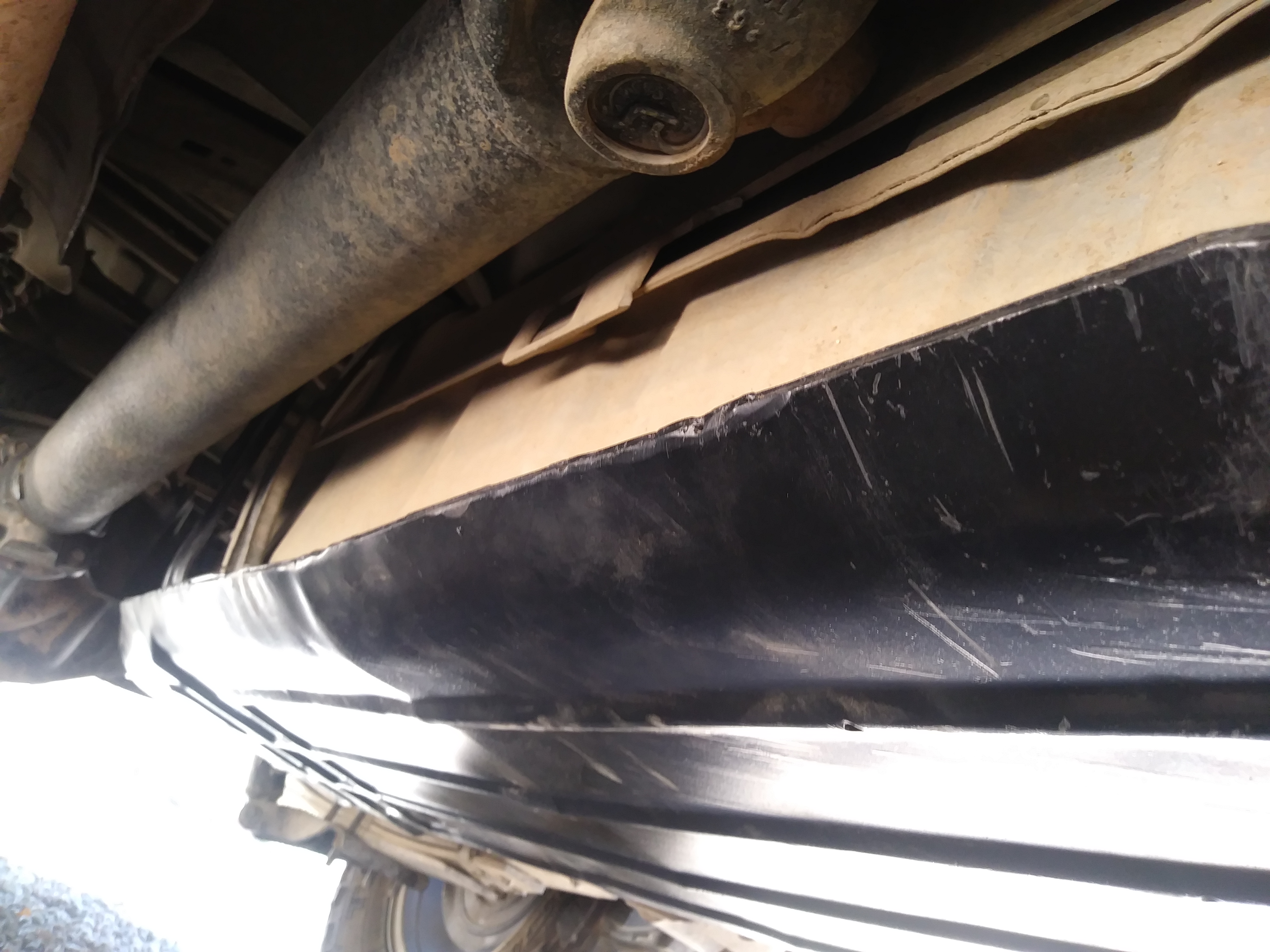

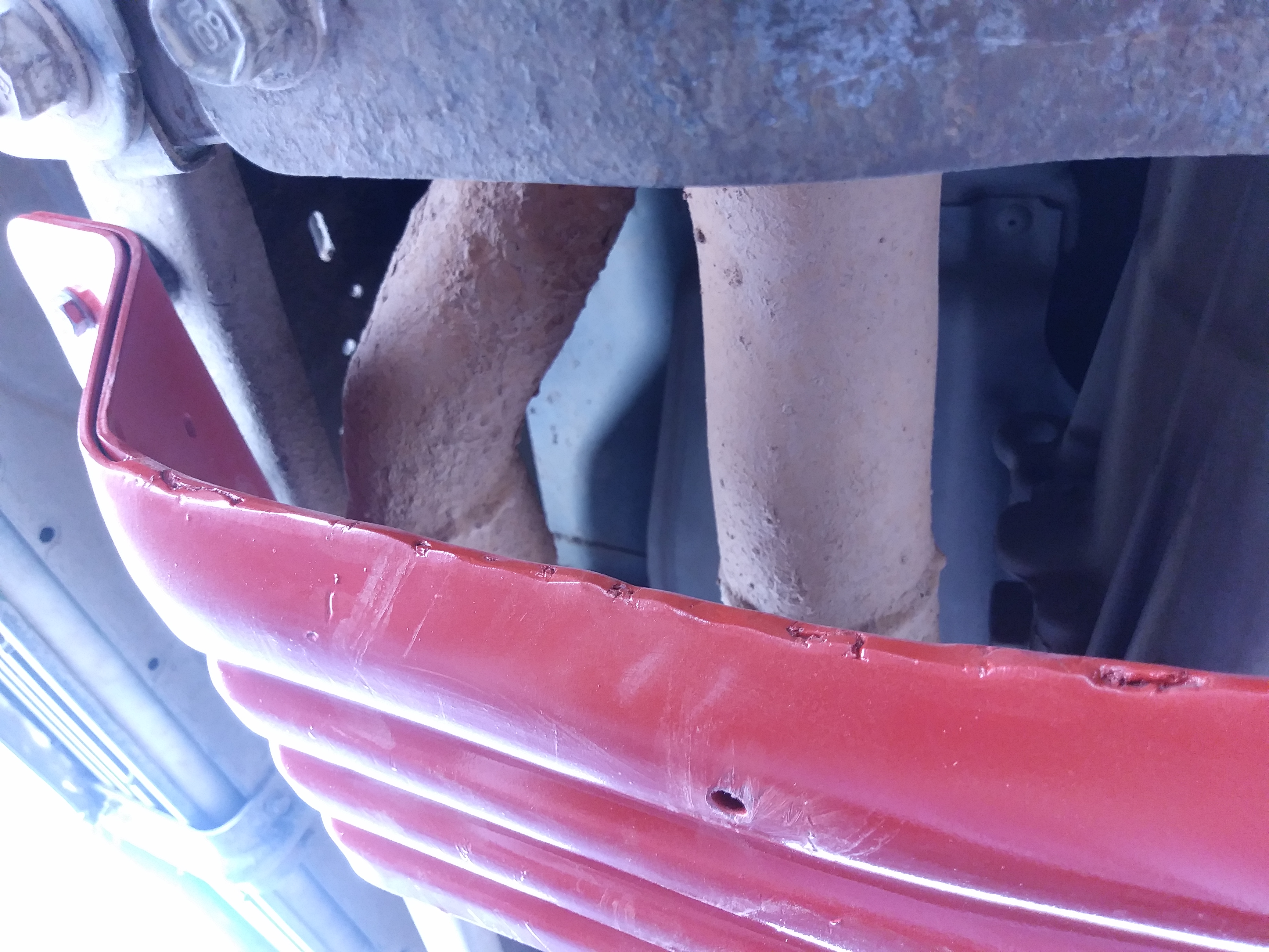

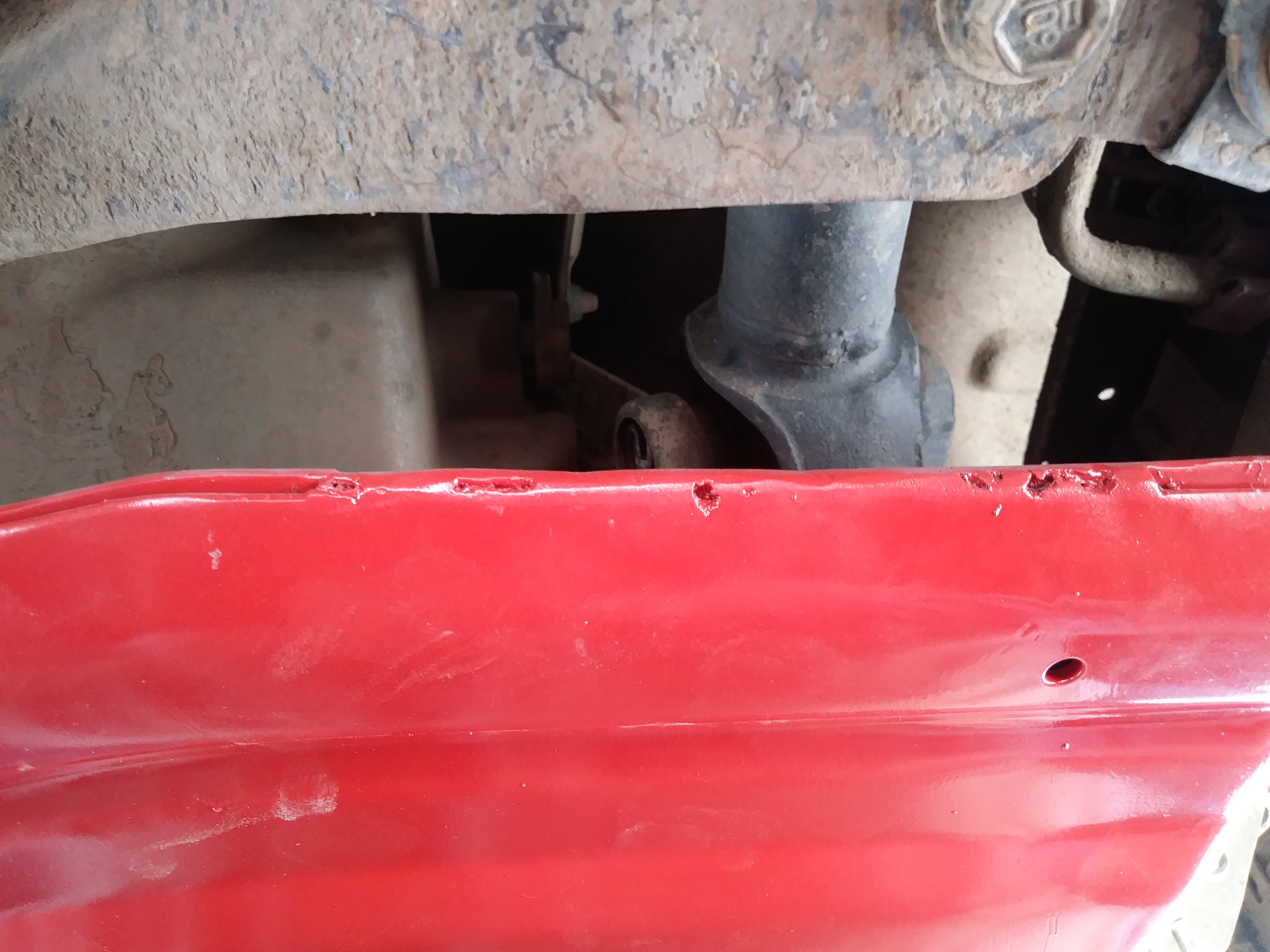

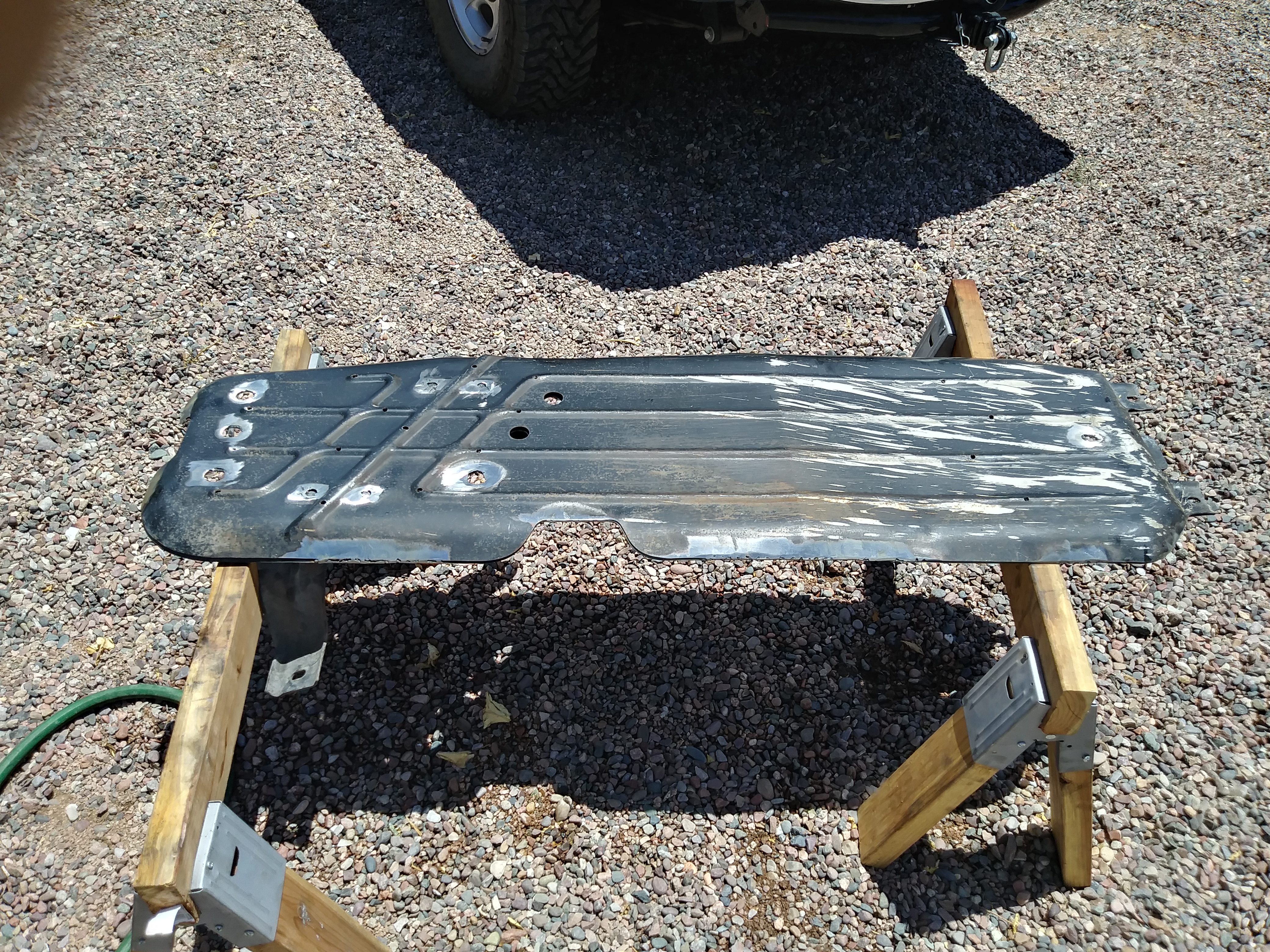

I finished painting and mounting revamped Tcase and gas tank skid plates. I welded two of each kind of skid plate together to make one of each. Basically stacking 2 gas tank plates together and w Tcase plates together to form stronger plates.
I used up all my black paint on the gas tank skid, that is why the Tcase skid is bright red engine enamel paint.
If you wish, you may critique the welds, just don't condemn the welds. This is my first (and I mean FIRST!) time welding (wire feed welder), no classes, no hands on instruction, just youtube, and the advice of helpful friends.
They all look very good. Painting over the welds is a good idea LOL. I had forgotten the BW4406 is lower than the skid plate on the left side. That looks great with a gloss finish too.
