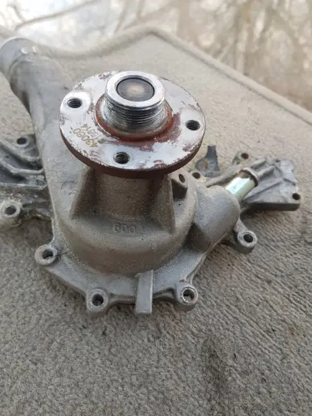

I went to O'Rileys today to get a new water pump they gave me one that they said would fit my 1996 Ford explorer XLT 4 door 4.0 after installing the new pump I noticed the clutch fan won't screw on to the new one is there anything I can do? Is there a flex fan I can buy for the new pump? Or what fan came with this water pump please help thank you
Attached pics are the old and the new water pump
remove the plastic thread protector sleeve.
Wow I feel like a complete ****ing idiot thank you! Normal I'm used to a cap not a washer like that thanks!

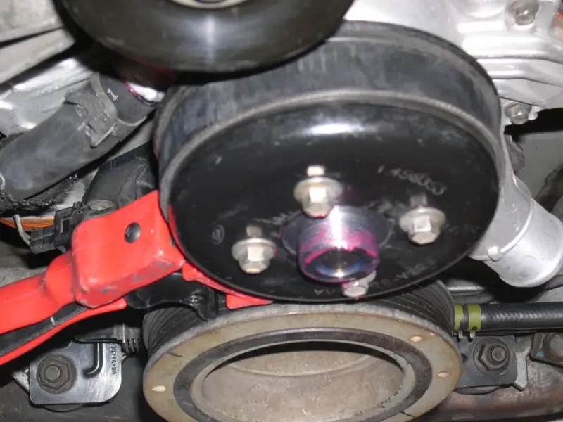

One last tip.
In order to SECURELY tighten your fan to your water pump when the water pump mounted to the engine, you'll have to do one of the following.
You can place a large rubber strap wrench around your water pump pulley, let it lock up against something on the engine, and then tighten large fan nut.
If you don't have a strap wrench, you will need to get a long screwdriver, at least a foot long, and place it fully across and under two of the water pump bolts, let the screwdriver lock up against something on the engine, and then proceed to turn the large fan nut.
As you stand in front of your Ex, the fan nut is "righty tighty" :cool:

Now this bad boy has gotten me out of countless jams with oil filters, water pump pulleys and power steering pulleys - I have (3) of them ;)
I've never found better built than this - fiberglass reinforced plastic handle and kevlar reinforced braided extra wide rubber belt.
Currently being sold for $16.72 on Amazon under the name/model: Superior Tool 3613 Strap Wrench, 6"
Link: Superior Tool 3613 Strap Wrench, 6" - - Amazon.com
Formerly sold as: Empire Level 28620 Strap Wrench

Put the serpentine belt back on and apply tension to the tensioner with a 3/8" breaker bar. You can tighten the clutch fan down with a 36mm wrench.
