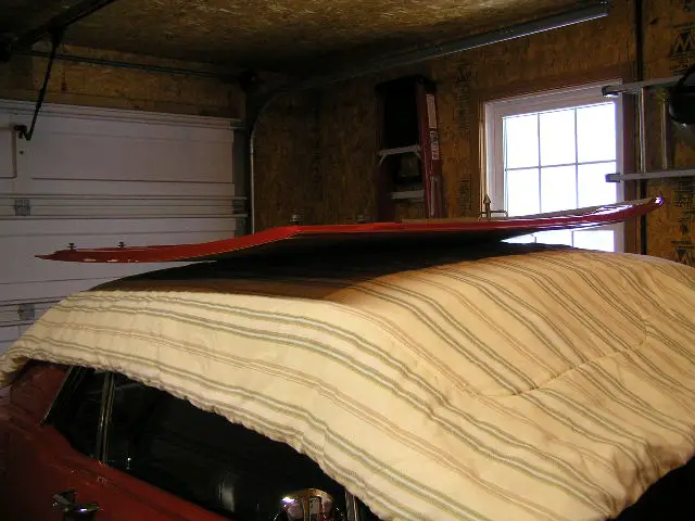

Parking spot for the hood:

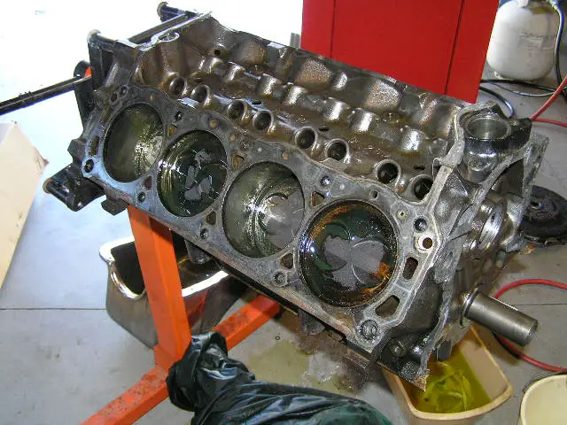

Tore down the old motor:
I oiled up the short block to put it in storage so it wouldn't get rusty. I will deal with it later.

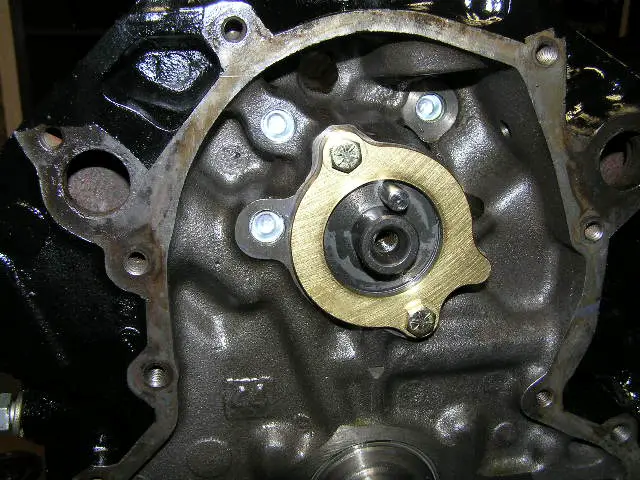

Cam retainer? What cam retainer?
Ah, there's the rest of the cam retainer..in the bottom of the pan...:rolleyes:

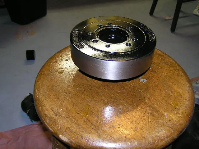

Balancer cleaned and painted:

Camshaft and camshaft retainer installed. Hole in the camshaft retainer is just a little smaller than the one in post #24.:rolleyes:

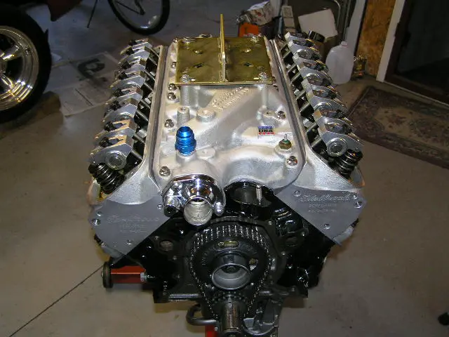

Installed the intake manifold and oil pump.

More progress:

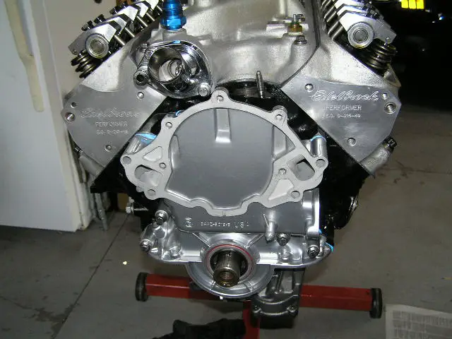

Finally received my pan an installed it. Now waiting on equalizer bar parts to put the motor in the car.

More minor progress...balancer installed. I'm still waiting for my equalizer bar to arrive..
