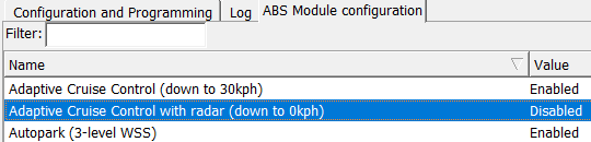

Does anyone know if you can enable the adaptive cruise control with radar to 0kph in the ABS module? I see the option, but I don't want to try it unless the 2018 supports this mode. I thought all adaptive cruise control used radar.
Does anyone know if you can enable the adaptive cruise control with radar to 0kph in the ABS module? I see the option, but I don't want to try it unless the 2018 supports this mode. I thought all adaptive cruise control used radar.View attachment 315715
No, it requires additional programming on the body control module and a different camera that also includes a laser for low speed operation.
Thanks for that answer PlatinumOwner. I was preparing a reply when you posted. I was wondering if the ABS had anything to do with this other than braking. The BCM seems to be more logical as the controlling factor. Also, was curious as to why the speed is shown in kps and not mph and if the vehicle's units would have had to have been changed to metric for it to work?

The metric display is just how the settings are read in FORScan and not a reflection on the actual programming of the vehicle.
I realized a couple more things would also be need for adaptive cruise to 0. A new SCCM(Steering column control module) and steering wheel with Resume button functionality would be needed as well.
You can enable it but it is not going to work anyway.
In order to make it work you need to take all the parts from any totalled vehicle with Stop and Go option (Fusion for example). Still, will be hard to implement, because you have to know what you are doing.
