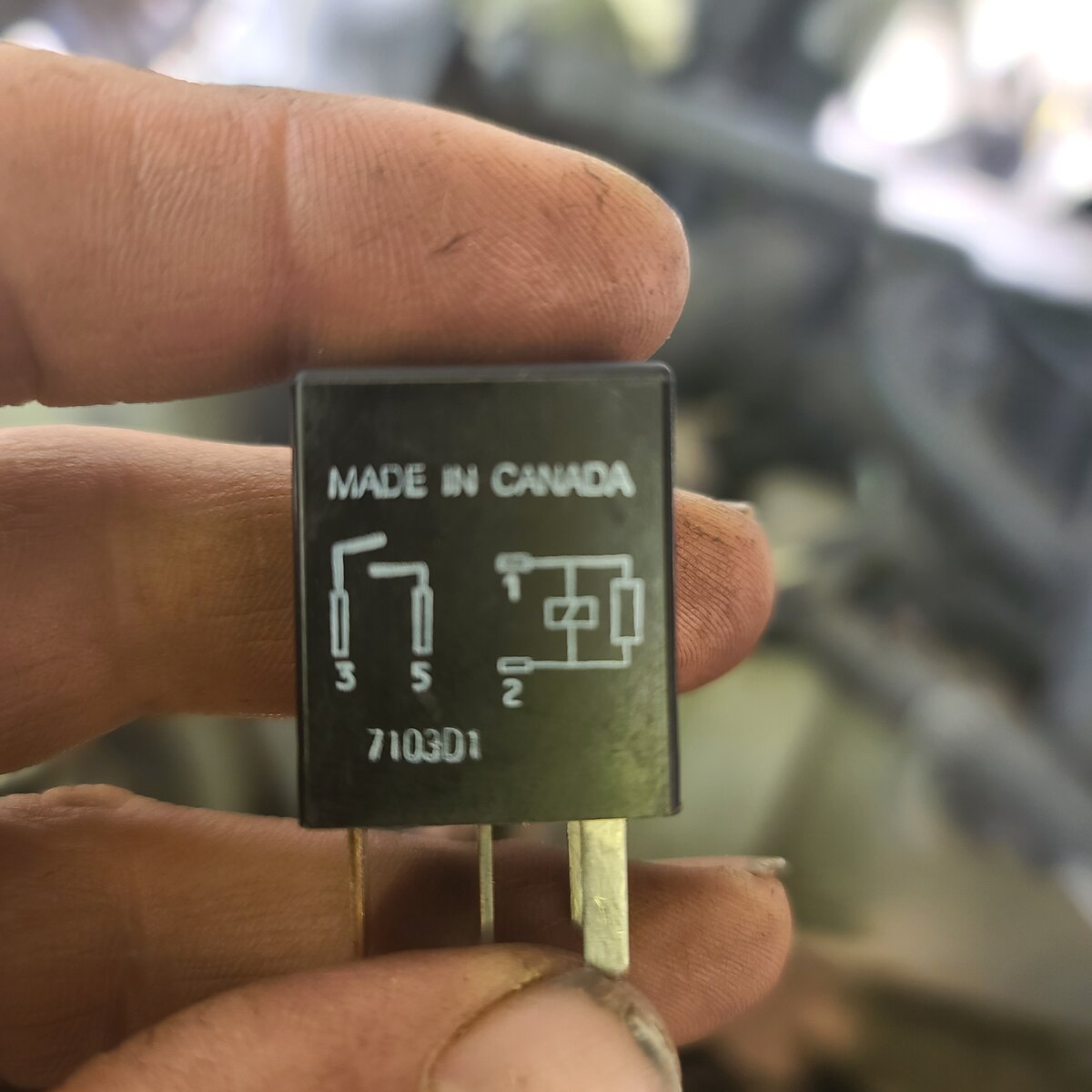

Pin 3 is getting over 12v. When I jump 3 to 5 the engine cranks and starts. I've tried 5 relays and I've tested this last one on the wipers and it works. When the key is in the cranking position pins 1 to 2 only get 10vs as where the 1 to 2 pins on the wipers and fog light relays get 12v.
I feel as though I'm not getting enough volts to pins 1 and 2 to actuate the relay to join 3 and 5 together.
Why am I getting low volts. What do it check next. A wiring diagram would help.
