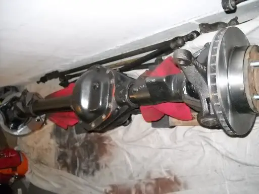

Ok, time for parts ordering. Just hunted down the last junkyard part, and now its time for fun. Front axle is torn down, and in REALLY good shape. Damn those slide pins though. I'll post up a few pics when christmas in May arrives.
Updated first post parts list.

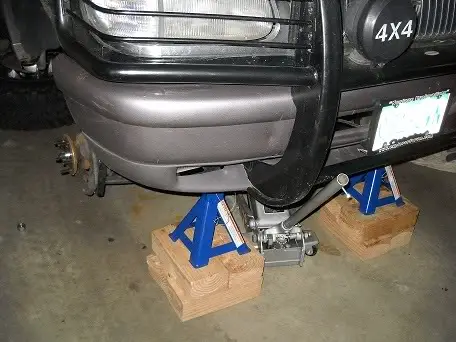

And here we go. Locked and loaded
not shabby for an hour. I deserve at least a 15 minute small space handicap lol
Should have everything out by thursday. Any tips on how to set up the coil buckets? As much drilling as I have ahead, I'm all for doing things once
