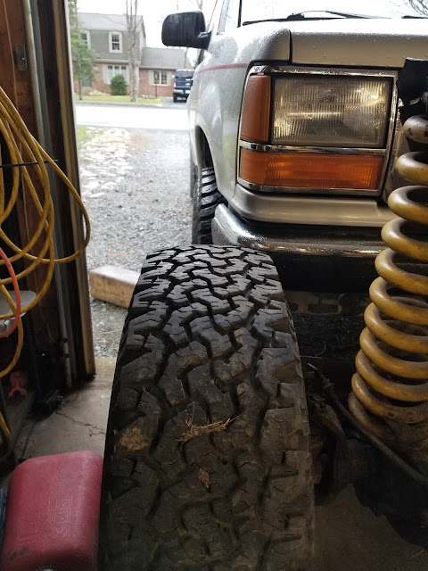

I've decided to not put a ton of money into the TTB and do a solid axle swap. I bought a set of '197x' F150 axles - High Pinion open knuckle Dana 44 and Ford 9 inch with 4.56 gears. '197x' because the rear end is stamped 73, and it has drums up front so it could be a 73..who knows.
I've previously done this same swap on a 2002 Xterra with an 8.8 and a '79 HP Dana 44, so I'm armed with some lessons learned from that project. Namely, the upper coils towers were too far inbound, so the coils had a slight angle, which ended up pushing the radius arms off the axle mounts due to sideways stress.

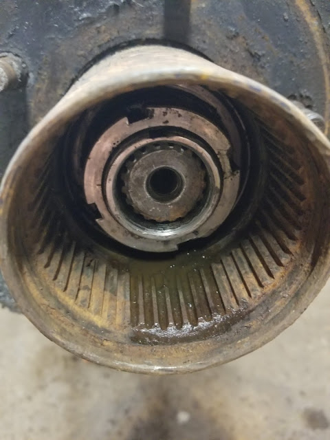

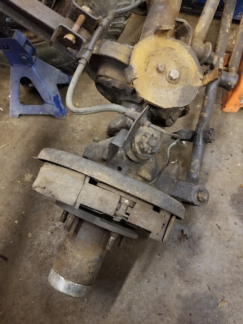

Started to tear into the front hubs ready to swap the spindles out for disks and to remove the broken axle shafts.
These hubs have different parts to the '79 axle.
Think I'm gonna need a lower coil mount too.
