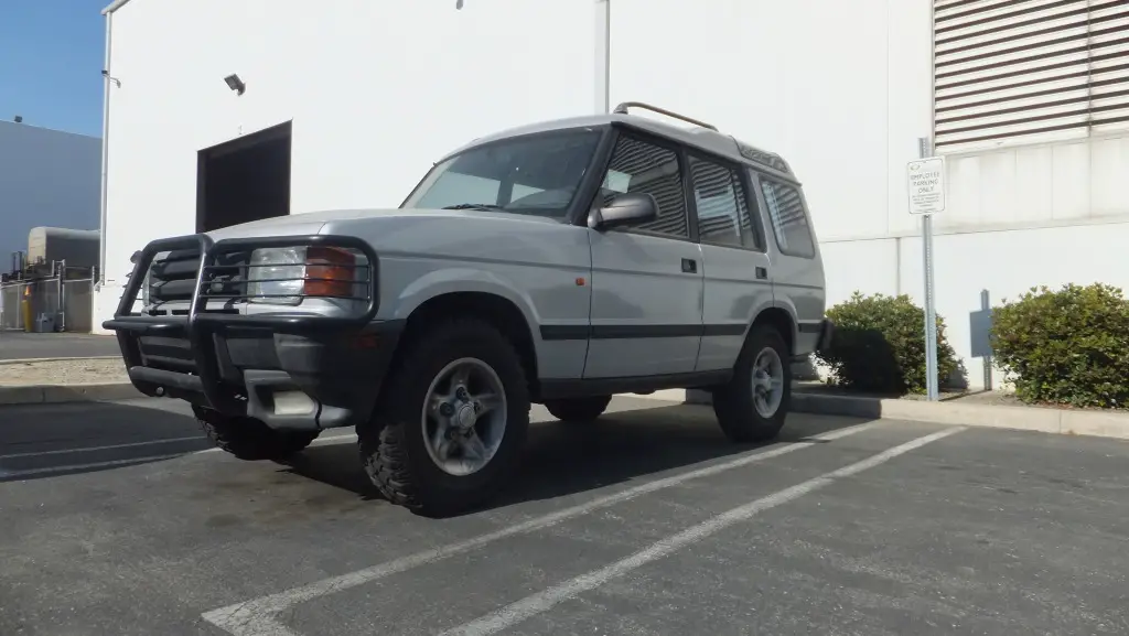

In other news, I plan on replacing my trans myself very soon. Will keep you posted on that and will most likely have tons of questions once started. As if that wasn't enough of a challenge, I picked up a new toy...don't hate haha
There's no reason to hate...that was built before they ruined the company lol.
I'm sure that thing has never been back to a mechanic since it was built...unlike the new ones :D
Ocean Pacific said:
Sorry I'm a little late to this conversation but you should be fine with those rims. Our lug nuts are tapered so they center it nicely.
No hate from me. I almost bought the same thing about a year ago.
