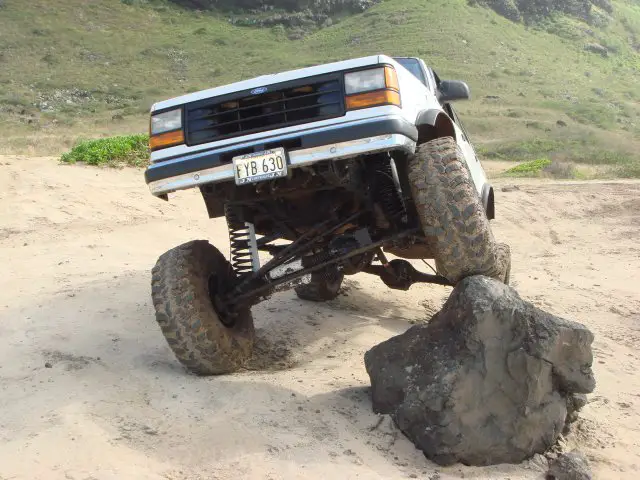

I think these arms gives me the flex I need and want. I like them a lot. I didn't go through your entire sas build up but from the first page, it seems like you were thinking about going with the james duffs arms. these arms are quite similar, and i think they were made by the same guy.

do you have a pic of you coils compressed all the way. I need a second look at someone else's coil. Mine still has gaps and does not compress all the way when that wheel is flexed up. I think my steering is hanging it but have not had the time to check it.

I got some pics of my coils compressed when I took it to the forklift. But that was the very first time I really flexed out the suspension after the swap out. There were gaps in between too. I noticed after I took it off roading that the suspension seemed a lot more softer (then initially) on road. I then drove it up the ramp and got higher then when I first flexed it out on the forklift. So I believe that the coils are probably more compressed then then first time I flexed it out.

When you get a chance put one up for me. I think because i mounted my coil buckets so low the coils will not allow the suspension to move up anymore.

Compressed Wild Horse Coils
Sorry it took so long, but I thought I had a good pic of the coils compressed, come to find out, it wasn't a clear shot of the coils. But I just went wheeling today and got this pic.
Hopefully this helps!!!!

Burns did you see this pic I posted of the coils

Can you take pictures of how you mounted your track bar, coils,and last but not least your modified cage radius arms.

Heres some of posing rock shots:
