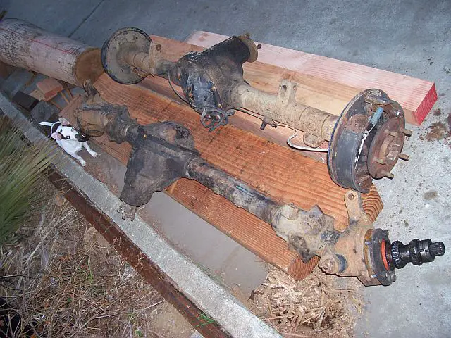

I have taken possession of a HP D44 out of a 79 F150, and an 8.8 out of a 91 F150, in a deal I could not pass up from 90ranajo. :salute:
Don't know when I'll actually start the procedure, it may be a few months, but when I do, it will be a very basic, verrryyy bargain basement type of build. The front will be your basic radius arm, coil spring setup, and the rear will be my current leafs bolted to the new 8.8. I will aim for max flex from this setup, and probably modify/improve on it slowly over time, as funds permit. ;)
Her is some photographic proof. D44 is complete, but partially disassembled.
(chihuahua for scale :p:)

About time you get rid of that radius arm I welded up for you. Just remember get the deepest gears you can get. If you want to do your own gears I have all the stuff to set the gears up as well. Also put that doubler in at the same time. You are missing out a new world of wheeling without having that in.

Congrats :D Let the fun begin!
BTW that dog looks awesome :D Just hiding behind there

You have an explorer 8.8 right? If so pull the gears and locker and toss them in the full width housing. Grab a gear set for the front and you are set.

I'm leaning towards 4.88 since I'll have the doubler, so I won't pull the gears from the current 8.8. I will be taking the killer diff cover, though. :cool:

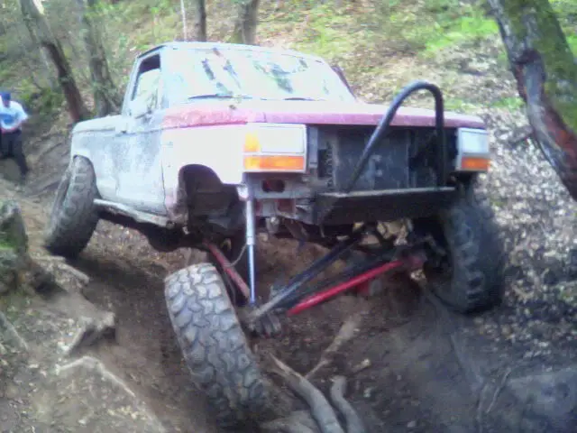

Non wristed Extended RA's will give you more then enough flex. This is White Rhinos truck from pirate. He runs air shocks.
You would be hard pressed to find a set of coils that can match the flex this setup gives.
Id take a look at FOA Coilovers. F-O-A.com They are an inexpensive coilover. You can get their basic 2.5 coilover with dual rate kit (14" travel shock) for 210 each. Theres a Used Coilover Coil thread on pirate, so you dont have to buy new coils either. Coilovers or air shocks would allow you to take full use of the flex you could get.
redranger4.0
April 8, 2003
735
Salem CT
2000 Ranger XLT
Good action picture.
This is a good picture that shows just how long his RA's are. That arm isnt bend either, since the stock arms top and bottom angle down to the end he used the lower part of the arm as the "straight" part so the tube follows the line of the bottom of the arm, which makes the top part seem bent. He ground down the stock arm and sleeved it. Me personally I would add some gussets to it, but it has been holding up fine.
Edit: The joints are johnny joints.
