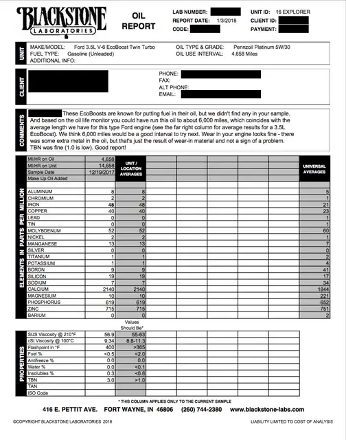

I just got my first oil analysis from Blackstone after about 5,000 mi with Pennzoil Platinum Full Synthetic. The Explorer was driven hard so the iOLM was down to about 20%.
Even with a good full synthetic oil, most oil changes run me $20-30 depending on sales or deals on oil/filters. I typically follow the OLM, but I also track my changes and try to schedule them somewhat because I live in MI and don't like to do oil changes in the middle of winter when its freezing cold. I change my oil when it's convenient, so I may change a little early to get an oil change in before winter. I may also change a bit early during the winter if we get an unusual warm trend. I'm not interesting in stretching every last bit of life out of the oil. If oil changes ever increase in price to $100 or $200+, or DIY oil changes are outlawed, I may rethink things and try to take advantage of the full oil life.
I have one GM vehicle currently and the OLM is triggering oil change at about 3,500-4K miles. On my MBs, I used to change at 8-10K. On my other Fords, I typically shoot for every 5K when I do tire rotations, just to consolidate tasks.
This is the information we need to help determine if the iOLM’s are accurate or not. Thanks for the post.
